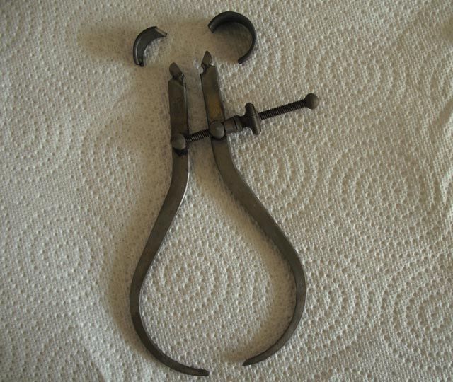

          Started cleaning some calipers and dividers I've had for years. Dunked them briefly in B&Q brick cleaner to remove traces of rust and other crap. All went well until these outside calipers were done. They had been soaking for about five minutes when PING ! The spring cracked across the top. Has anyone any theories why this happened?calipers.jpg

            Posted by Anthony Knights on 02/04/2019 09:49:21:
            Brick cleaner contains hydrochloric acid. The acid will preferentially attack grain boundaries and/or pre-existing cracks. Once the acid starts to eat away material it creates a stress raiser; result is PING.

                Could be hydrogen embrittlement, higher strength/hardness materials are more susceptible. I'm not an expert but basically the material absorbs hydrogen atoms which results in material becoming very susceptible to brittle failure and unable to sustain it's normal/design loads.
                It can be cured buy heating the component over several hours at something like 200 deg but must be done very soon after the hydrogen embrittlement occurs, If not done in time then the heat treatment is not effective.
                It's normal practice for High tensile components to have hydrogen enbrittlement prevention heat treatment done after various plating processes etc were the material may have absorbed hydrogen atoms.

                  Could be, but I think Andrew's suggestion is more probable. I have a set of B&Q dividers and whilst they work they can't be described as high-quality. Not unlikely that the bow-spring was flawed from new or that it was damaged in use causing the force exerted by the spring to concentrate on a crack. Very likely the acid was the last straw: it opened the crack enough for it to propagate, and the spring destroyed itself by lever action.
                  Somewhere I've an interesting graph comparing the tensile strength of steel rods identical apart from finish. From memory a polished rod is about 10% stronger than an unfinished rod, and a super-fine rod is about 10% stronger again. The reason is that tiny surface imperfections can concentrate stress severely at a point, enough to cause local tearing, which further concentrates the stress. Obvious that cutting a sharp notch in a rod will weaken it, not so obvious that polishing improves them.
                  Polishing to increase strength isn't that common. I think because it's usually cheaper to use a bigger rod than to polish small ones that might get scratched.

                    Another thing with high carbon steel, don't use the electrolitic method of derusting , you get the same result as the hydrochloric acid.

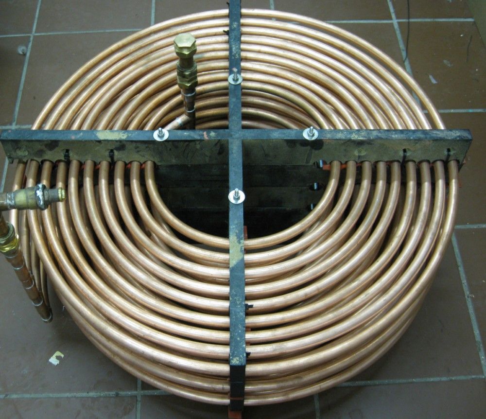

                            Spent today ( and the last 14 days..) repairing my Solar heating system…
                            Input heat exchanger
                            Output heat exchanger
                            I have evacuated glass tube water heaters on the house roof, heating via a copper pipe heat exchanger the water in a 45000 litre underground storage tank. That thermal store in turn heats the water that is pumped through underfloor piping in the house flooring. This takes place by means of yet another heat exchanger in the floor heating loop. The water in the tank is isolated from both the solar heaters and the floor heating system.
                            The heat exchangers are four spirals of soft drawn copper tubing, 20mm OD , 0.9mm wall, wound in a spiral and connected in parallel. Both exchangers were riddled with tiny pinholes and so leaked. This after 11 years. The water in the tank reaches temperatures of 45 to 50 deg C max. The water PH has been between 6.9 and 7.3. Both copper coils are electrically isolated from the rest of the piping and systems – a heavy section of PEX oxygen barriered pipe connects each exchanger to the respective hot in and cold outlets, so no electrolytic action. The tank is a 8mm wall thickness Roto-Molded Polyprop unit, wrapped with wooden slats ( like a wine barrel) to keep it in shape when full of hot water. It is fine, but the copper piping .. The internals of the copper pipe is in good nick – the walls are evenly coated with a very fine brown/red cuprous oxide and no sign of corrosion or green anywhere within.
                            So, drain the tank, hauls out the old piping, get new pipes from SA, wind the spirals, fit connections, do the pressure tests, wash out all flux, and down the hole it all goes tomorrow!
                            Next Time I will get rid of half the problem and move to PV panels heating the thermal store with heating elements!
                            Heavy work..Each exchanger weighs around 45kg..

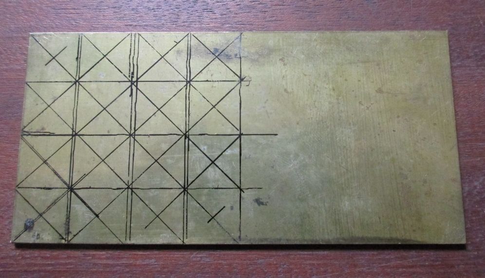

                              Hi, today I did a bit of a kiddies job by making 16 2BA X 1/2" (12.5mm) O/D brass washers from 1.5mm thick sheet brass. Firsly I marked them out with a fine ink pen.

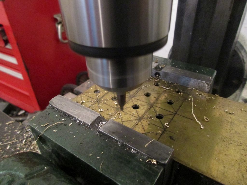

                              Then using my mini mill and the DRO's, I piloted them with a centre drill and drilled them 4.9mm, in batches of four across.

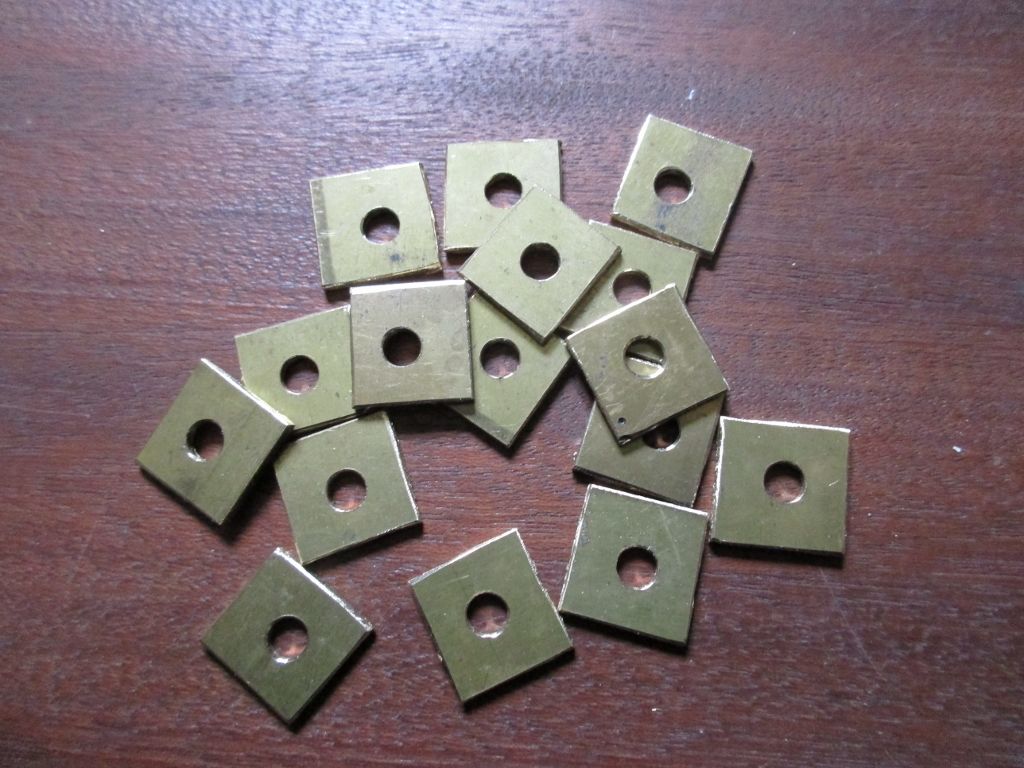

                              Then separated them all by hacksawing and deburred the holes and cut edges on both sides.

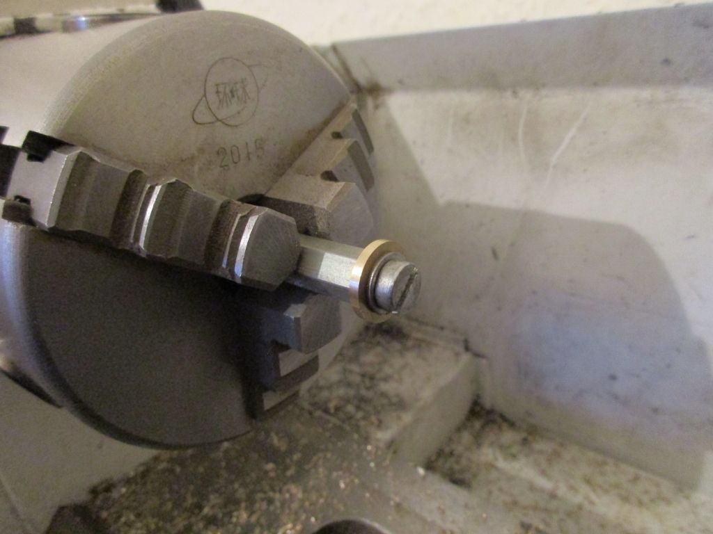

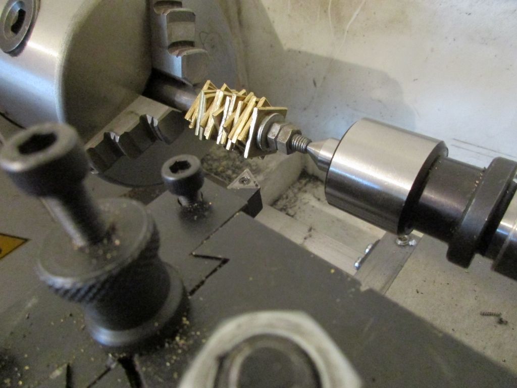

                              I then turned down a piece of 12mm O/D bright mild steel for about 40mm long to fit the holes snugly and threaded it 5mm long enough to clamp all the washers tightly together and turned them to size.
                              Each one then had the corners broke using a small file while holding them in the lathe with a bit of threaded hex and screw which I found in my box of rescued screws.

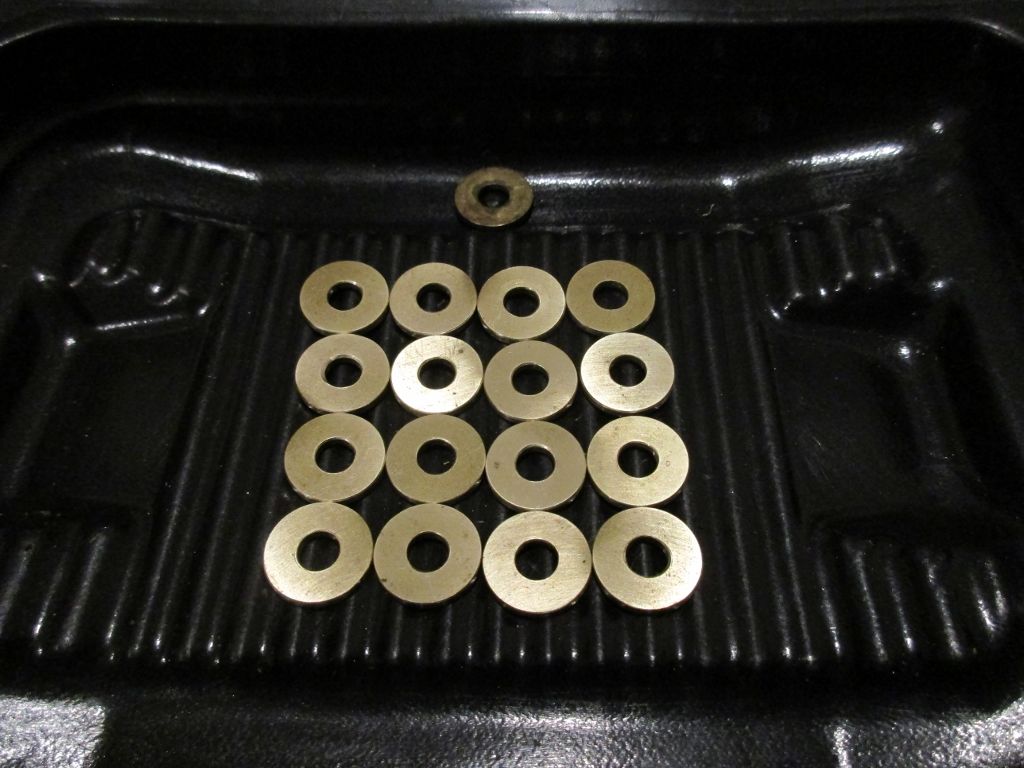

                              16 finished brass washers, the odd one at the top is the commercially made one that I used as a pattern.

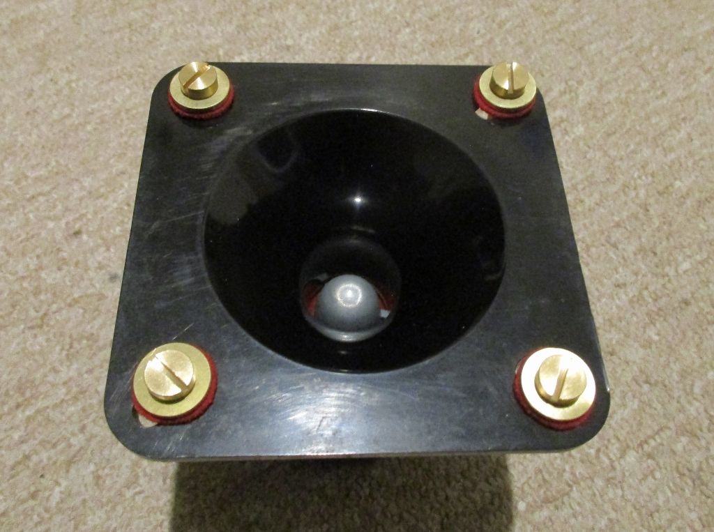

                              This is what they have been made for. They look quite dashing with my new brass cheese head screws, which arrived in the post this morning. The red felts came off old piano keys, which act as a buffer between the washers and the plastic tweeter.

                                They look good, Nick!
