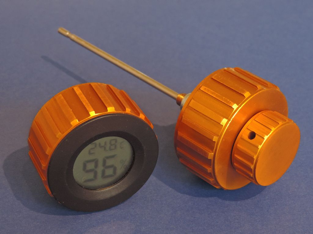

                      This looks bit better. Three knobs for my telescope.
                      I did them together and one turned out pale (I don't think it had a very good connection with the titanium wire). It gopt close to the other two after an extra half hour in the die but I could see it wasn't ever going to match so I stripped it with caustic and reanodised it. In warm water these take about 20 -30 minutes to achieve full colour.
                      I'm guessing the conventional black die will take quicker.

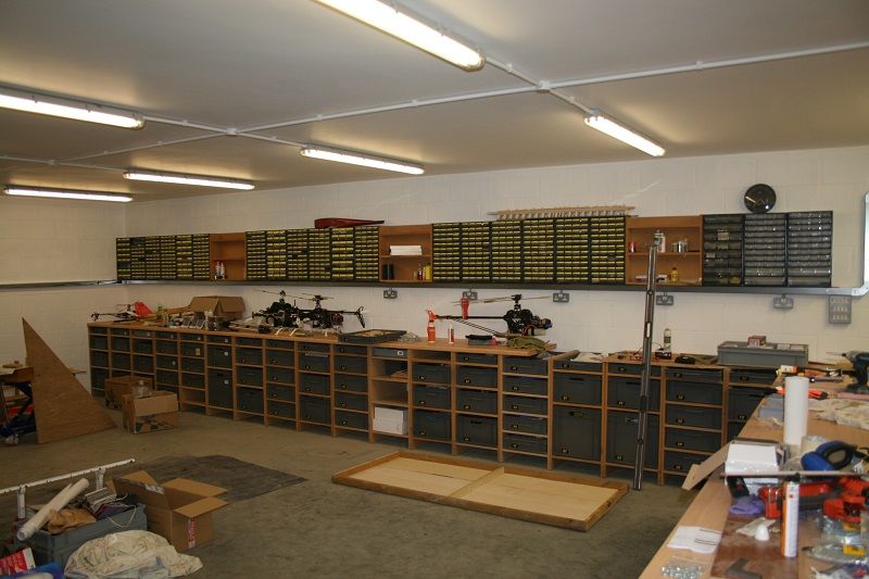

                          In an attempt to try and find things when I need them, my "system" is to have various heights of 600×400 plastic trays positioned in modules with the locations shown in a database on the PC.

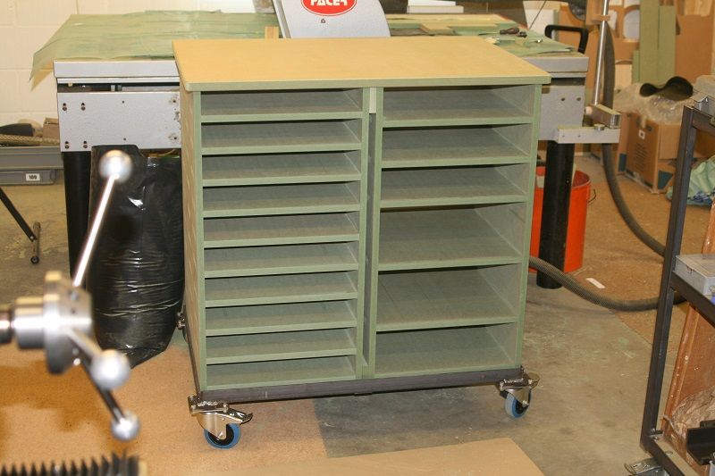

                          A requirement for a mobile module had arisen and it was completed today.
                          These are my original static modules made for the old workshop

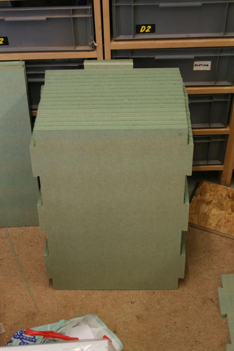

                          First side
                          Assembled unit. All fitted together with just a rubber mallet.

                            Neil those telescope knobs look superb!

                                Very nice Mick.
                                Well, thank you but they seem very limited things compared with some of the stuff you and others do. You seem to've put in a temp/humidity gauge with one of your control knobs – I take it that's to help control dew condensation on your mirrors or lenses?
                                #370494
                                  Posted by Mick B1 on 04/09/2018 22:08:16:
                                  Nowt wrong with your work at all!
                                  Williams Optics (makers of posh telescopes) put a thermometer on the one-speed knob of some of their scopes. Personally I think humidity would be more useful. I googled for a round humidity meter and I found these cheap clip-in units for next to nothing.

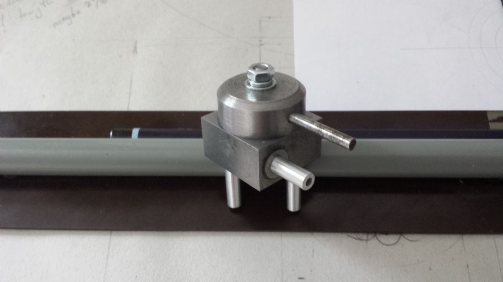

                                    20180905_143510.jpgCurrently making another Muncaster engine so I thought I would also make the simple reversing valve detailed in the 1912 book. Works well and will be incorporated into the new engine. Also gave me a chance to try out my "new toy".
                                    Many of you will recognise the small circular table, sold by RDG which was great for the semi circular curves in the valve head.
                                    Some feedback on the table. It's very small, 2 1/2" table diameter so only good for small scale modelling but is well made and I think good value.

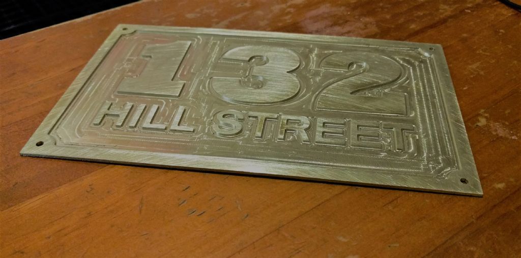

                                        I finally got this house number plaque done. I'd been poking at it in F360 for about a week and couldn't get the rest machining to cover everything. I found Cut2D did it with a lot less hassle, given this is what it is designed for. I still did a lot of manual jogging around on the machine with the cutter at full depth to clean up. I missed a few bits where I was too shy to manually move the cutter so close to some features, might get some riffler files to finish them up.
                                        The size is 200 x 125mm, using 8, 6, & 2mm cutters.
                                        Bad bowing on the stock might account for some of the roughness but a sea of paint should hide a lot of sins.
                                        Regards, David.
