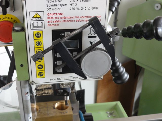

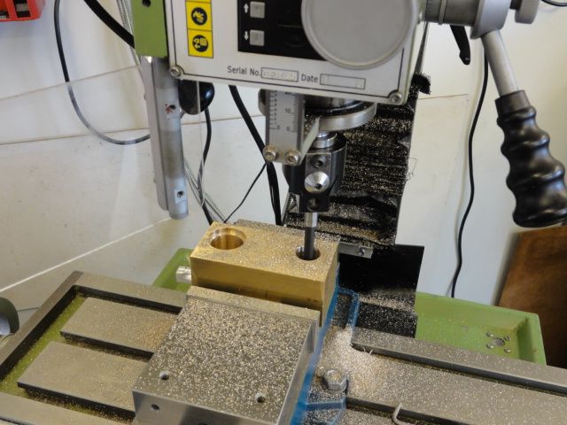

                Yesterday I was boring a couple of holes 45mm deep in brass.
                To get around the problem of my boring tool grabbing in the brass I elected to use the fine feed feature of my WM 16 mill, which is a wheel with a straight knurl. This worked well to give me a consistent smooth finish in the bore but my ancient arthritic hands were protesting a bit. To make life a little more comfortable I lashed up a toolmaker's clamp to give me something to get hold of.

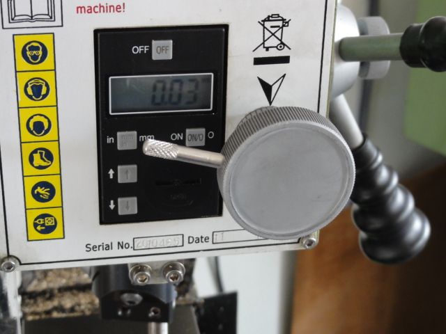

                Today I made a permanent solution in the form of a tommy bar
                to be screwed into the fine feed wheel, or not, as required and give a bit of leverage.
                Not an original idea I'm sure but a worthwhile way to spend half an hour.

                  May not be original idea Jim but a bloomin good one, think I'll do that

                    Well done Jim, nice easy solution.
