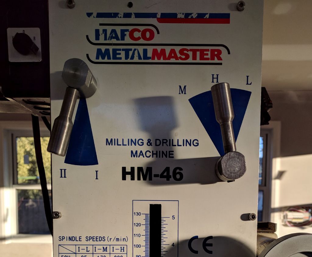

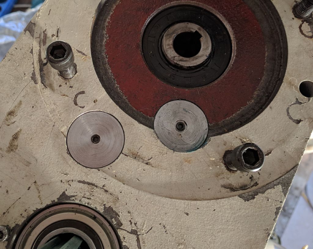

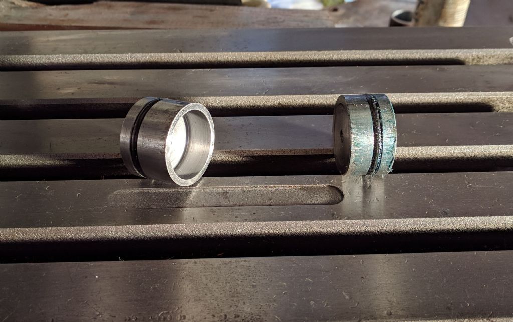

                          I made a couple of dust covers for the bearings on top of the milling machine head, and replacement gear selector handles. The originals got mangled from years of excess force getting unstuck from between gears when one of the gear clusters jammed on the key of its shaft.
                          I've also spent much time tuning the quill fine feed mechanism to get rid of tight spots. It remains a mystery to me how the fine feed works without the spacer I've had to add in front of the big worm wheel to stop it binding to the worm.
                          I've spent 1/2 the cost of a new machine fixing this one up, replacing a number of gears and most of the bearings. It's always been a real dog but it's getting better I hope.

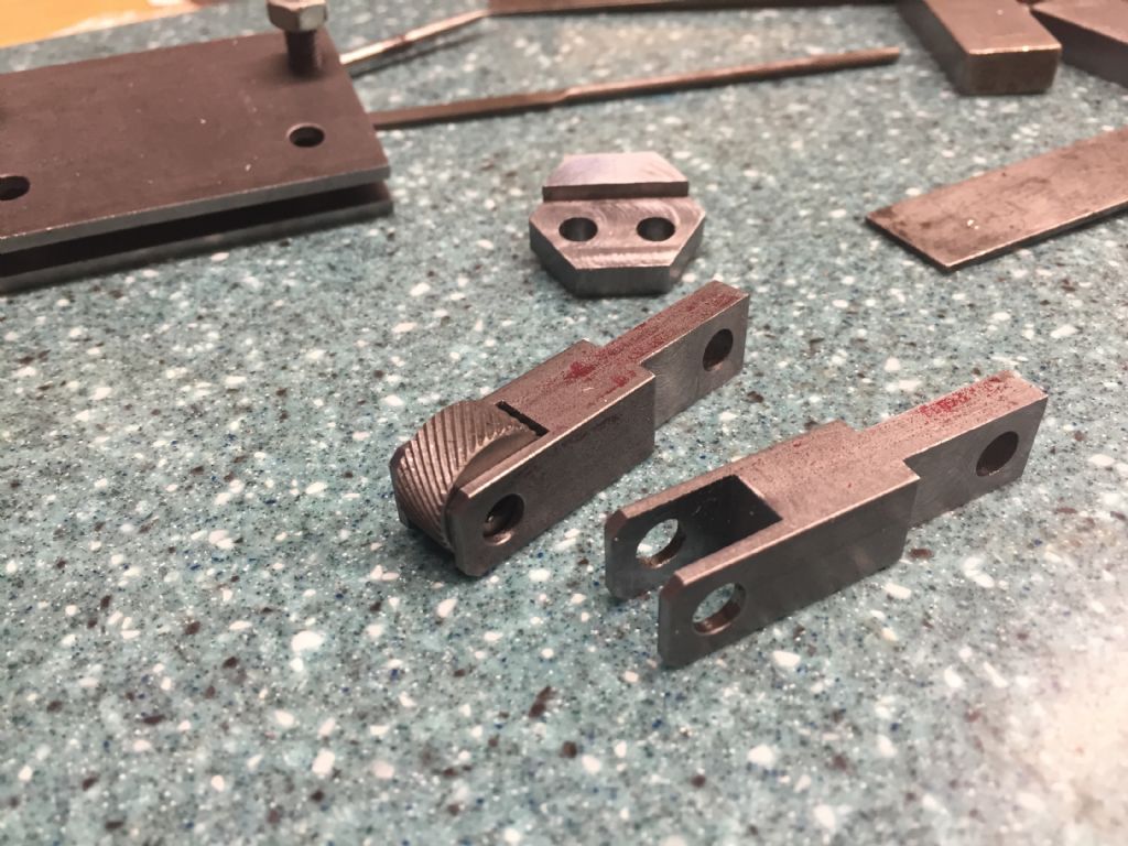

                                This evening I have milled the slots for the knurls in the arms of the knurling tool I am making. The hexagonal piece behind is part of the adjustment setup. Having drawn the basics full size on paper I am adjusting the design as I go. The knurl arms are the most complicated parts I have made on the Sieg SX2.7 mill. There are process' that I need more practice with but I am reasonably happy with what I have turned out so far I'm still deciding on what sort of axles I will put through the knurls but favouring a pin with a flat head on what will be the chuck side and a circlip at the other end.
                                #362904
                                Mark Rand
                                  @markrand96270
                                  Posted by Nige on 18/07/2018 21:27:41:
                                  Nice work! That sounds like an excelent design. Even more so if you are planning to have more than one set of knurls for different finishes.

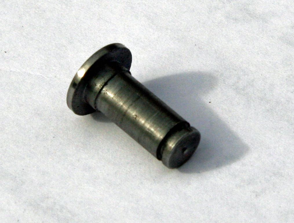

                                                  Today I have stretched my skills and ability on the lathe while making the first of two Clevis pins to fix the knurl into one of the arm. It is turned out of 10mm silver steel and has a thin flat head with a very small shoulder to locate the pin on one side and a groove for a circlip at the other end. Overall it is approx 14mm long.
                                                  I had to re-purpose an old HSS tool to make what is in effect a very thin parting off tool though I gave it some top rake as it wasn't going all the way through, only cutting the groove for a 6mm external circlip. The tip is about 1.25 mm wide
                                                  Very happy with the finished product as it represents the most complicated piece of turning I have done so far. I tried to turn to measurements but ended up 'creeping up' on final dimensions and trying the parts for fit which worked well for me.
                                                  Got the groove in the right place but need to adjust that tool height a smidge
                                                  I wanted this side as low profile as possible as it will be the chuck side of the tool.
                                                  I made the groove for the circlip just a little too deep!

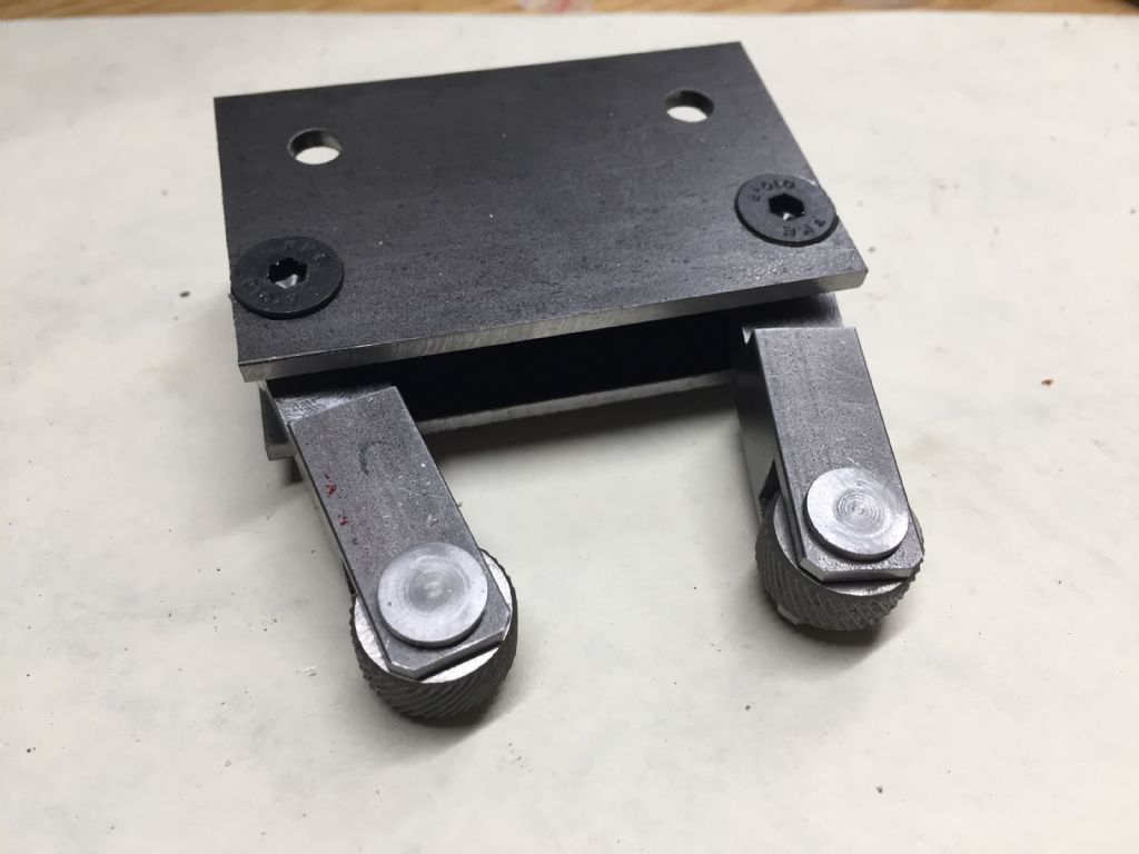

                                                    And the second pin made and arms fitted in position. Still some more work to do to fit the adjustment arms; holes to drill and some more milling to do.
                                                    #363771
                                                    Trevor Crossman 1
                                                      @trevorcrossman1
                                                      It looks good Nige. I think that we can all find the tiny flaws in our own work even when others cannot see them, but surely the most important thing to consider when we make our own pieces of tooling instead of reaching for the wallet to buy one, is, ……………will it do what I want it to do, and preferably better than a commercial item. ? So as long as the finished item works, and the circlip stays in place, that's okay!
                                                      Trevor.
