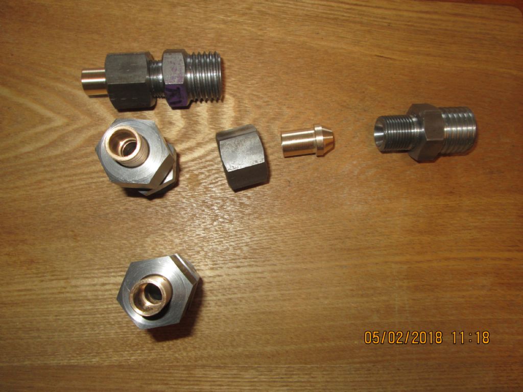

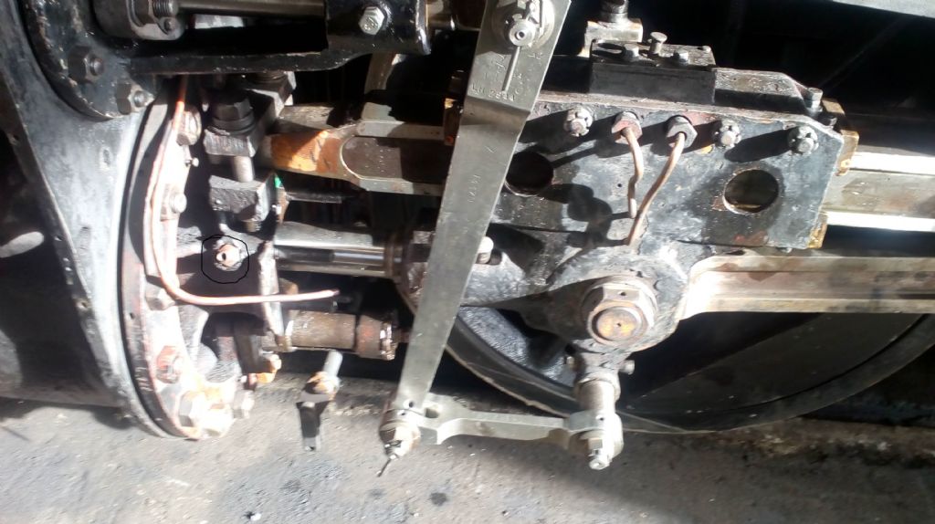

                              Finished the piston rod oilers for a tank engine on a steam railway (the bit with a just-visible ring in the top pic):
                              Simple parts, but not so easy. The main thread is a total batsrad – M22,46 (prob 22,5) x 2,5 as near as I can measure. It would've been nice to've had one o' them 3-wire spiral gauges to measure the originals and work to that, but nothing like that was to hand, so I just started from the OD and cut the thread to just under the 1,53 nominal depth for 2,5 pitch.
                              The only gauge I had was the loco sitting in the shed, and my lathe is in my garage.
                              So I've ended up with a bit more of a rattling good fit than I'd like, possibly due to the crest flat I had to put on my screwcutting tool to stop the tip breaking off. I'm hoping that good old PTFE tape will resolve any problems.
                              I'm sure they'll let me know… blush
                              Edited By Mick B1 on 05/02/2018 13:29:12
