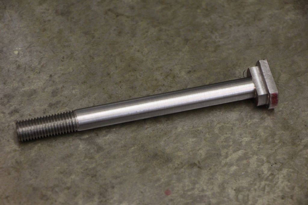

                            Part of the G.H.Thomas rear tool post courtesy Hemingway. Starting point is a 5" x 7/8" mild steel bar. Quite pleased with it but it took me over 5 hours to complete – not including machine clean up time! While I enjoy watching these things take shape, I do wish I could work a bit quicker.
