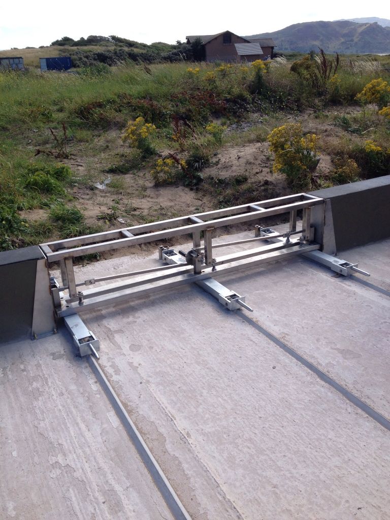

      image.jpgThe traverser installed.

        Hi Brian,
        Good work!
        I notice on some photos that you haven't put a 2½" gauge rail in. Are there any plans to do this or have you decided not to bother with this on the new site?

                Hi John, A decision was taken at an agm not to put either a 2.5" or larger gauges in. The club had run on a closed site for years with the only revenue earned by taking the portable track to events, so when they had to move the coffers were very empty. The club was very determined to get another track and a site was offered and when I saw the site three years ago my heart sank.
                Now three years down the 'line' their efforts have come to fruition and they have a superb outer loop (phase 1).
                Sheer determination and hard labour from a group of old gentlemen, well it's amazing what has been achieved.
                I dare say that over the next few weeks the steaming bays will be installed and they will be able to run their larger steam locos.
                Bri

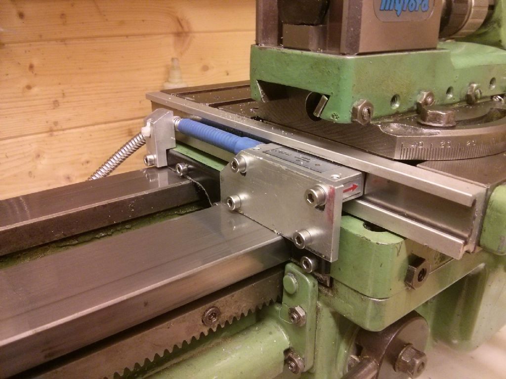

                                      img_20140812_171944.jpgFitted a magnetic encoder to my ML7 cross-slide, checked the accuracy using two dial gauges and working to within one thou – have earned a pizza and a beer, maybe not in that order

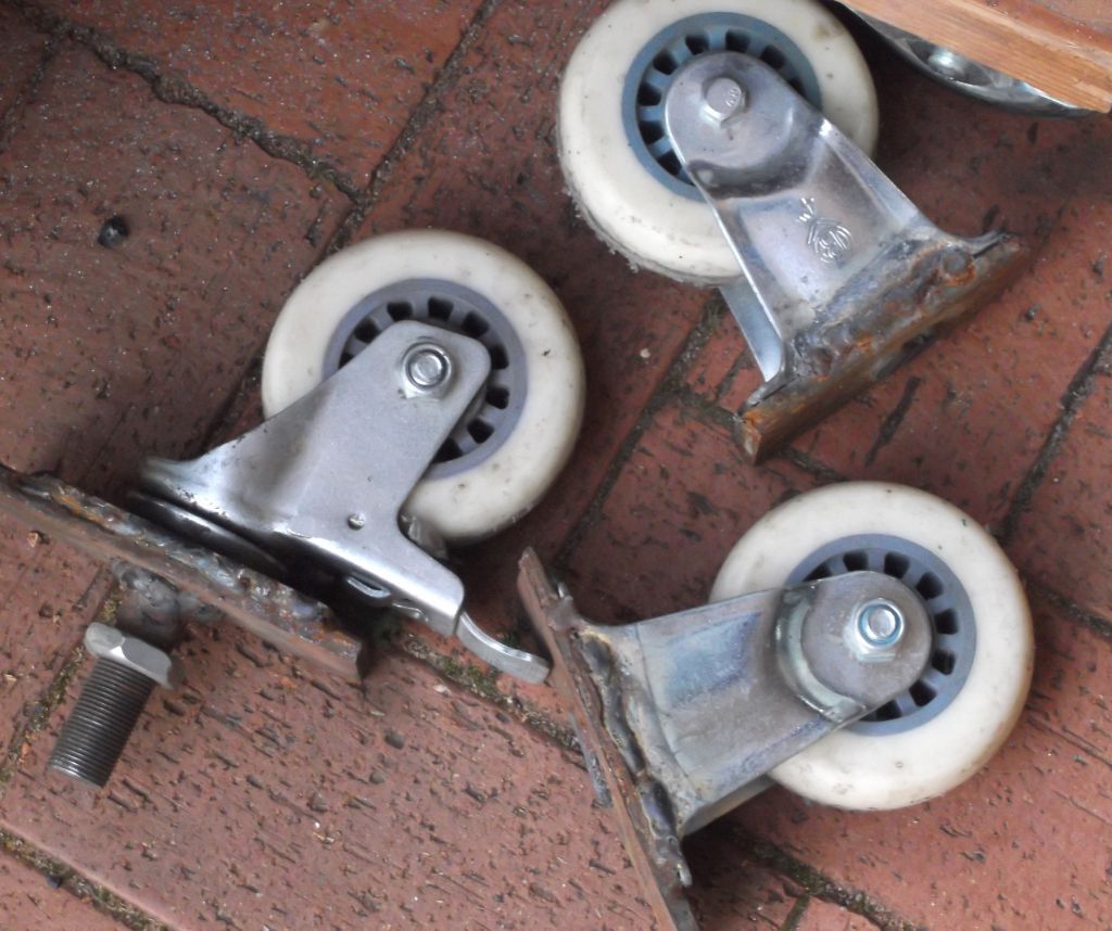

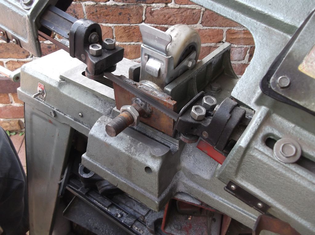

                                          Had been given some castor wheels by my oldest son they were being thrown out at his work nothing really wrong other than who ever had welded the plates of 3/16 flat on top left dangerous edges to them..
                                          He thought I could use the wheels for a wood lathe steady. I had other ideas.
                                          Cut the old bolts off first, removed the wheels and then cut the dangerous over hanging edges off. Ground the remaining bolt and weld of the top. drilled a centre hole in the ones which didn't turn as well as the 4 holes to mount them on all 4 castor wheels.
                                          I now have a spare set of good quality castors heavy duty to use. ooops no photo taken yet of finished items blush
