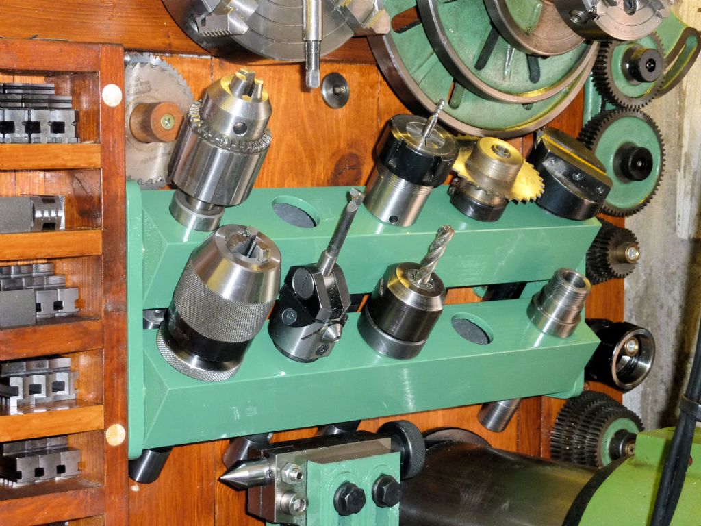

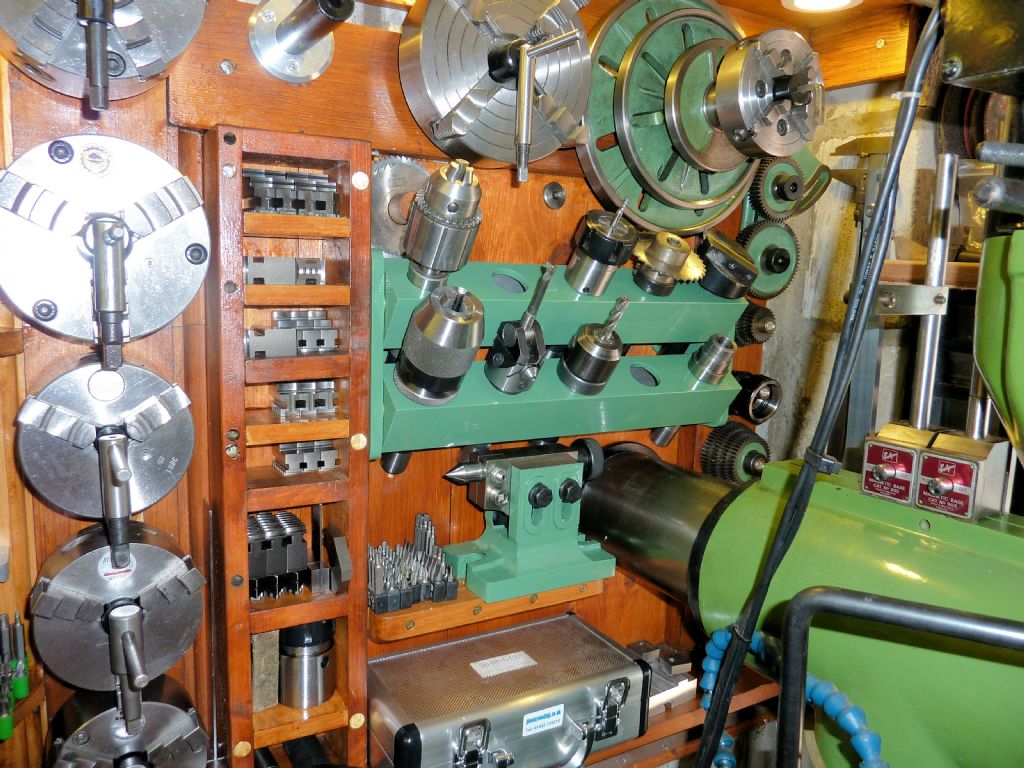

              Completed the R8 tool rack. Now have twice the tool storage capacity in the same space as the old vertical rack. Result.

                Chris H, love the colour of those racks, what paint did you use?

                  Neat rack. I migt ry and replicate that in wood for MT2/3 tooling.

                    Thanks Neil, and the paint was Myford green synthetic enamel, but there are quite a few other colours available as tins of 'Radiator Enamel Paint' from your local DIY store, same stuff I think. Good for painting metal anyway.

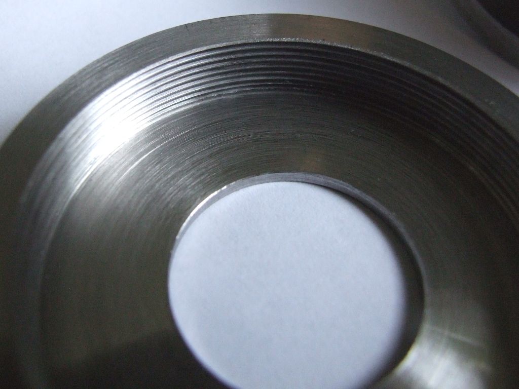

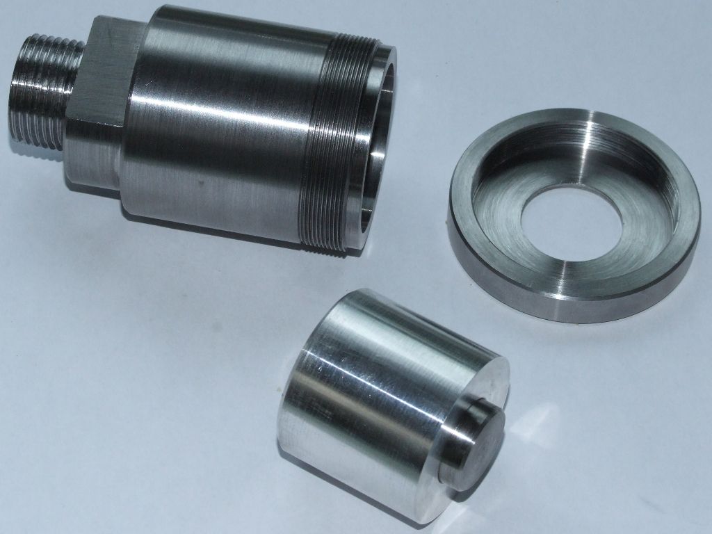

                                Here's a picture of my latest project:
                                Not shown is the standpipe that needed reducing in length, after the application of brute force and iggerance, plus a large hammer, got it separated from the cast iron lump on the end that allowed it to be connected to the 4" water main.
                                The thread top left is 3/4" BSP. The thread on the right hand side of same part, and the internal thread on the part to right of that is a weird one. The OD is 50mm, the thread is Whitworth form, 26tpi. There were good reasons for choosing such an odd combination. smiley Here's a close in picture of the internal thread:
                                All the threads were screw cut. The external threads were cut at 540rpm, and the internal one at 370rpm. It took some nifty work on the half nuts to avoid running the tool into the shoulder on the internal thread, although I may have had some help. wink

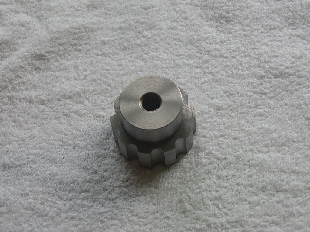

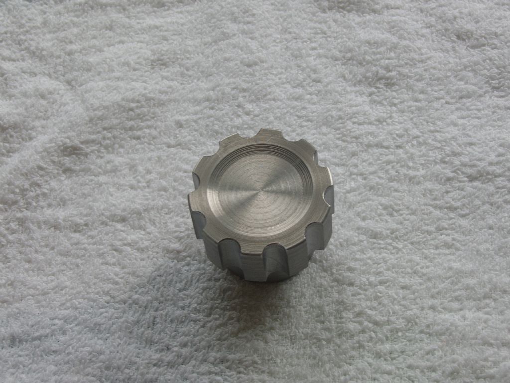

                                    Well after what seems eons of missed opportunity due to work and family (young kids) I managed to find some workshop time yesterday and this morning. Not having a major project to have a go at until the new workshop gets built I decided to tackle a small job – the missing knob for the gear change on my Elliott 10M shaper.
                                    Starting point – the 1/2" 12tpi thread on the gear change stud.
                                    Result =
                                    Now my question is how can I prevent this rusting over? It's mild steel and I made some spacers for the motorbike which rusted very quickly. This won't be going outside but I think some protection is needed. I'm thinking Hammerite over primer as I can get 15% off today. Will pop out and buy some.
                                    It's just good to exercise the brain and cranking arms after what seems like ages
                                    John (a lot happier now)

                                      I would heat it to bright red then drop it into (old and dirty by preference!) engine oil. It will go nicely black and resist rusting quite well. The black finish will be much more durable than any paint.

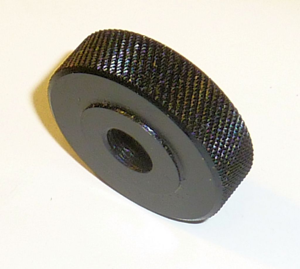

                                          Can't seem to edit posts to add pics, but here is an example of something similar I did many years ago, it still looks good…

                                            I'd heast it up and dunk it in clean oil a few times (beware the oil flashing over) – I use ordinary cooking oil.
                                            Sounds brutal, but gives a nice even dark finish with modest rust resistance.

                                              I usually heat small bits up with the torch slowly, when the colour I want comes up, I quench it in clean water, remove it while still hot, and when it air drys, and still warm, rub it oil, if it's not to be used for some time it gets left with wet oil, and wrapped up and put away some where safe, where I won't be able to find it when I want it, so I'll make another one, and then when all is finished the origional bit will turn up. Ian S C

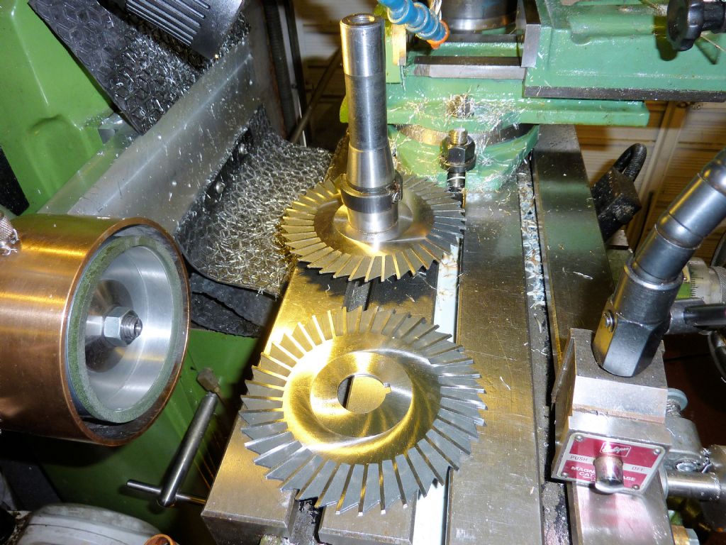

                                                      Refilled my coolant tank on the mill – and managed to leak 1/2 gallon soluble oil+water over the floor of the 'shop. Only simple way to fill it is to tip it into the tray and let it drain (slowly) back into the tank, however the seal had perished on the tray. Plus – the fill gauge wasn't working so there was too much anyway. Had to get the hosepipe on the floor!
                                                      Received a nice pair of 5" x 1/16" HSS side-clearance slitting saws (British make) from Tracy Tools for just £12 the pair. I don't know why they have keyway cutouts because I'd rather it slipped on the arbour if it jams rather than shatter!
