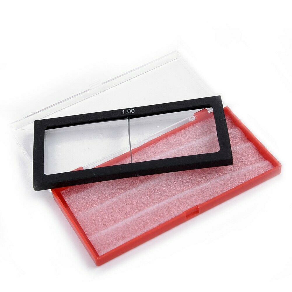

          I have two,an expensive one bought about 10 years ago and a Lidl type bought recently. I think the cheaper one is better, mainly because over time the sysyem has improved and the lens are better controlled. One tip I was given by a welder is to always wear a pair of plain glass spectacles when welding because sometimes, especially on stainless steel, slag will break off to fly in all directions. I now also use a "cheater lens", taped to the inside of the helmet which works better and cheaper than prescription glasses.

                        I need to wear reading glasses for close work and have an auto darkening helmets but find it cumbersome to wear glasses under the helmet.
                        I recently bought a magnifying lens on ebay and attached it to the inside screen with double sided tape and can now clearly see the weld without wearing my glasses. The lens is available in different magnifications and not expensive.

                          I have one of the Parweld Tru-colour auto darkening helmets and find it very good for Tig but not so good with MIG. For MIG I revert back to my Speedglass 9002. I also use a cheat lens (2.5mag) with the Parweld and 3 times magnification lenses in my close work spectacles. I can actually see what I'm doing. Just done a C&G Level 1 TIG course (FOC) and now doing a C&G Level 1 MIG course (again FOC). Only have one test weld (lap fillet weld) left to do, but cannot see what I am doing with either helmet. I have tried marking the edge with chalk, next time I am going to linish the top face so I can hopefully see a shiny edge and a dark edge.
