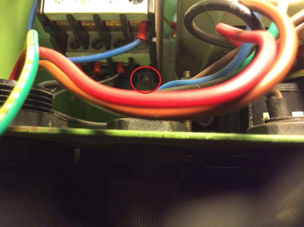

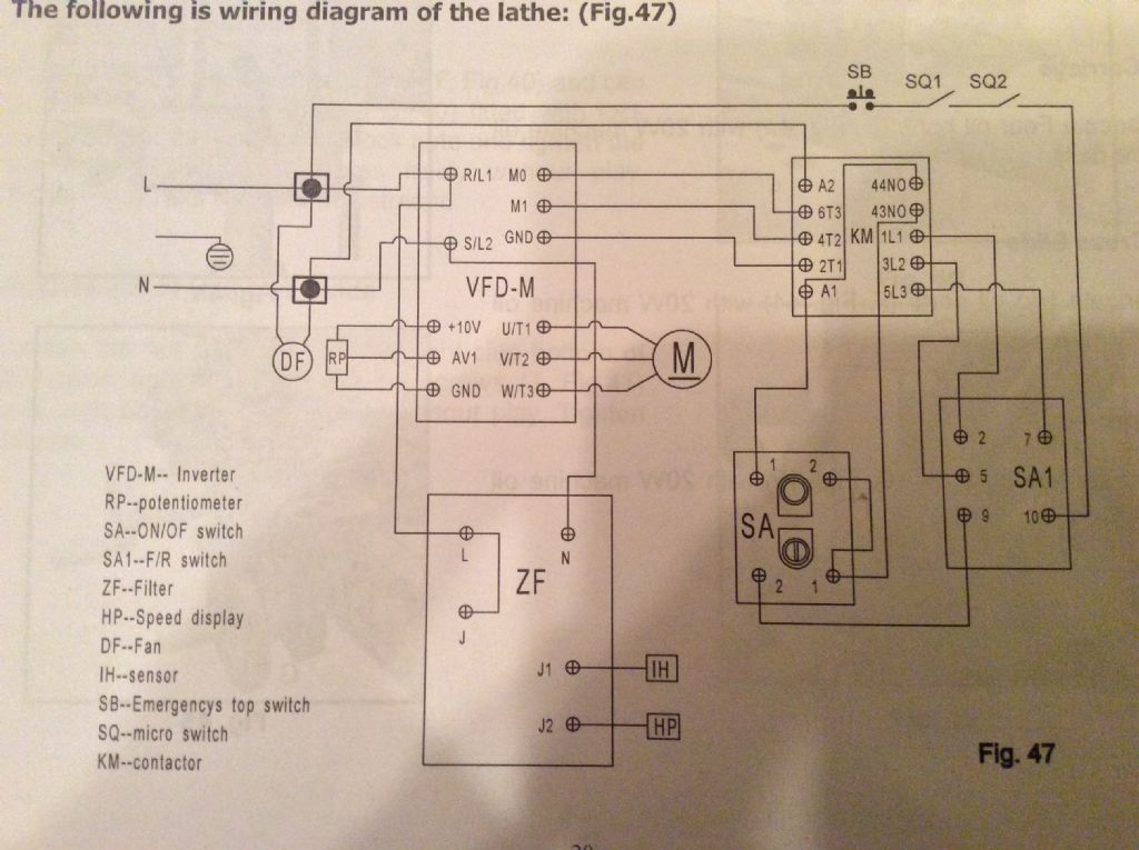

                    The Contactor is as per this photo,
                    The wiring diagram is as below.
                    Thank you for suggesting that I check the emergency stop button and belt/gear cover . Having been caught by that in the early days of ownership , I had gone through that process , but I appreciate your concern .
                    Taking up SOD’s suggestion of removing the top front plate to access the guard limit micro switch , I discovered ( not
                    visible using mirror at rear ) that there is a wire which is not connected . I think that it may be a clue as to why my machine won’t run . My god , there’s no flies on us in this part of the world ! .
                    Above is a picture of the loose wire , the blue one with red tag , Not the faintest where it goes ! And I can’t see from diagram below any suggestion of the terminal block .
                    Apologies for the quality and orientation of the photos, getting my phone into the space behind the Lathe and getting a meaningful shot was not easy .

                      DAG
                      The floating blue wire appears to be a connection to mains neutral. According to the circuit diagram there should be a mains neutral connection to terminal A2 of the contractor. Without this the contractor will not operate. I suggest you check to see if the connection to A2 is missing.
                      hth

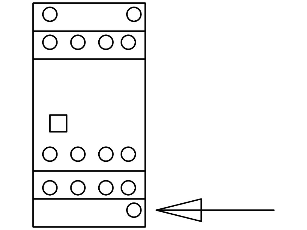

                      #331853

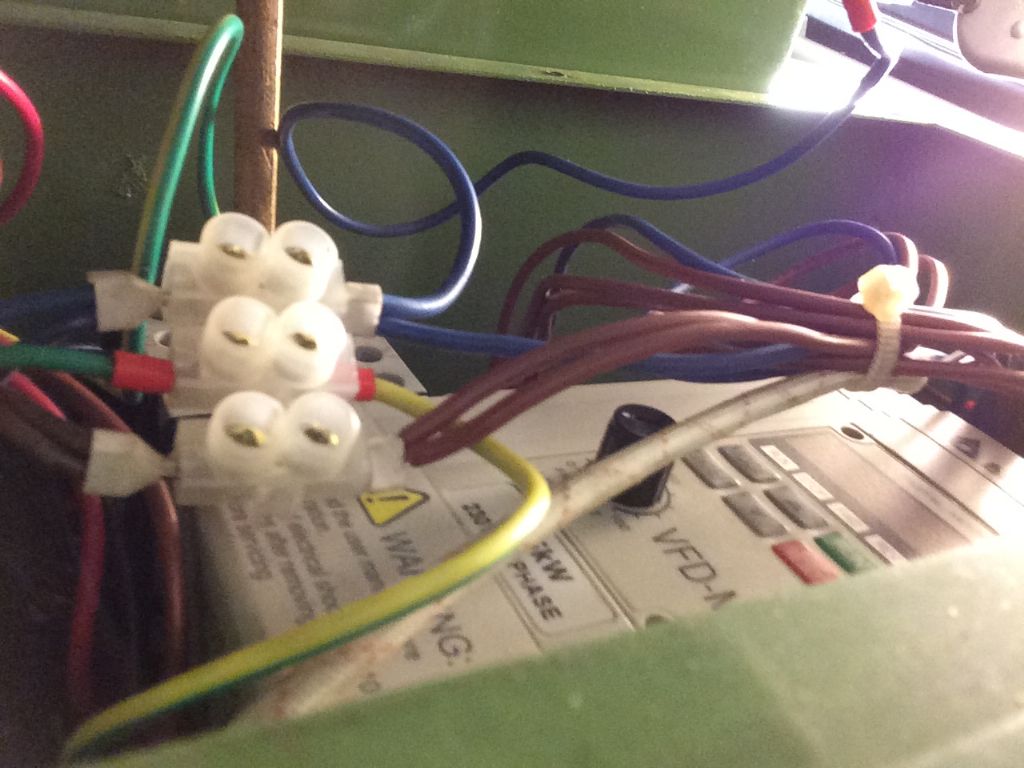

                        I found it impossible to get a meaningful photo of the wiring – there's always something in the way and/or the important bit is in shadow.
                        Anyway, on my machine:
                        • The blue neutral wire that's grouped into a cable-tied bundle goes to the ON/OFF switch
                        • The other, which appears to have become detached on DAG's lathe goes to the contactor. As Mike says this is A2 on the diagram.
                        I can't see the marking on my contactor to confirm but the blue neutral goes to the bottom right terminal, arrowed on the diagram. This is the contactor as seen from the rear panel.
                        This would be an easy fix if it wasn't awkward to reach. You have to approach the contactor from the rear and I'm afraid you will have to move the lathe to get access. May be worth experimenting with a mirror but…
                        I'd use a long screw-driver to slacken the terminal screw being careful not to let it fall out. Then I'd use long-nosed pliers to feed the wire into the entry hole under the terminal and re-tighten the screw. If you don't have suitable pliers make a rod with a releasable loop on the end to steer the wire into position.
                        While you're inside, it's worth gently tightening all the terminals to make sure they're all firm. The wire probably got displaced during your repair but I suspect the terminal wasn't quite tight enough in the first place.
                        #331860
                        Mike Crossfield
                          @mikecrossfield92481
                          Just a word of caution. The terminal indicated in Dave’s sketch seems to be clearly labelled A1 in DAG’s photo. From experience with similar components I would expect A2 to be on the other end of the contractor.
                          #331876

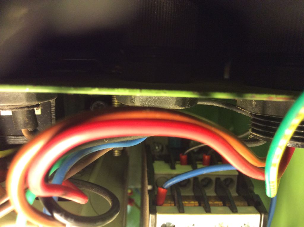

                              D.A.Godley
                                @d-a-godley
                                Managed ( without lifting ) to spin the machine through 90degs , and am now able to access the electrics box .
                                Again thanks to all for your Input , SOD , my workshop is so tight , me and a long handled screwdriver won’t fit at the same time hence spinning the Lathe .
                                Above new photo of Contactor and below shot of underside
                                This is upside down ,that said , is that blue wire the one you suspect is missing SOD ? .
                                I have put a mutimeter over the micro switch and proved that it is making and breaking as it is supposed to.
                                I shall certainly check that all wires are firmly fixed whilst I have the back open .

                                  I would have expected terminal A2 to be at a lower level than the blue wire shown in your photo. Like terminal A1 shown the previous photo. If we’re right about it being where the floating blue wire should go it will have nothing currently connected to it
                                  #331942
                                    Hi DAG,
                                    Mike's got in first and he's right again. A2 is two steps down and further back. The blue wire in your photo is correct, but it isn't the same as your loose wire.
                                    In your photo, here turned the right way up, I've ringed A2's terminal screw in red. You can't see where the loose blue wire goes up and under behind because the bundle of wires is in the way.
                                    The contactor terminals are in steps. You want the bottom right terminal which is at the back.
                                    Hope that make sense!

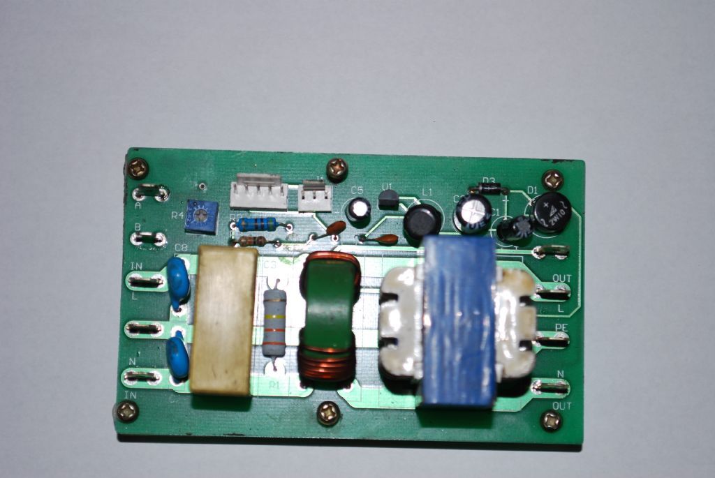

                                              Les Jones 1
                                                @lesjones1
                                                Measure the voltage between the L and N terminals (AC voltage.) on the filter board. This is also the power supply for the tachometer. I suspect a wire has come loose between the mains input terminals and the mains input to the VFD this then goes on to power the filter board. See the schematic you posted 09:11 on 13/12/17
                                                Les.

                                                    Les Jones 1
                                                      @lesjones1
                                                      I have never seen inside a WM280V lathe so I have no idea where it is physicaly situated.  This is a picture of the board from some previous thread.
                                                      This is the reasoning for my suspicion as to where the fault is located. According to the schematic the mains cable comes into a connector block and there are three pairs of wires from there. One to the fan. (Which you say is working.) One to the switches and contactor. As you say that the contactor clicks when you press the start button then this wiring must be intact.. The third pair goes first to the terminals R/L1 and S/L2 on the VFD an then another pair of wires go onto the filter board. As I have seen pictures of the filter board I know it is easy to get to the L and N terminals to see of power is getting there. If power is getting there then it also must be getting to the VFD. As I have never seen the VFD in your lathe I don't know how easy it is to get to terminals R/L1 and S/L2. A wire must have become disconnected at either of these terminals or at the terminals that the incoming mains cable connects to.
                                                      It is the L and N in connections on the left of the picture of the filter board that you will be testing If you can get the the connections on the VFD more easily then do the voltage check there first.
                                                      Les.
