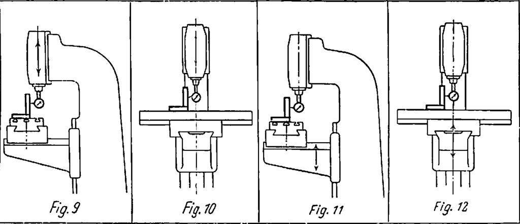

        To check if the quill is perpendicular to the table, proceed as follows :
        Fully extend the quill and clamp it.
        Mount your magnetic base on the table & set up a dial gauge to bear on the front of the quill as close as possible to where it exits the head casting. (You may need to use a finger clock to get close to the top of the quill & so be able to check over the longest distance.)
        Clamp the head to the column.
        Using the X axis (table moving left – right) "wipe" the dial gauge across the quill and adjust so that the needle reads zero on the high point. (Note that you may get a different reading depending on the direction of movement – just remember which way you were moving to get the zero when you take the next reading.)
        Unclamp & raise the head such that the dial gauge reads close to the bottom of the quill (don't touch the dial gauge !). Reclamp the head.
        "Wipe" the dial gauge across the quill again & the error is the highest (or lowest) reading on the gauge at the high point on the quill when moving in the direction that you set the initial zero.
        Then repeat the process, but with the dial gauge set on the side of the quill & "wipe" it with the Y axis (table moving front – back) rather than the X.
        The readings "should" be pretty well the same top & bottom from both setups – my guess is that the side value will be close & the front value will be out.
        If the column is perpendicular to the table in both directions (as you suggested earlier) & the quill isn't, that suggests that the quill bore isn't parallel to the rotating joint face at the rear of the head casting. This could well be the source of your front to back tramming error.

                Posted by STK2008 on 24/04/2018 13:34:38:
                Tramping back to front I get 0.006" with no way to fix it as the head does not nod.
                STK, to tram the head fore and aft, do a google for G0704 3 Bolt mod. You may fid that will help fine tune the head.
                Mark

                  Ok then did what I think Warco meant and made no diff.
                  I redid my test when I ran the DTI up and down the Z column just to see if the spindle spun it realy does not its to stiff for it to rotate etc plus as you can see the DTI returns to zero every time if the spindle had spun it would read some thing else.
                  I am slowly loosing the will to live I have spent 3 days on this and every test I do all be it not 100% the best gives same sort of results.
                  I did what mgnbuk
                  Believe it or not I got 0.001" so nothing so the quill is square in the casting so to speak.
                  So only thing it can be is the head not sitting on the Z axis square front to back? off course this is ok left to right as I can tilt the head but not nod.
                  In the videos its off that much the verdict actually leaves the surface completly.

                        Posted by STK2008 on 24/04/2018 20:16:33:
                        Would a set of these be better to move the quill up and down on rather than my engineers square?
                        **LINK**
                        It's impossible to answer that meaningfully, without knowing the accuracy of your square.
                        But, I can see no reason to expect them to be any more accurate than a decent test square.
                        … is their squareness specified ?
                        Schlesinger illustrates the use of a square, and mentions in the text that it should be clamped to the table.
                        In general terms, I believe your test method is correct.
                        Checking the square; clamping it to the table; and improving the rigidity of your indicator-mount would all improve confidence in your results though.

                          So yeah from that diagram I’m seeing the head being trammed while moving the table up which would be what I’m doing when I move the whole head up and down
                          Then I see in the diagram moving the quill up and down to also check that.
                          Now when I move the head up and down if I’m not wrong it shows that my z axis column is fine as I get no more than 0.002″ over about 60mm or so I can live with that.
                          But as soon as I move the quill up and down its game over 0.015″+.
                          I understand what every one is saying g.
                          Is square well square yes I’m sure moving head up and down would show more than the 0.002″ I was getting g if not?.
                          So I removed that and used the z axis column same issue.
                          I then made sure spindle is not moving I’m sure it’s not its to stiff to rotate and I did not see any movement at all plus verdict returns to my original zero.
                          I’m not going to lie this issue is gutting me I’ve saved for a very very long time I just want to make stuff etc.
