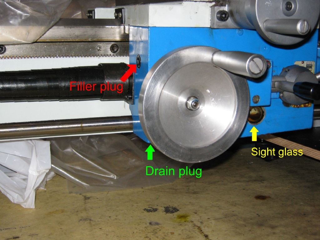

                    Drain plugs:
                    Warco manual.. Lathe Gearbox Assembly page .. part # 11.
                    Lathe Apron Assembly page .. part # 27 looks to be the drain plug although this is described as 'screw' (usual excellent chinglish translation) check on your machine!
                    I'v looked up the Grizzly equivalent machine & as near as matters is the G0752.. pdf parts list page 84 .. gearbox..part # 814.. drain plug. It doesn't show where the apron drain plug is but logical deduction is that it would be underneath near the sight glass or low down on one of the ends of the apron casting.
                    PS, have just checked on mine & there is a SH screw underneath the autofeed (half nut ) lever which may well be the drain plug but looking at the Warco manual this is not identified other than showing as an unidentfied screw,with what looks like a ball bearing on top, nestled in between part #'s 28..'screw' & # 29 'Label'.. ? whatever the case it will be awkward to remove & refit. the alternative would be to remove the hex head sight glass(on mine) drain off from there & refill from the SH screw on the left side of the apron (3/4 way up casting) until clean oil comes out of the sight glass location,refit the glass & top up to 3/4 level. I can't see part # 27 'screw' unless it is flush & has been painted over when they have sprayed the casting (any other owners noted / resolved this point)..?

                      On my new lathe the drain plug is situated on the underside of the apron, at the left end closest to the headstock. I have a photo showing the apron.

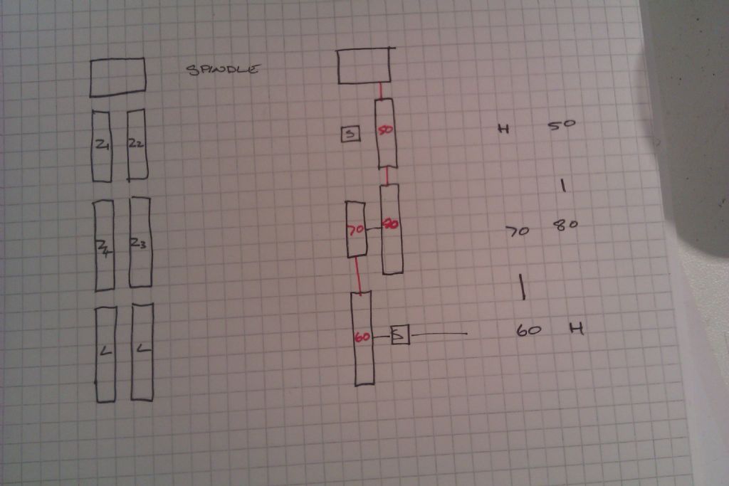

                          I'd be happier to calculate myself. Does anyone know what the leadscrew pitch (metric) is? And how many teeth on the headstock/spindle gear? I distrust tables (having been caught once) but perhaps that's just me!
                          SteveW
                          #124308
                            H means there is no gear, use a spacer either from when you remove the feed ratios or in the box with the change gears
                            L is the leadscrew gear
                            The vertical dash between mumbers show that the gear above meshes with the one below
                            Numbers side by side are on the same bolt eg Z1 & Z2 are on one stud, Z3 & Z4 on another

                              This may make it a bit clearer, gears based on the WM280 which may differ from the 250. to give 1.75mm pitch with metric leadscrew
                              Front selector in "A"
                              Click to make it bigger.
                              Do check it first as I have found errors in the 280 chart relating to which position the front dial should be in but have only corrected teh imperial threads as I have a 8tpi leadscrew
                              Edited By JasonB on 11/07/2013 13:50:57

                                Thanks Jason for taking the trouble to do a diagram.I can get my head round it now and try the gears shown in both tables. I'll do a test piece first and check with a gauge. By the way mine is a metric lathe with a 3mm leadscrew.
                                Steve, is there a formula to check I'll eventually have the correct gears? … John

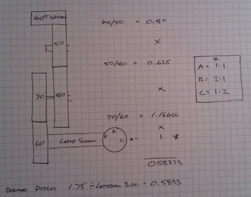

                                    John, this is the formula based on my Imperial 280 but assuming its got a metric leadscrew, the head and gearbox should be the same on both its just the leadscrew that would be different.
                                    We know the leadscrew will move the carrage 3mm per revolution of the chuck but we want it to only move by 1.75mm per rev so 1.75/3.00 = 0.583333
                                    Now to get the same number with the gears
                                    Basically divide the driver by the driven so the 40T spindle drives the 50T, 50T drives the 80T, 70T drives the 60T, this gives us the fractions 40/50, 50/80 & 70/60 noe expressed as decimals 0.8, 0.625 & 1.16666.
                                    The gearbox ratios are A=1:1, B=2:1 & C=1:2 which give the decimals 1, 2 & 0.5.
                                    You now multipy these decimals so 0.8 x 0.625 x 1.16666 x 1 = 0.583333
                                    If the two numbers are the same you have got it right. In our case they both come out at 0.583333

                                            Thanks again Jason,you make it look so easy. I got it set up last night 30-80 70-60 but didn't have time to do the test piece. Will update. John

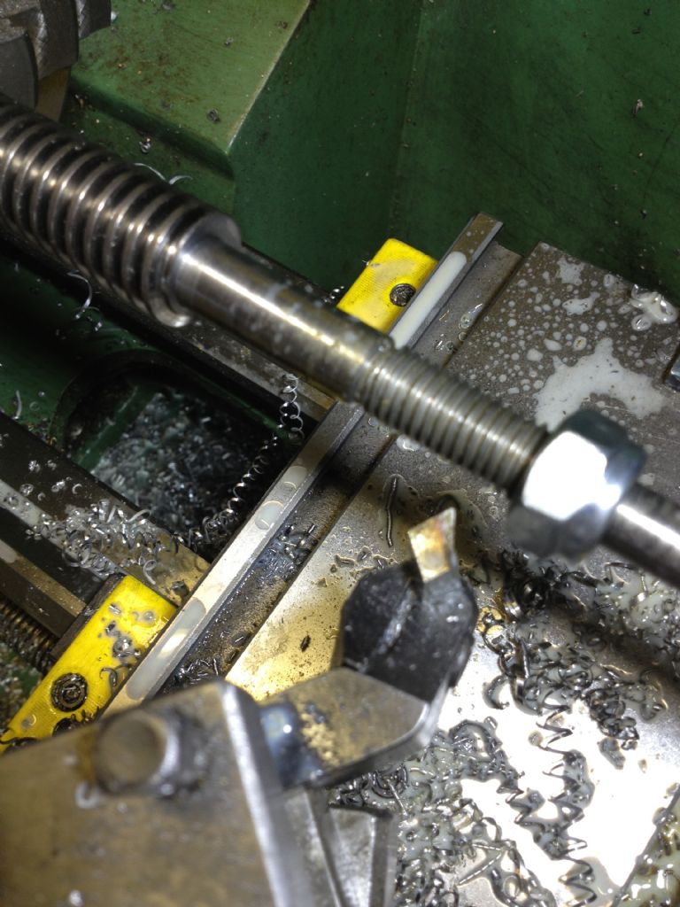

                                                    Just an update, due to your help I managed to cut the thread on my wm250. The nut fits very well with no shake. Set the topslide over to the 60 deg mark and fed that in 1.2mm. Its for the retaining nut on a new leadscrew I'm fitting to my Harrison milling machine. You'll notice I'm using a Diamond tool holder that comes with a jig to grind the tool to 6o deg. Thought it was a bit of a gimmick at first but if you set the jig screw at the correct angle (trial and error) it comes out great. Thanks again for your help. John

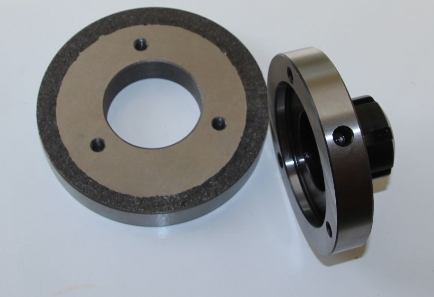

                                                      I ordered a new collet chuck with my lathe and would have used it this afternoon but discovered that the backplate that came with it needs to have a locating boss machined on it to take the chuck. Although the chuck has three tapped holes I was contemplating opening them up to clearance and drill and tap the backplate but then realised that the backplate has been hardened – so drilling is probably out.
                                                      Is it normal for WARCO to expect the customer to do the machining? Maybe the job is a better one done on the customers own machine – I don't know.
                                                      The backplate shown is "as delivered".
                                                      Rik
