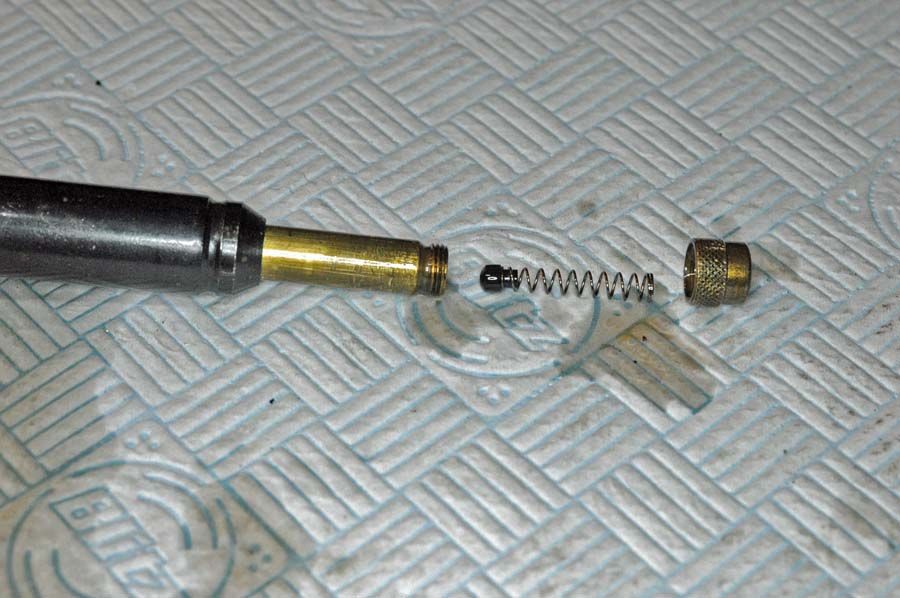

      Hi Chaps,
      My Wanner 300-4 oil gun, after 40 odd years of sterling service, has started leaking oil from its various orifices. I assume that a seal somewhere has perished. Before I start dismantling this rare and expensive beast, has anyone any experience of refurbishment? Please!
      TIA,
      Rod

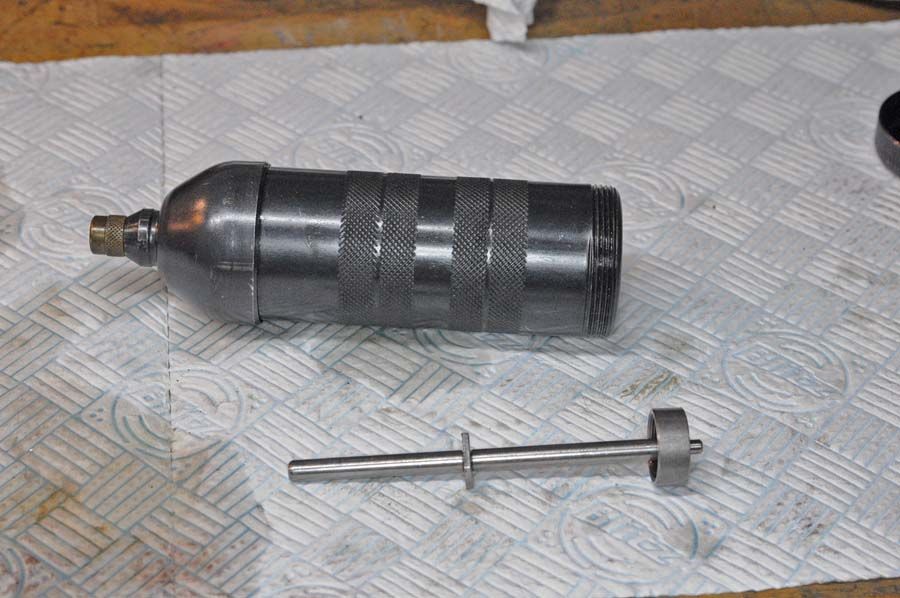

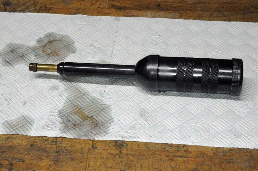

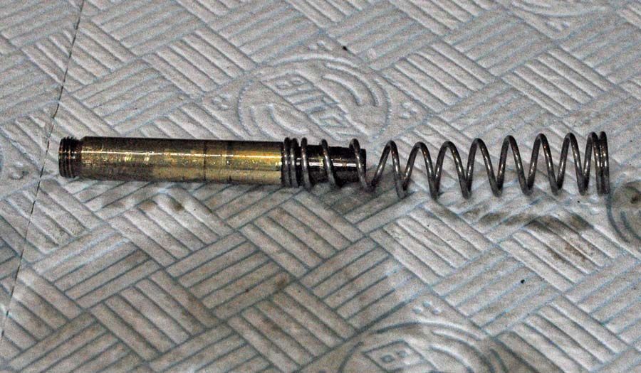

              Thanks to Andy's link I have been able to register with what is now the Metalworks forum in Oz and see some pictures **LINK** . This gave me some very useful tips. Here's what happened to me, my gun is subtly different to Anorak Bob's:
              When I was using the gun oil was jetting out from between the larger and smaller black tubes as well as the brass tube interface.

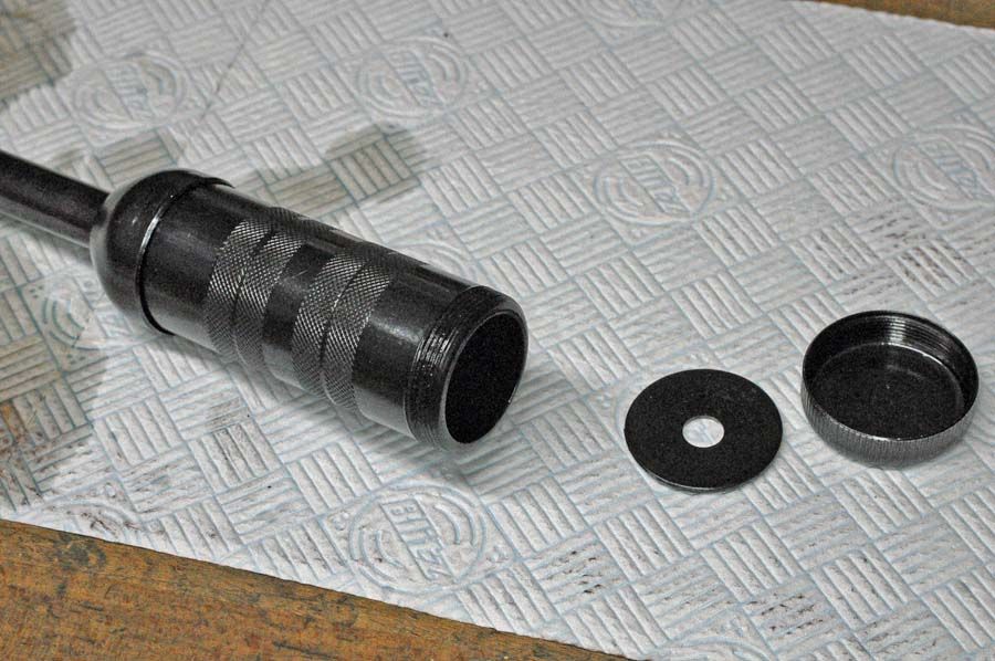

              The normal filler cap came off, the washer is rubbery seal

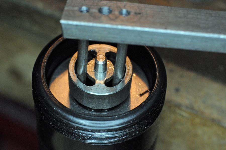

              Inside the main body, the cup washer is prised out to reveal this fancy nut screwed to the end of the smaller black tube. I made a crude pin spanner. The pins have to be long to enable enough of the smaller black tube to be gripped.
              This is what comes out

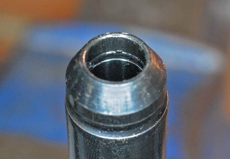

              The nozzle end now has to be unscrewed to allow the brass tube to be withdrawn

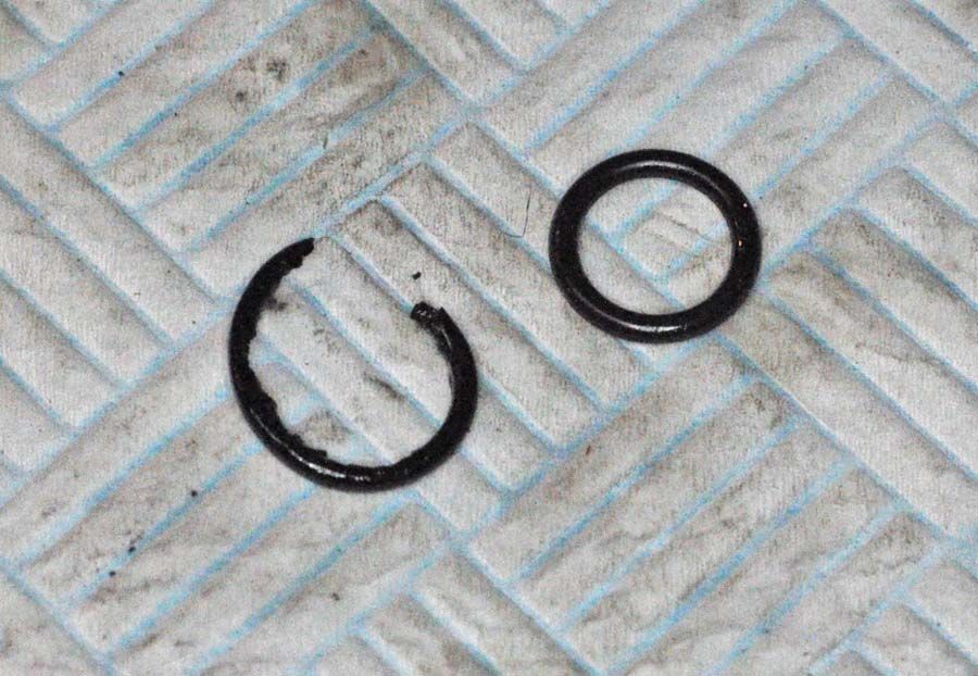

              I've finally got to the problem – an O ring that has become hard and flattened. It was quite difficult to remove and I ended up digging it out with a scriber.
              My small collection of O rings had something that looked suitable – this one is, as far as I can measure it, is 13mm OD x 1.8mm thick.
              Reassembled and it all works, the oil goes where it should. The tapered end of the main barrel also unscrews, even though it is not knurled but, in retrospect, I do not think it is strictly necessary to remove this to change the seal
              So, thanks to Andy Holdaway and Anorak Bob smiley. I hope this helps somebody else.
              Rod
