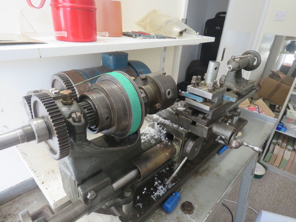

      Hello everyone,
      I have a very ancient lathe which I bought at a model railway show for £10 and just had to add a motor and drive pulley.

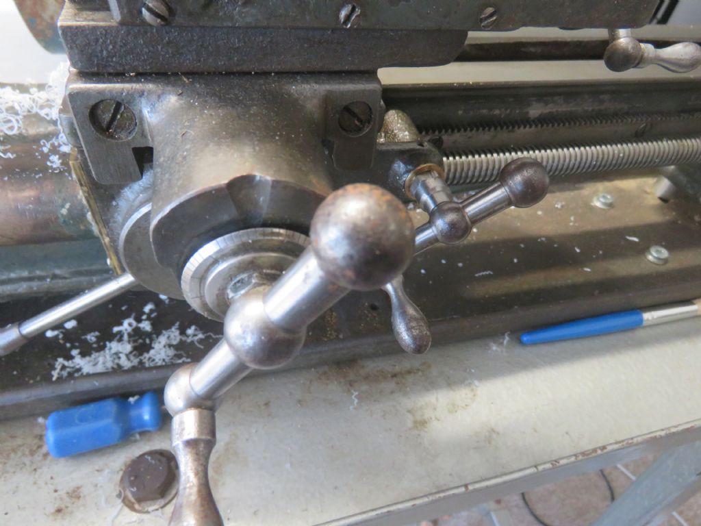

      It seems to be working well, but there is an enormous amount of play in the Y feed – approx 1.4mm.
      Does anyone know how to take out at least some of this slack? I guessed I need to hold the nut and that would enable me to unwind the handle. Then either tighten the nut, or add washers as shims and refit the handle. Is that correct?
      If so I have another problem. The nut is about 2.3mm thick and 11.4mm across flats (29/64"?) – so what spanner would fit and where do you buy a spanner that thin? Nothing thicker will go in the gap between the handle and the cross slide.
      The X feed has almost no slack and feels comfortable to use, but does not have an indicator wheel
      Can you buy these wheels? It seems to be 16 turns of the handle to the inch, so 0.0625 per turn.
      I guess fitting would be similar to what I have to do on the Y feed?
      N.B. I am managing with the lathe as is, provided I always feeding from the same direction, which I believe you should do anyway. But I have to keep on stopping the lathe to measure diameters and then feed back in. There then seems to be the risk of an error of up to 0.2mm.

          You probably have a worn lead screw nut, so it will need some stripping to tell.
          What speed is your motor, these old dears don't have the bearings for high speed?

            You will probably find the nut is badly worn in the cross slide. You can either make a new one or slit the old one and add a screw to make the nut sort of "pinch" the thread to reduce the backlash. However you may find the screw is also worn. New screw can be made or the old one chased (threads made thinner, removing material just enough to take the thread to a uniform state same size as worn part) and a new nut made.
            For a spanner I suggest finding a bit of gauge plate (oil hardening tool steel, ground flat both sides, sold by tool suppliers) and hacksawing / filing out the opening to fit the nut, to make a spanner. It may work fine without hardening if you leave enough "meat" beside the opening. 10" or 250 mm long would probably be fine. Wrap the end in electrical tape for good grip and to protect your hands.
            You could also buy a thicker spanner (maybe 12 mm ) at a pound shop or cheap imported tool dealer and grind the sides to fit.

                The motor is 950rpm with equal speed on the lathe, or 1.6 step up or step down.
                There seems to be no identifying marks on the lathe, so I do not know what make or model. I read there were quite a few generic machines made, especially during WW2, so maybe it is one of those?
                To remove the cross slide in order to access the cross slide nut do I just keep unscrewing the lead screw until I can pull it apart?

                  Remove the two screws in your second picture and you can unscrew the leadscrew. The cross slide will probably slide off. If it stops, then you will have to remove the compound with the toolpost and look for screws holding the cross slide nut and remove them.

                      That's got 6 speeds as it looks to have a back gear.

                        Sounds like you are running the lathe much too fast.
                        Typical countershaft speeds for machines of that era would be in the region of 250 to 350 rpm. Generally the spindle oiling arrangements for these simple plain bearing headstock machines aren't up to handling speeds above 600 rpm.
                        Concerning identification the inverted rack with teeth pointing upwards provided for driving the saddle is very unusual. Coupled with the extremely skimpy saddle apron and left hand operated half nut lever for screw cutting it ought to be possible to identify it. I'm fairly sure that a machine with similar features was added to the list at **LINK** sometime in the last 4 or 5 years. I have a horrible suspicion that machine had its feednut cut directly in the saddle casting. If so it will need to be bored out and new nut fitted. Which may be difficult as space will be limited.
                        I'd undo the two screws holding the handle assembly to the cross slide then wind the screw out so you can see whats going on and, hopefully discern how it's all put together. On a machine like that expect some creative simplicity to minimise the number of parts. With the screw assembly removed pull off the cross slide too so everything can be examined and given a proper clean.

                          It looks like one of the RandA type which were made by and for a number of companies.
                          Backlash isn't a problem until the nut fails to hold and skips a 'tooth'. Learn to tlive with it for the moment until you get to know more about lathes otherwise you'll get bogged down in a repair cycle and not make anything for months,
                          A more pressing problem is a countershapft to bring th espeed down, but you can make wooden pulleys and run a shaft in plummer blocks on a wooden frame.

                            11.3-11.4mm a/f is 3/16" Whit. or 1/4" BSF spanner size. The nut won't be too tightly done up. A piece of 3mm mild steel flat, a hacksaw and a file wil soon produce a spanner.

                              Hi Arthur, I agree with Bazyle that it looks very much like the RandA designs or the variants RandA lathes If it is slack between the cross slide and the screw you feel you need to adjust, you will see a noticeable gap between the nut and the cross slide when you wind the handle one way or the other. If there is no noticeable gap, it is likely that the thread that the screw, screws into is worn, which may be an extra problem for you, as with most of these types of models, they have the screw thread cut into the saddle casting and there isn't much metal to bush and re-tap a new thread, the photo below shows a RandA one that I have, to show you what I mean.
                              Yes, if you continue to wind the cross slide out, it should most likely come off the saddle when the screw comes to the end.

                                  Thanks for all your helpful replies. It is good to know which machine I have. It looks as if someone has fitted a new handle to replace the screw cutting gears.
                                  I think Nick has accurately described the problem <<If it is slack between the cross slide and the screw you feel you need to adjust, you will see a noticeable gap between the nut and the cross slide when you wind the handle one way or the other.>>
                                  So hopefully not the more serious problem of the saddle casting being worn.
                                  I shall either find or make a spanner of the correct size and see what happens if I turn the nut. If that does not help I will probably take Bazyle's advice and leave well alone.

                                    For a machine of that vintage, the nuts are very likely to need Whitworth or BSF spanners, not Metric or A/F..
                                    The threads wiil probably be BSW or BSF, with possibly BA for things like gib adjusters.
                                    You need to distinguish between slack and backlash
                                    Backlash is wear between leadscrew and nut, and unless there is provision for reducing backlash, such as split nut, short of making new parts, there is not much that you can do about it. You just learn to take out the backlash as you use the machine. (If you overshoot, back off by more, at least twice, than the backlash and then advance to where you want to be )
                                    If there is play between the handle and the cross slide, if possible the handle can be moved along the Leadscrew to close the gap. If the position of the handle is fixed, by a pin, the space can be filled with one or more washers, or even better, a custom made spacer. Which you can make on the lathe!

                                      Success!! I found an unmarked spanner deep in a box in the garage and that fitted the nut. I held the nut and the handle just unscrewed. A wrench on the shaft held that still while I tightened up the nut to take up the slack, without making it too tight, then I held the nut to re-tighten the handle.
                                      It is now sweet to use with a sensible amount of free movement, but the handle doesn’t flop around any more.
