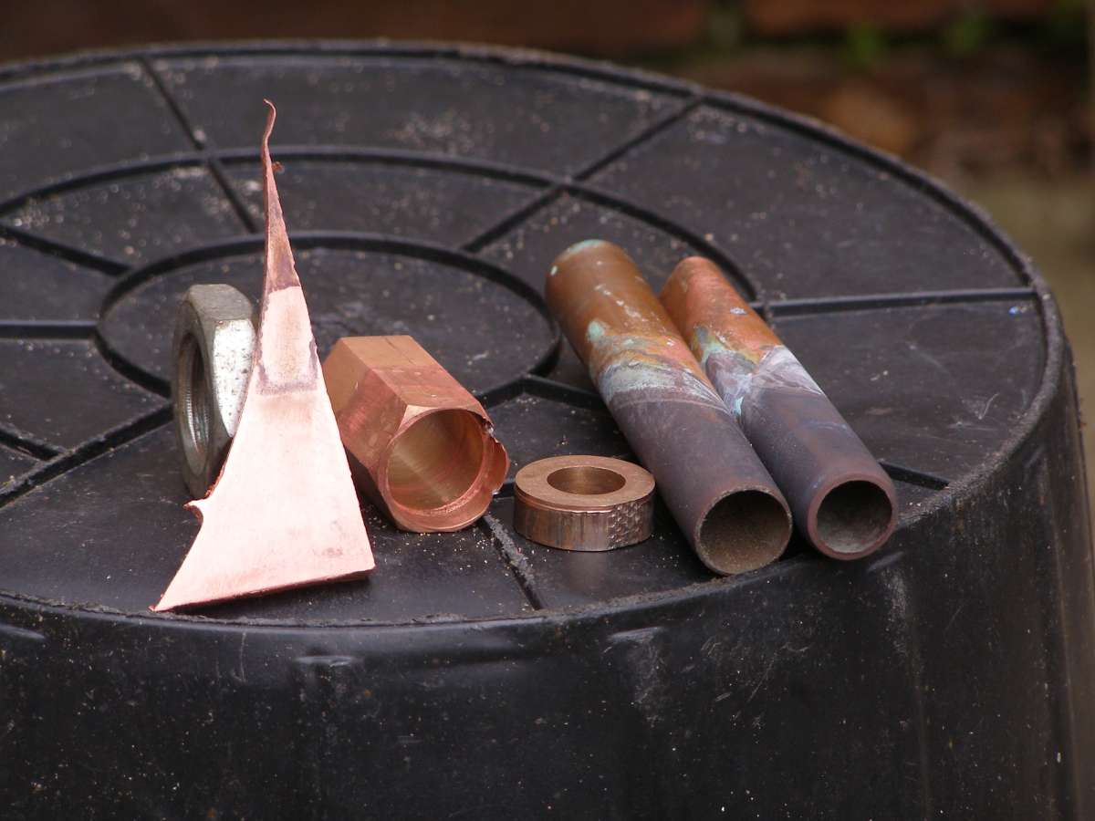

                      So I did, using very dilute Hydrochloric Acid with a squirt of Sulphamic Acid domestic limescale remover.
                      The results are in the photo.
                      Left to right: the Gilding(?) Metal, a piece of brass, leaded gun-metal and two bits of copper plumbing pipe. Of the last I cleaned one with sandpaper but left the other dull. I sandpapered all the others, then washed them all in Swarfega then soap and water.
                      I removed the samples this morning, washed them in boiled water (still hot) then photographed them.
                      Both faces of the Gilding Metal emerged bright, but non-abraded reverse showed a faint, fine chevron pattern – I could not have photographed it.
                      The Brass, curiously, was more pink above the acid than submerged.
                      The Gunmetal stayed bright with find grey streaks on its drawn surface.
                      The copper pipe – well I expected it to be either bright or some sort of pink colour, not the fifty-first shade of grey. That was not a loose coating as it resisted rubbing.
                      I left the samples on the kitchen windowsill all day. This evening, as I have in front of me they are:
                      Gilding Metal: dulled a bit to a golden coppery hue with a satin sheen.
                      Brass: The portion had had stayed dry looks like, well, clean brass. The pickled area has a rather patchy pink tint to it
                      Gun-metal: Dulled slightly to a golden shade on the machined and abraded faces. The drawn external surface is patchier, rather varied with some pinkish patches.
                      Copper: the dirty brownish-grey areas are developing a green verdigris.
                      Conclusion as far this basic test goes:
                      The stuff I have always thought “Gilding Metal”, probably is that even if I had transcribed the original label incorrectly.
                      Whatever its true composition, it is not pure (commercial grade) Copper!

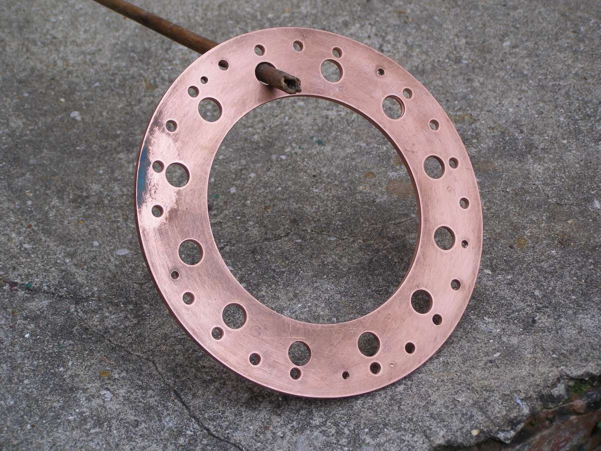

                      The second photograph is what I have just made with it: the ring to support the bottom of the cladding on my boiler’s firebox. Outside Diameter 8.25 inches, diameter over cladding 8 inches.
                      The inner firebox protrudes below the foundation-ring and that will nest in the big central hole; with the ashpan roof up against the whole caboodle . Apart from five tapped holes for stay-rods for other parts of the cladding, all those other holes are simply to reduce weight and heat transfer from the foundation-ting sitting on it. I may interpose a layer of thick gasket material to reduce that further. It is not secured to the boiler itself.
                      Having gone to all that effort, I do wonder if I over-complified it, but my first attempt, a spun flanged ring in 1mm thick sheet steel, looks too flimsy. Unless I am worrying too much about that. It’s hardly going to take a heavy load.
                      Cladding this boiler is turning out far harder than I had imagined due to its peculiar shape!
                      Nest task is to make new chassis mounting brackets and retainers for the boiler, partly to tidy up the many alterations / unforeseen-problem work-rounds to the existing ones, but mainly so they can be removed with the clad boiler from the chassis; in which operation they will have a dual role as part of the Lifting-Equipment, Special-to-Purpose, this boiler needs.

                          I took that photograph above just after deburring the ring with files and glass-paper. I only removed raised burrs and rounded the edges, as it does not need a fine finish – it will be hidden. The condition were early evening daylight under heavy overcast, so I let the camera decide the exposure for itself, but it does show the coppery tint.
                          The dark patch is verdigris confined to a very small area of the stock plate, probably from standing on a slightly damp floor and perhaps in contact with some other metal.
                          So I suspect this must be closer to the 95/5 proportions than some other versions.
                          The Wikiedia description has suggested an idea to me – that of the alloy being used as a silversmithing training material. I have a friend who does make jewellery as a hobby so I might take him a sample and see if he’s come across anything like it.

                                    Given the volume of the finished part a pair of kitchen scales would probably be sufficient to weigh it.
                                    The difference between it being brass or copper is around 40grams so a big enough difference to see.
                                    Better still measure the rest of the sheet and work out it’s volume and then weigh it, the bigger the sample the larger the difference in weight which will be easier to see.
                                    Regarding wasting material that was if you were going to make up 1cm3 samples. Buy working out the volume of what you have that is not needed.
                                    #747584
                                    Nigel Graham 2
                                      @nigelgraham2
                                      Looking at your figures above, I doubt I could weigh the machined ring accurately enough for that, i.e. to tenths of a gram… Not on my kitchen scales though. They are a simple beam balance whose smallest loose weight is 1/2 oz.
                                      I could try the stock sheets though, using the workshop hoist, my spring balance and a cat’s-cradle of that Physics Laboratory essential, the “light inextensible string”.
                                      This balance is the type intended for parcels, baggage and the biggest one that nearly got away, so quite coarse (for coarse fishing?), with a range of 22kg X 0.25kg and no obvious way to set the needle to 0.
                                      The metal is pretty obviously not “ordinary” brass. If it’s gilding metal that 0.12g / cm^3 difference from copper may not be enough to show with the balances I have; but I can at least try it.
                                      This does remind me I have long wondered how to weigh the wagon itself. Short of waiting until it’s complete then loading it into my car and taking it to a weighbridge – but any weighbridges anywhere near me are private, and since they are for laden HGVs anyway I doubt it would barely register.

                                        You missed the point of my post above, 0.1g may be hard to measure on a small sample 1cm3 but you have a ring that is far larger so the difference is larger and easier to measure with equipment that does not resolve to such small increments.
                                        #747630
                                        Nigel Graham 2
                                          @nigelgraham2
                                          I haven’t missed your point, Jason.
                                          The finest I can weigh anything to, is 0.25kg, and rather uncertainly, on a simple domestic spring balance intended only for tasks like weighing a parcel for posting. It is even labelled as “Not legal for trade”.
                                          The sheets of the metal are much bigger and heavier than the ring, and plain rectangles certainly easier to measure for volume than the ring, so might give results that mean something, though only approximately. I do not for example, know if the accuracy of that spring-balance is linear across its full range, and enough for a test like.
                                          #747848
                                          Nigel Graham 2
                                            @nigelgraham2
                                            I took up the challenge, weighing and measuring the three stock plates and the ring; all 22’6kg of it.
                                            Calculating the volume of metal in the ring was rather laborious, with all those ‘oles – five separate values to determine!
                                            Anyway, the result I obtained was 8.53gm/cm^3.
                                            Which seems rather light, against your figures. It doesn’t seem to match anything in Model Engineer’s Handbook, although that shows 60/40 brass is less dense still. The table does not list gilding metal.
                                            So I probably had transcribed the original, now unreadable label already on it; but given the impossibility of weighing these plates very accurately, having to average widths across sawn sheets, and rounding errors I would not be surprised if that figure is plus or minus 0.2 wrong.
                                            So what exactly this stuff is, remains a mystery.
                                            #747894
                                              Well done! Though the answer isn’t confirmed yet, 8.53g per cubic centimetre is correct for 60:40 Brass.
                                              Gilding Metal (10% Zinc) has a density of 8.75g per cubic centimetre, suggesting Nigel has one of the Brasses containing more rather than less Zinc.   Not Cartridge Brass, Tombac, or Gilding Metal.   A more accurate density measurement would reduce the uncertainty considerably.
                                              To get closer, it’s necessary to refine the measurement:
                                              • Measure the volume by displacing water rather than doing sums on dimensions:  the latter is error prone unless the shape is very simple.
                                              • Invest in, or make, a better set of scales.  Making them isn’t that difficult, but if I didn’t already own one, I’d head for the kitchen section of my local supermarket.
                                              A chemical or spectroscopic analysis is needed to nail what it is for certain –  8.53g per cubic centimetre is about right for Aluminium Bronze, Nichrome and a few other candidates.

                                                  Dave –
                                                  I’d be surprised if a kitchen balance or bathroom scales from a supermarket would be of any finer resolution than my parcel-weigher, unless an electronic type perhaps limited in resolution only by the display’s significant-figures’ setting. At least there’d be no trying to estimate the pointer’s position between divisions.
                                                  It might be more difficult to measure the displaced water’s volume than the metal’s mass, unless I weigh the water. Errr, what do I use for the displacement can. Perhaps the steam-wagon’s own water-tank using the hand-pump outlet, just below the top, as the overflow!
                                                  Potentially the most accurate form of balance while also the easiest to make, is the steel-yard. Neglecting its own weight, when suspended, is the load on the suspension always twice the object mass, or the object mass plus reference mass?
                                                  I experimented with that Salter Dynamometer as spring-balance, up to 10cwt capacity, to weigh the wagon so far. It proved nearly 2cwt already. I estimate full working order weight will be 3-4cwt, and me perched on it will add another hundredweight and a bit. Scaled up to a ton and a half – at least I am well under maximum load!

                                                    My balance type kitchen scales read to 10g divisions that are big enough to split further which is better than your spring balance hence why I said it should be possible with a kitchen scale and they are not digital ones which will read to 1g.
                                                    Easiest way is a simple suspended bar with the ring hanging X distance from the pivot and then just use a known weight that can be moved along the other side of the bar until it balances and measure it’s distance from the pivot. Then just a bit of maths to work out the missing weight of the disc. I have used this to work out postage on heavy castings that were too much for the scales I have

                                                      I fear we’re all guilty of not reading earlier posts, or at least failing to take the information in!  Same applies to the video I attached, which covers various ways of measuring displaced water that Nigel hasn’t thought of yet. He hasn’t had his Eureka moment!
                                                      I’ve committed at least two misreadings.   I missed that Nigel was using a Parcel-weigher, which should be fine.   More important, I forgot Nigel told us right at the beginning that:
                                                      It still had a label telling me what it is, and that is now illegible, but must have described it as “CZ121” as I wrote that on the metal with a felt-tip pen.
                                                      I was told this is “Gilding Metal” – a type of brass but with a very low zinc proportion, though still not advisable for boiler-making.
                                                      I think we’ve all been derailed by whatever clown told Nigel that CZ121 is Gilding Metal!   It’s not: CZ121 is close to 60:40 Brass plus about 2% Lead to improve machinability.
                                                      The evidence that the plate is CZ121 Brass consists of:
                                                      • being labelled CZ121
                                                      • colour inconsistent with Gilding Metal, which is very yellow
                                                      • Density of plate measured at 8.53g/cubic centimetre.  CZ121 is 8.47g/cubic centimetre, close!
                                                      I’d bet money it’s CZ121!
