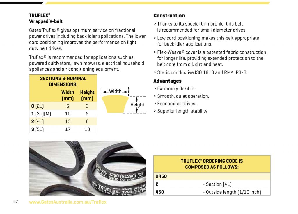

        Time for Vee belt change on my Centec 2B with vertical head.
        Two questions though; can someone shed some light here?
        1) Motor to gearbox has 2 belts, in parallel, and they say "Gates Truflex 2680 Made in Canada X 3" Any idea what the "X 3" means?
        I presume that if I purchase 2 at the same time that they should be the same length, or at least close enough for what I'm doing with my mill.
        2) From my measurements, the gearbox to vertical head is 29 inches long standard vee belt, section "2" or "4L" (I assume the same, just different nomenclature). No writing on the belt.
        As things are mail-order, or order-in-with-restocking-charge, I'd like to try and get this right first time.

                      Clive Foster
                        @clivefoster55965
                        TruFlex seems to be the Gates name for light duty, low stretch belts designed for smooth power transmission during start-up. L series belts. Close to A size but skinner and, usually, sized by outside diameter in inches. Its an American thing. 2860 doesn't seem to come up on the search. I'd guess the 3 means its a 3L.
                        The X suffix generally means a cogged belt where the inner part is in small sections separated by V shape cut outs. The cogging lets the belt run round smaller pulleys without loosing wrap angle. It also lets it settle into the pulley grooves better as it engages and grips a small section at a time. Uncogged belts are influenced by the straight run before engagement so drive take up and rection to load changes isn't quite as smooth. Cogged belt banding is usually more flexible too. Cogged belts are in herently alittle more prone to stretch and wear so good quality makers take steps to alleviate this.

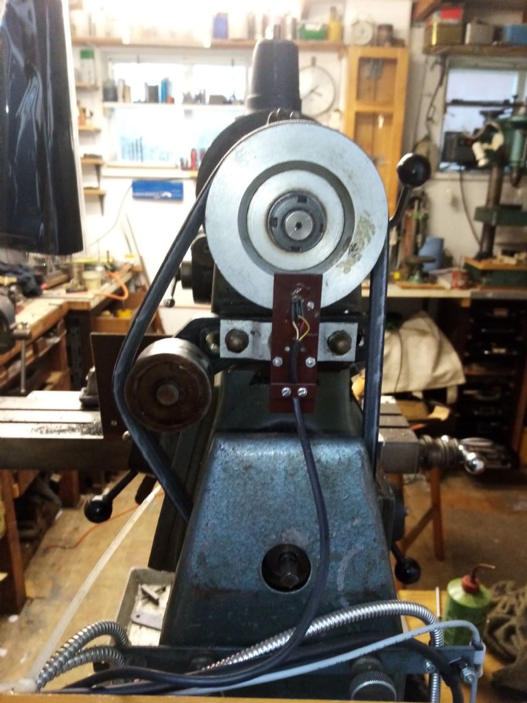

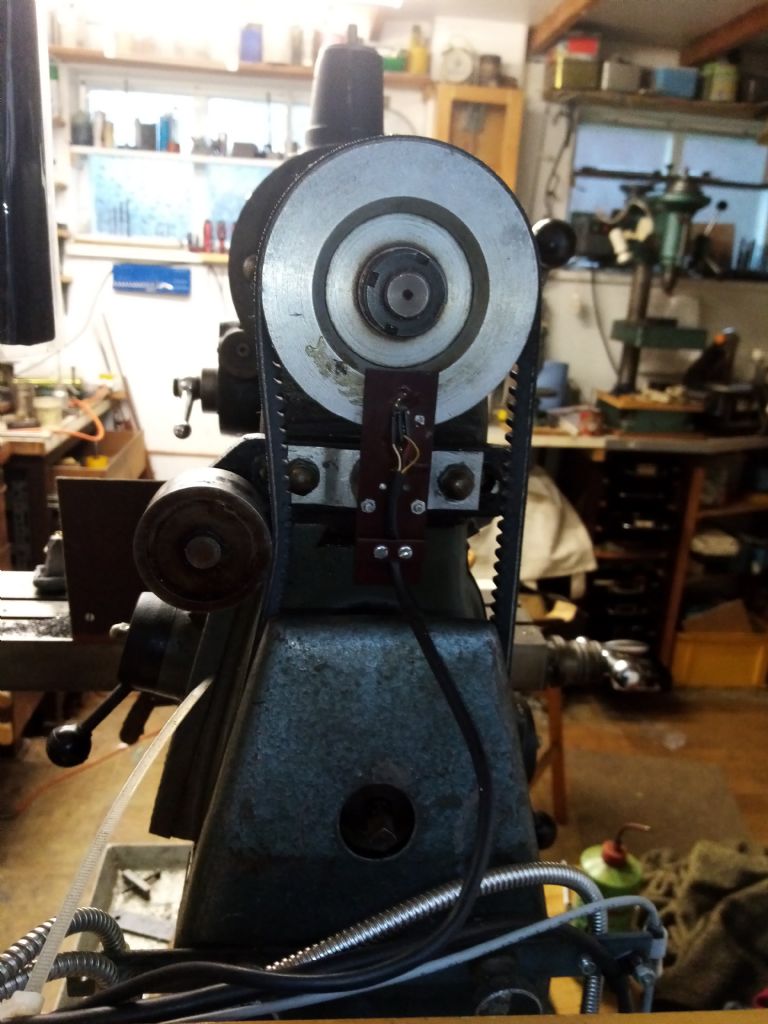

                            #575416
                            duncan webster 1
                              @duncanwebster1
                              sent the vertical head belt to the supplier for replacement, he sent A26.5, but it was too long to allow the idler on the outside. I've now got AX26, which fits much more nicely, just as original. I got AX as they are a tad more flexible. It just needed light persuasion to get it on

                              #575419
                              Howard Lewis
                                @howardlewis46836
                                better to run withb the idler on the back of the belt.
                                1 It runs on a flat surface
                                2 The angle of wrap around the pulleys is greater,and tends to press the belt into the groove, rather than out of it, Meaning that, in extremis, more power can be transmitted.
                                Howard

                                  Duncan – I like the inside belt – it does make things look neater.
                                  Thanks for all the help with my Centec. I did get the 29 inch belt in place; on my machine, the top pulley is a bit "wonky" (it wobbles a bit, I think it needs re-bored or replaced – so far I've lived with it) – when I get around to it, I'll get the 26AX as you did.

                                    #575472
                                    duncan webster 1
                                      @duncanwebster1
                                      Posted by John Alexander Stewart on 14/12/2021 19:23:25:
                                      … the top pulley is a bit "wonky" (it wobbles a bit, I think it needs re-bored or replaced – so far I've lived with it) – …..
                                      John.
                                      If you do have the pulley off, drill a blind hole and bury a magnet in it, then you can have a pickup for a tacho, that rather nasty brown thing. It's crude but it works
