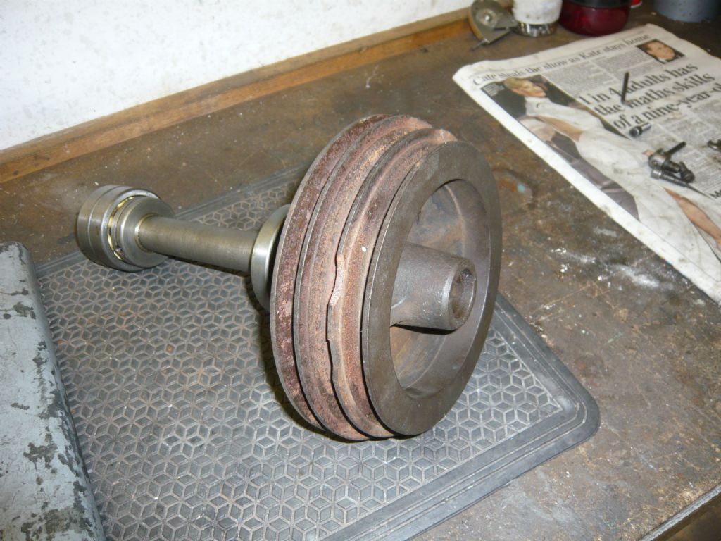

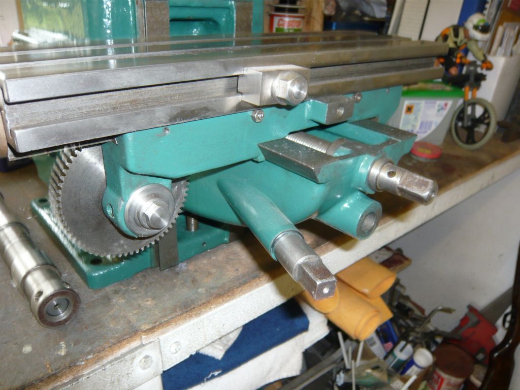

          Posted by Alan Jackson on 01/11/2019 16:26:59:
          p1040430.jpgp1030684.jpgI had an Ajax mill like yours and rebuilt it. The existing pulley had lumps broken from it by the previous owner so I machined the pulley down for polyvee belts. I also repositioned the vertical feed shaft so that it could be fitted with a handwheel.
          Edited By Alan Jackson on 01/11/2019 16:29:37
          Thanks for posting the photos – it's nice to see other examples of this (and similar) mills to see what others have done. The motor pulley was in poor condition on my machine but that was easily replaced and the others are all in good condition. I think the jury's out on whether it would be worth my while changing to poly-v belts and I should try different cutters / lower spindle speed first.
          Out of curiousity, did you have a quick return lever on your machine? Mine was missing the lever and I machined a replacement but haven't really found it necessary. I see you have a t-nut / stop mounted to the front of the table – was this for a power feed add on or simply to limit travel?

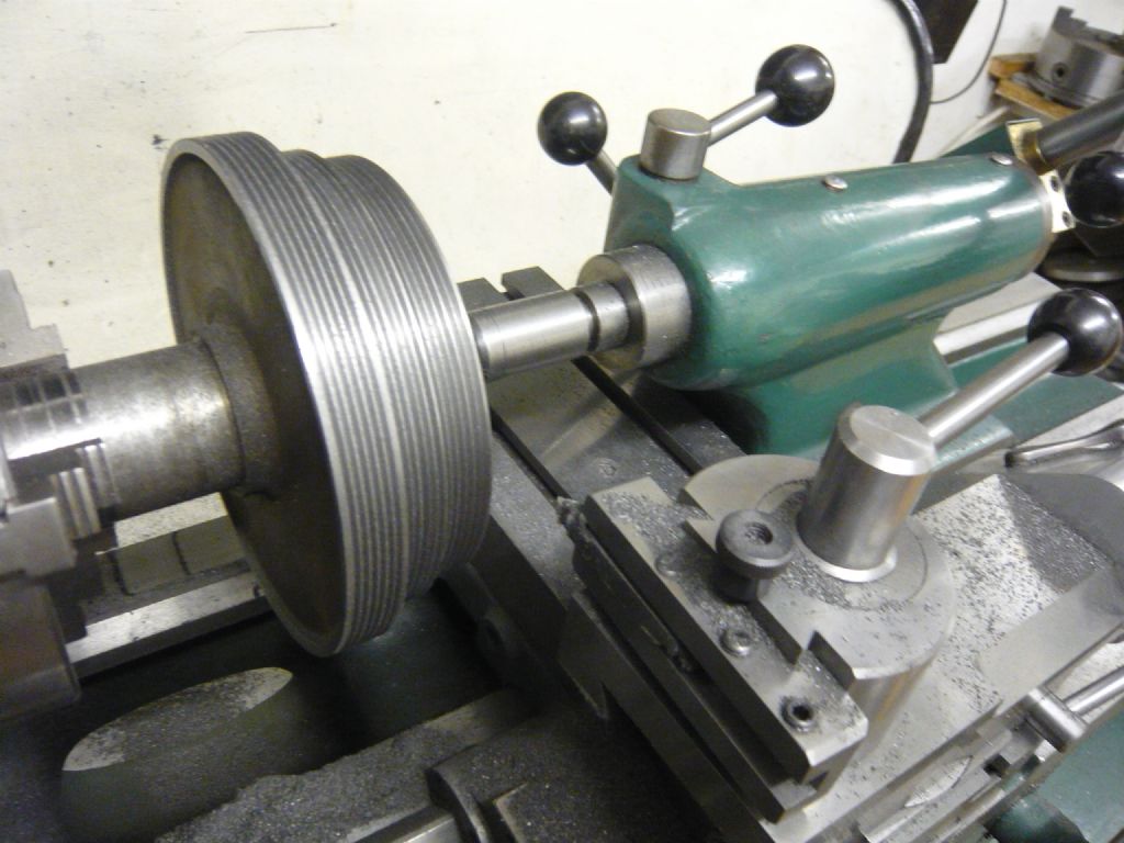

                                  I know it has been some while since I last posted to this thread, but I thought it might be useful giving a quick update. Firstly, I should point out the machine has not seen much use over recent months due to other projects, family and work commitments.
                                  In the last week or so I finally got around to changing the single-phase drive for a 0.55 kW 8-pole 3-phase motor. I already had a spare VFD and knew this would give me the option to reduce spindle speed without replacing the existing v-belt pulleys. Selecting an 8-pole motor bumped the price up somewhat (cost me more than the milling machine) but gives a motor speed of 680 RPM at 50 Hz and a spindle speed of around 60 RPM. It gives a very smooth and slick performance.
                                  The motor performs very well from 20 Hz to 60 Hz (I haven't tried outside this range) and has absolutely transformed the ability of this machine. I have taken a few test cuts of mild steel with a 5" cutter and it is now a pleasure to use. The machine now sounds right when cutting and belt vibration is no longer apparent. It's still not a heavy duty machine but absolutely fine for my needs.
                                  The motor should be okay up to 75 Hz (1020 RPM) so that will give me some flexibility when using smaller cutters or when machining aluminium.
                                  I hope that is of interest to someone.
