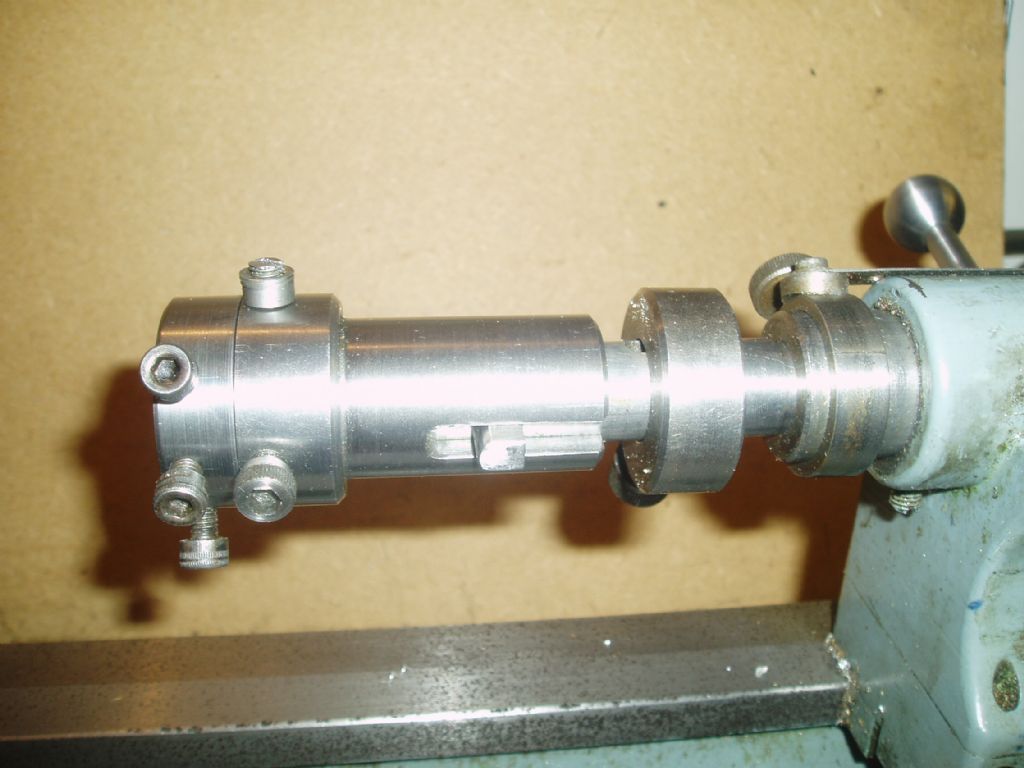

                  #95195
                  Nobby
                    @nobby
                    Hi Guys & Falco
                    One of these would help when cutting thread in the lathe.this one is sprung loaded for safety
                    Regards Nobby
                    Sprung loaded mandrel  handle

                                                  When making long threaded lengths with a die it is important to keep the die square to the shaft. That can be difficult with a handheld die holder, you can use the tailstock but íf you do that with too great pressure the die is forced to much which gives a ugly thread. A tailstock die holder keeps its square and eliminates that problem, but if do not have a tailstock holder you can use a handheld one with a special made guide. The guide starts with a hole that slides accurate over the shaft, than follows the die and this is than fitted in a normal handheld holder, the guide centres on the not yet threaded part of the shaft and keeps it very accurate square.
                                                  #95404
                                                  Nobby
                                                    @nobby
                                                    HI Guys
                                                    One of these Niko refers to
                                                    #95432
