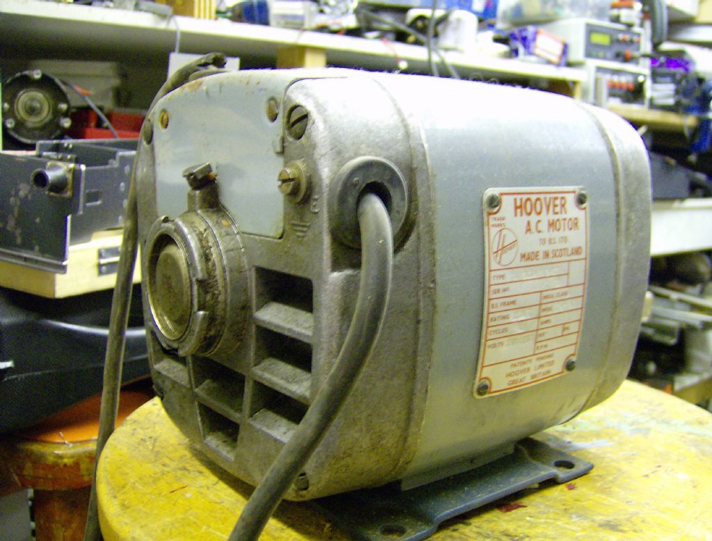

                                  I’m feeling more cheerful now, especially touched by Cornish Jack’s offer. Sadly I don’t know where Spixworth is, I’m near Burton upon Trent!
                                  No matter, rather than moping and feeling sorry for myself I should use some Model Engineer’s ingenuity and take up a few of your suggestions.
                                  I was given a Hoover fractional motor by a colleague (our former book-keeper Roger, who used to work with electric motors – as in ones the size of cars) a year or two ago; I’ll go and dig it out. If I make my countershaft bracket on the mill and bodge/get a pair of 3-2-1 pulleys, with the 2:1 gear built into the mini lathe I should get a reasonable range of speeds .
                                  And as Guy at work pointed out, if I lurk around Ebay for a while there’s agood chance of getting a deal on a motor and/or inverter in due course.

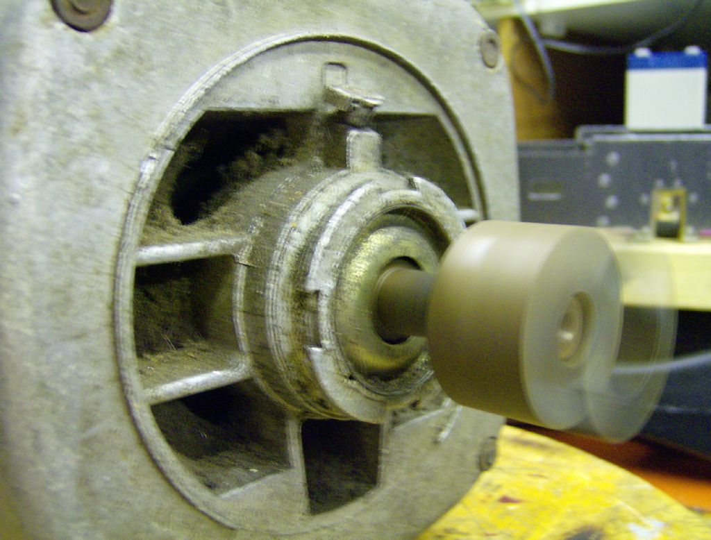

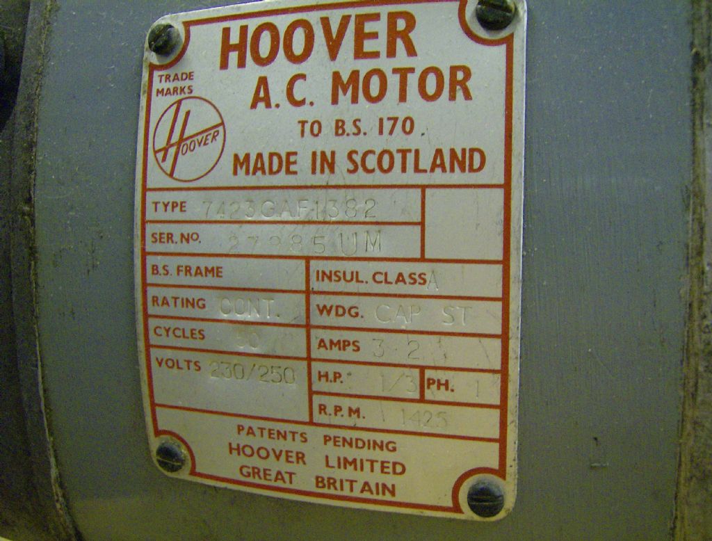

                                        I’ve just tried out Roger’s motor (photos below).
                                        It is quite lovely, I popped a few drops of 3-in-1 in the oil cups(!) on each end bearing, and fitted a plug. I was wary of the external capacitor which looks victorian and the lack of earth.
                                        I read the resitance across L and N as 8 ohms, which seems about right, and the earth to live was over 2 megaohms (the max my DVM goes up to, so I switched on.
                                        It made a scary click (I realised this must be a centrifugal switch) then it hummed quietly and without any sign of vibration. I ran it for several minutes, switched off and it slowly ran down, and the centrifugal switch tripped out just before it stopped.
                                        The wires look like they could do with replacing (and an earth would be nice) but I am happy that I should be able to do something with this. I can’t think how I forgot this motor – thanks Roger!
                                        Finally this is the sort of thing I was facing off when the motor blew, but not a finishing cut I was winding the handle as fast as it would go without slowing the work down. Tempting to say this is how pins are made…

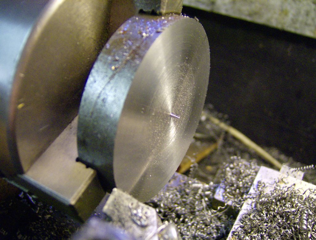

                                            The tangential tool is a homebrew one:
                                            I haven’t finished drawing it yet.

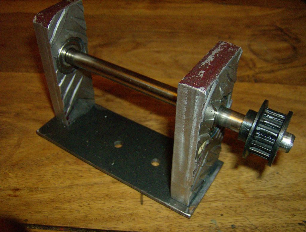

                                              Sub Mandrel
                                                @submandrel
                                                Hi AES,
                                                Finances dictate it will be the new year for a 3-opahse motor, but I think I’d raher go down that route and have something I can expect to last a few decades, rather than a few years. The mini lathe is quite capable of decent cuts and big workpieces that the motor, in all honesty, is not up to handling.
                                                In the short term I’ve made a countershaft which will let me use the old hoover fractional (see above). All I need to do is bodge up a pair of pulleys now:
                                                OK it looks a bit rough , but I’m in a hurry! Luckily my Mill is OK so I tidied up some edges on a couple of bits of thick checker plate and bored out some housings. I have to cut a keyway for the toothed wheel.
                                                Unfortunately without the lathe I had to drill out the wheel so it wobble a bit, but once the lathe is working I can make some proper pulleys and a replacement toothed wheel.
                                                When I get a 3 phase motor, it can be a drop in replacement for the single phase one.
