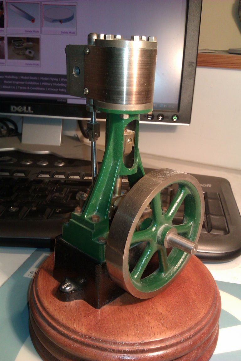

                                    The Unimat 3 can be very accurate, I have made a 40.000mm quill to upgrade the vertical milling to tapered bearings, I have used it to make master patterns for Matchbox and Corgi, its accuracy was always great. I have upgraded the motors to a 0.5kw DC for main, and a 0.3KW 3 phase with controller on each motor, with reverse. Takes a 1" brass bar down to 0.5" in one pass, the Myford doth protest when I try it on that !!

                                        Heartily agree – absolutely nothing wrong with a U3 and well capable of more than clock making.
                                        Jason's engine as above is proof of what it can do
