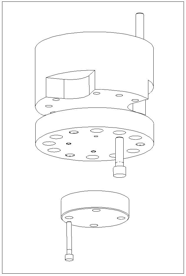

          A BIG thank you to Robin regarding this problem of mine. Not only did he provide a more than adequate lathe, he provided tea, biccies and toilet facilities over 2 days for me and my pal, Alan.
          An altogether fine fellow MUCH appreciated Robinsmile
          Just got to work out how to mill the pockets with the Mill in bits nowlaugh
          Thanks all
          #491506
          Gary Wooding
            @garywooding25363

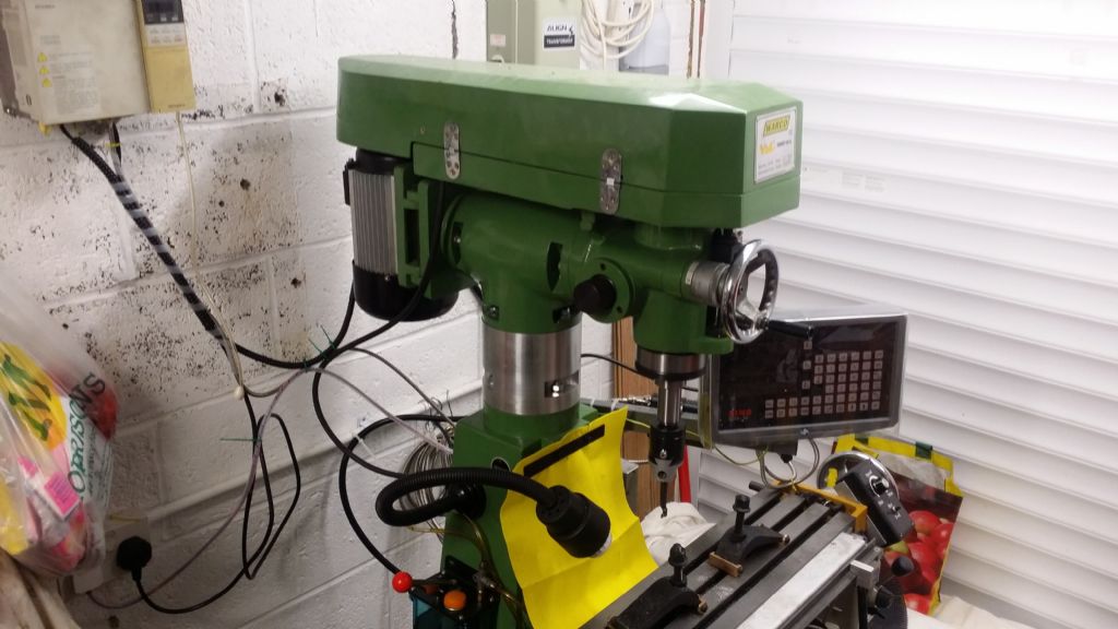

            When I made this one for a friend I made it in two parts that could be bolted together after the pockets had been milled.
