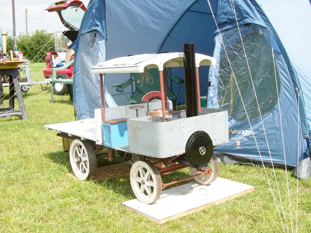

The wheel you drew is pretty well as mine. The plates converge rather than diverge towards the rim but that's unimportant here. It is just a matter of forming them "up" instead of "down". The construction of the individual plate on the drawing would otherwise be the same.
[To make the real plates, I used the 3/16" holes they have all round the rim between the piercings and the edge. In time these will hold rivets (or slotless screws and domed nuts). I made a heavy steel plate disc with corresponding 2BA holes, and a central hole that held the hub. I screwed the pierced plate to the hub by the holes you show, located that on the jig then carefully, systematically screwed the rim down by the appropriate amount. I must have had some arrangement for depth control but I forget what! I tack welded the rolled strip flanges on, then removed the plate from the jig for full welding, on the outside so I could clean the joint and the weld would be hidden on full assembly. The lack of an internal fillet – the pressing radius on the full-size – is not particularly noticeable. The steel tyres – and the smokebox – are actually slices cut from pipeline scraps, so the front wheels are a little under-scale but not too seriously – the archive photos show many detail differences between specimens anyway! ]

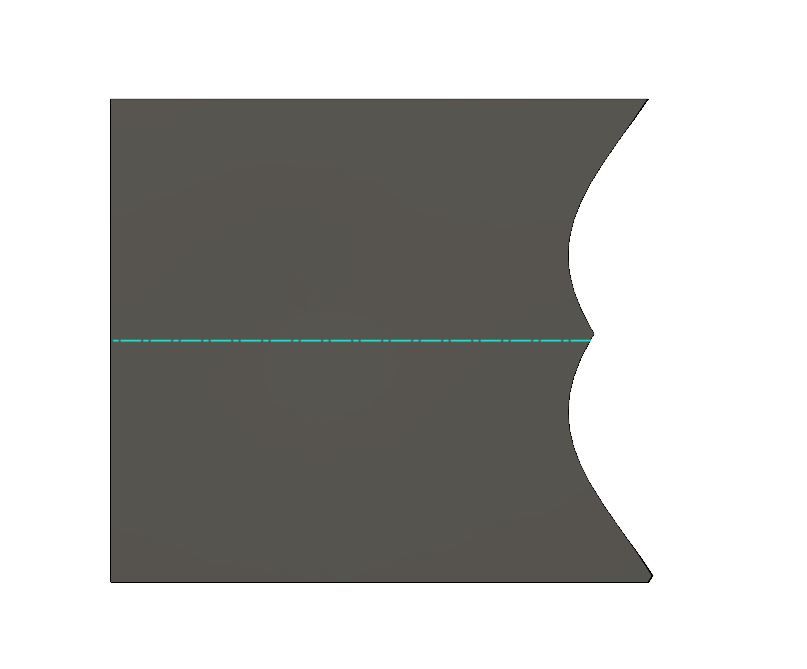

Laying out the initial 1" spaced lines, I would just draw one, select it and then do a linear pattern at 1/2" or 1" spacing If I wanted guide lines though they are nor often needed in Alibre or could have turned on snap to grid if needed.
Not sure how easy it would be to make alterations to say crank throw, Would all those individual lines need altering one at a time or how easy it is to go back through the various stages but in the likes of Alibre I would just need to select that initial sketch of the crank pin and enter a new value for it's distance from ctr and click return. Every other operation will then alter by itself.
Triming lines and tangents. I also noticed this with MOI having to do radial lines to get an intersection to a tangental line to define the point to trim the excess is not needed in Alibre of F360. They put a node for want of a better word where the line tangents the circle so the point the excess is trimmed to is automatically put there for you.
Joining up the shapes at the end, Alibre treats it as a single part so no need to do this which could get very complicated with more complex parts.

I noticed you used the revolve tool (I may have mis-remembered the name, but it was a bit difficult to read anyway) to make the hub from a rectilinear figure. Are the dimensions active, so typing the value into the little box makes the line that size? I assume on the dimensioned views, there is a way to ensure the dimensions use consistent datum points and directions?
Yes I like that over MOI and TC shown here where you have to go to a box, click the box, delete or highlight what is there and then type a value. Alibre just pops up the box with the active length of a line or dia of a circle and you simply type in the number
When producing the 2Ddrawings there is an option to use all dimensions from the model but unless you are very particular whare they are placed at that stage it can look a bit messy. I prefer to lay out my dimensions neatly on teh 2D drawing picking datums etc and it will just pick up the sizes from the 3D model
The assembling looked confusing but I did spot the use of the stud-holes on the wheels as alignment points. That's a neat way to "drill" the holes through – extrusions back through the solid, as if of negative lengths.
Most cad packages have all the extrude options which give a positive shape as "cut" as well which removes rather than adds and is very common. I tend to do holes like that most of the time but there is a "hole" option which will for example show a drilled blind hole as having a conical bottom or size the hole to suit a thread eg it will put a 5mm hole for M6 and also put the thread call out on the 2D drawing

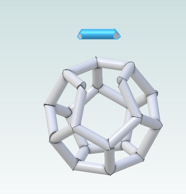

For Jason and others, I just wanted to clear the confusion that in MoI you have to access a box to enter values. This isn't usually the case, as I show in this updated video. It's also not necessary to "…do radial lines to get an intersection to a tangental line to define the point to trim the excess…", so I show another way in this video of a five bearing, fully filleted and chamfered crankshaft – all in less than 7 minutes.
Please forgive the faffing about, where I'm drawing the first main bearing near the beginning of the video.
Martin.

I would do something similar in Design Spark Mechanical. I can't recommend DS at the moment because it seems that RS components who supply DS (free), are going to turn it into a subscription only package, similar to Fusion 360. I don't know if it will be cloud based or not.
I might get back into FreeCAD. I used it for a year or two before switching to DS. It falls short in certain areas, and the latest version won't run on two of my computers, including one that has win11, 16gb of memory with a 4gb graphics card and fast SSD. I use 0.19 which runs OK. And it's free, forever?
I found Andy's TC video fascinating. The workflow is very different from FreeCAD, MOI, Alibre, Fusion360, and Solid Edge. TC reminded me of the thought process needed to translate a 3D object into a 2D first or third angle projection, a method that might well appeal to a 2D draughtsman. Although I'm sure I could get used to it, the approach goes against the grain for me. It's not how I think.
FreeCAD and chums are more realistic in my mind, in that models are constructed by creating solid lumps and then shaping them by cutting and extruding. Solids are manipulated into shape, and only 'drawn' when the model is finished. Even more realistic when the software allows related parts to be assembled with working joints. This type of modelling is very like actual milling, turning, drilling and fitting, except there's less need to plan ahead because all operations are reversible.
