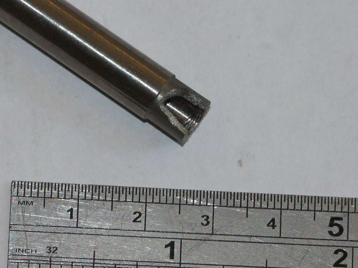

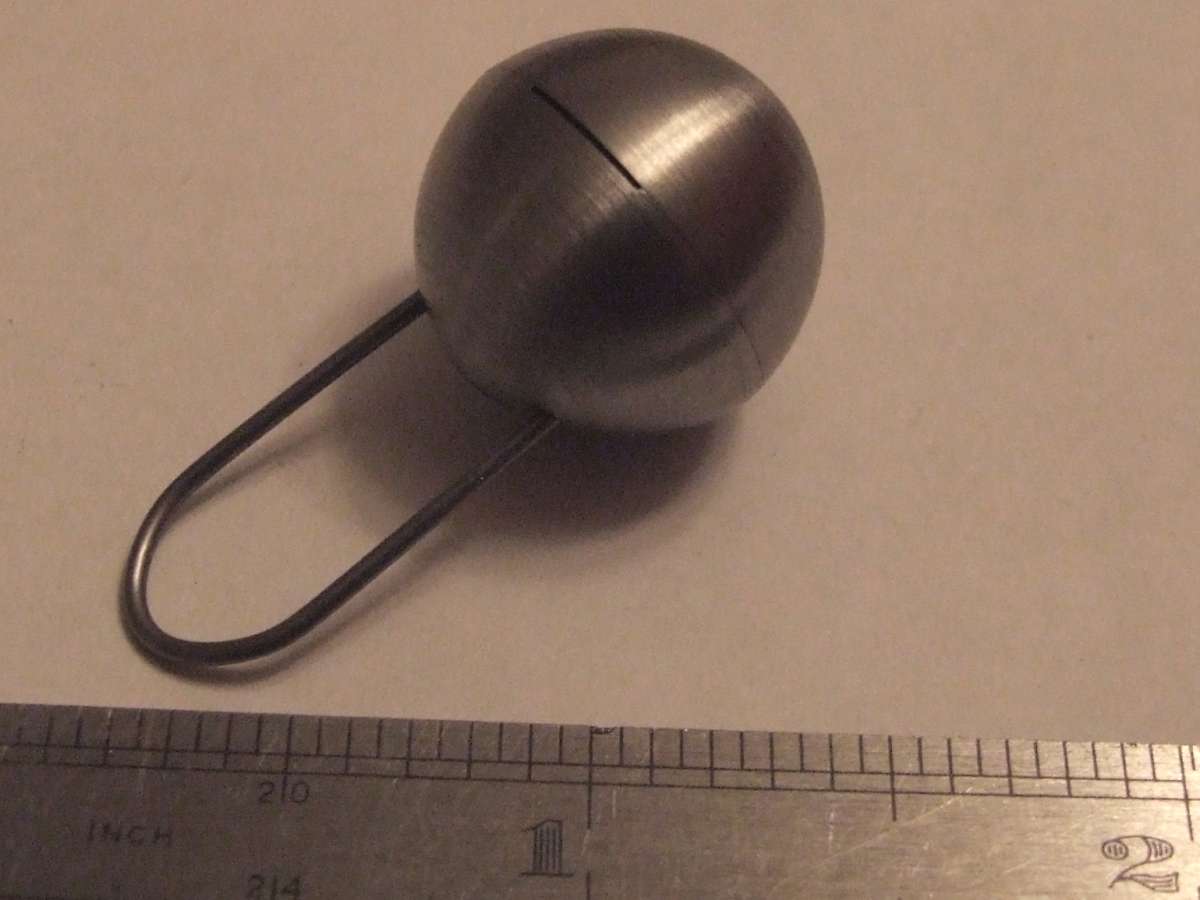

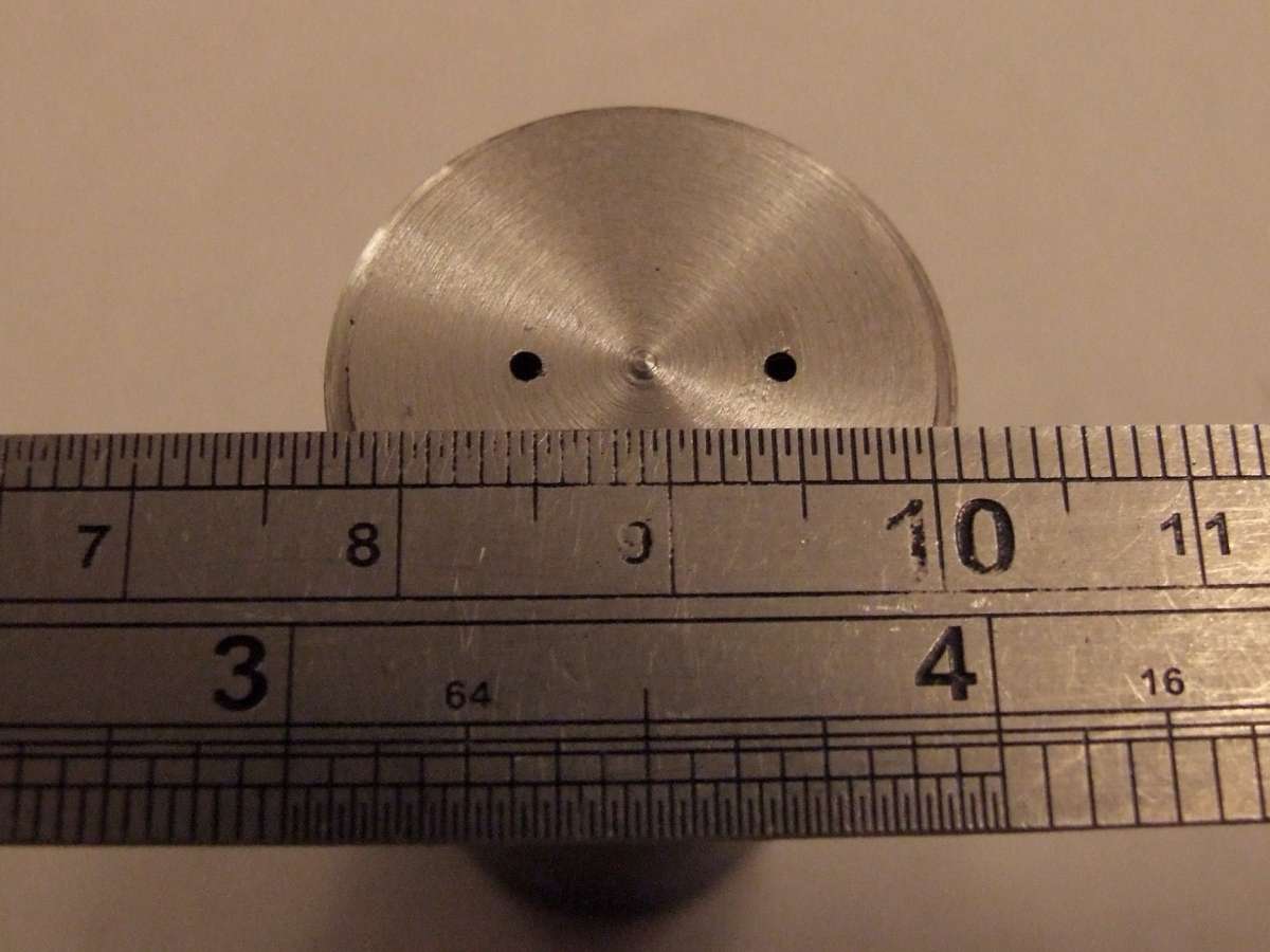

                  #734338
                  Anonymous
                    As stated above tungsten carbide is not homogeneous but consists of finely powdered tungsten carbide mixed with a binder, usually cobalt. The material is pressed and sintered to near final shape and then ground.
                    The same applies to ‘pure’ tungsten metal, it is a mix of tungsten powder and a binder. The material can be turned with carbide inserts and drilled with carbide drills. However, the material is very brittle. This is what happened when I tried to tap it:
                    2017_08120003
                    Normally ‘tungsten’ metal is an alloy with a few percent of other materials, often iron and nickel. These alloys are less brittle. Machining and drilling with carbide tooling is fairly straightforward. This is a cylinder turned and drilled 8mm deep with a 1.2mm carbide drill:
                    2017_09020001
                    The final application was a governor ball consisting of two hemispheres screwed together:
                    2017_09030009
                    While machining tungsten alloy is fine, tapping proved to be a nightmare. The alloys have a high tensile strength and close up on tap, locking it solid. I broke several taps, including ring taps specifically for high tensile materials, before discovering that my worn set of M4 Dormer hand taps worked best.
                    Tungsten alloys are available here:
                    https://www.smithmetal.com/tungsten-alloys.htm
                    But sit down and do up the seatbelt before asking the price. A good few years ago I asked Smith Metals for a price on a 10″ length of 7/8″ diameter tungsten alloy. Answer was around £600.
                    Andrew

                          #734376
                            Andrew
                            That ‘breakout’ of your tap is very interesting, and I’m sure it surprised and distressed you !
                            Without wishing to imply anything more than a morphological similarity, it looks like the Tungsten Alloy behaves rather like cast iron, but on a smaller scale.
                            It is good in compression, resistant to impact, and ‘tough’ [hence the use for bucking blocks] … but, we now see, fails in tension.
                            Every day is a SchoolDay … Thanks.

                                  Anonymous
                                    On Michael Gilligan Said:
                                    Andrew
                                    On the contrary I wasn’t surprised as material datasheets had warned that the material is brittle. Only the material broke, not the tap.
                                    I was annoyed when, in a later experiment, I broke a new ring tap.
                                    Andrew
