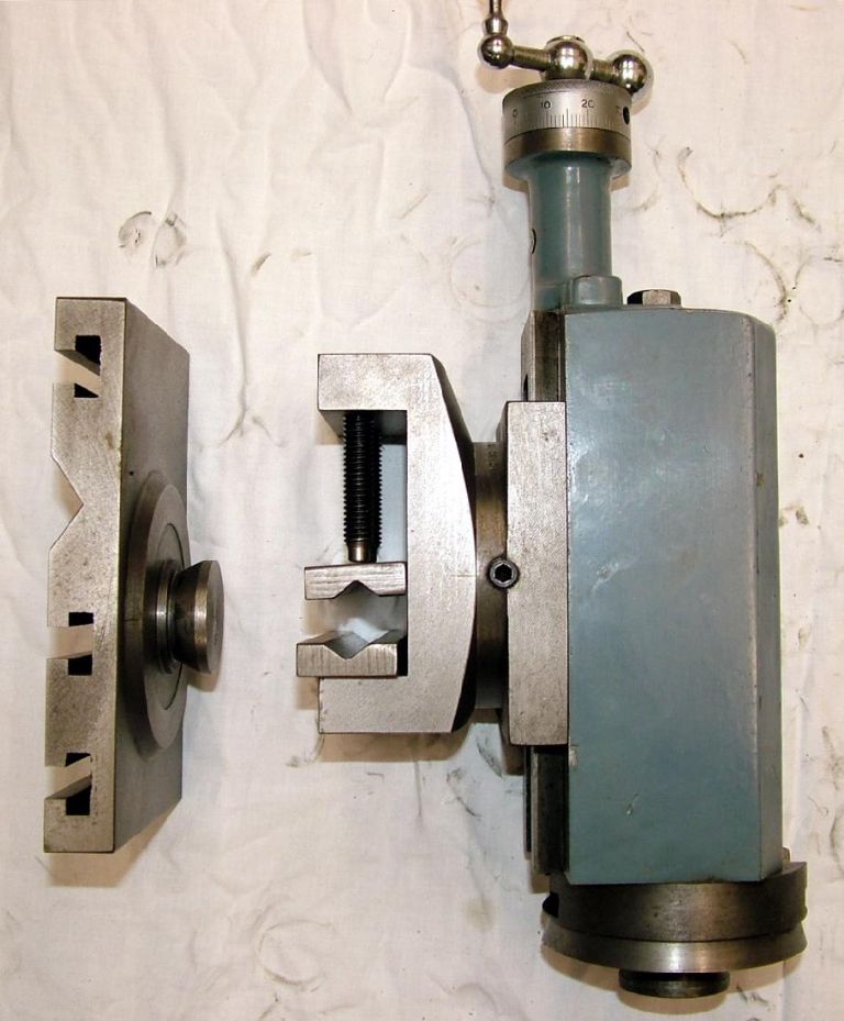

        I'm looking at ways of work holding on the topslide of my old Boxford CSB. For occasional light duty milling in ally or acetal. I need a machine vice for my pillar drill (lightweight DIY job nothing serious) so my thoughts are to buy one big enough to hold the work pieces for small milling jobs on the lathe too. I know I'll need a means to attach it to the top slide in place of the compound/taper slide. So presumably a suitable adapter with either an angle plate or flat plate with the appropriate tapped fixing holes. I did read a thread about making one but I don't have either the facilities or skill to do so. Can anybody suggest a reasonable cheaper alternative to a vertical slide (which is probably more than I want to pay for a few small jobs)? I don't mind workarounds to avoid the need for vertical adjustment.
        Finally, is it possible to remove the compound slide without removing the topslide or apron (and if so how)?

          You should be able to find a suitable milling adaptor on Ebay. A Myford one will also do with a little modification. It is really the best solution. You could at a pinch use a small vice attached to an angle plate but is not a good solution as you will probably need vertical adjustment. The compound is removed by undoing the 2 set screws in the cross slide.. They are set at an angle to each other. Once removed just pull the compound upwards to remove it.

              There is a small piece of metal rod under each screw. Remove the screw and Get some thin oil in there.

                I used a Myford VS when I first got my Boxford. I attached it using tee-nuts in the same way it would be attached to a Myford, but my Boxford has a tee-slotted cross-slide, which isn't universal. The Boxford VS has the tapered spigot so it drops in as a direct replacement for the top-slide. If you don't have a slotted cross-slide, adding a home-made spigot to the Myford VS might be the way to go.
                The Boxford VS, sometimes referred to as the milling attachment, is a considerably better job than the Myford, and comes with an integral vice as well as a table, which can also each be attached to the cross-slide. Might be worth looking for a used one, although they tend to be a bit spendy.

                  There's a used Boxford Vertical Slide on feebay just now, the starting price of £575 is indeed a bit spendy for my needs blush
                  My top slide does no have a tee slot but I had wondered if anybody makes a vertical adapter for the compound slide?

                      Posted by Sam Spoons on 06/06/2020 10:02:43:
                      That compound slide on Ebay is a very rare type, probably priced accordingly. This is the more common type that I was referring to, although they won't go cheap. Quite a bit more detail on Lathes.co.uk website.boxford v. slide.jpg
