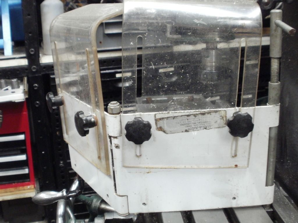

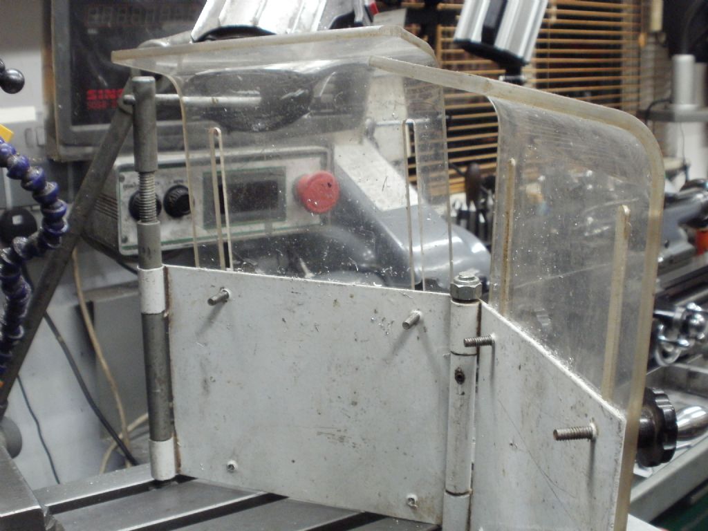

          #432595
          mechman48
            @mechman48
            I have used acrylic sheet on my WM16 which has done well to date, possibly change for polycarbonate when this arrangement gets too opaque to see…
            Original OEM guard…
            Guard mods #1
            Acrylic sheet formed to cover full table…
            Guard mods #4
            Held on with neodymium magnets attached to the angle brackets… bottom right corner
            Guard mods #5
            George.

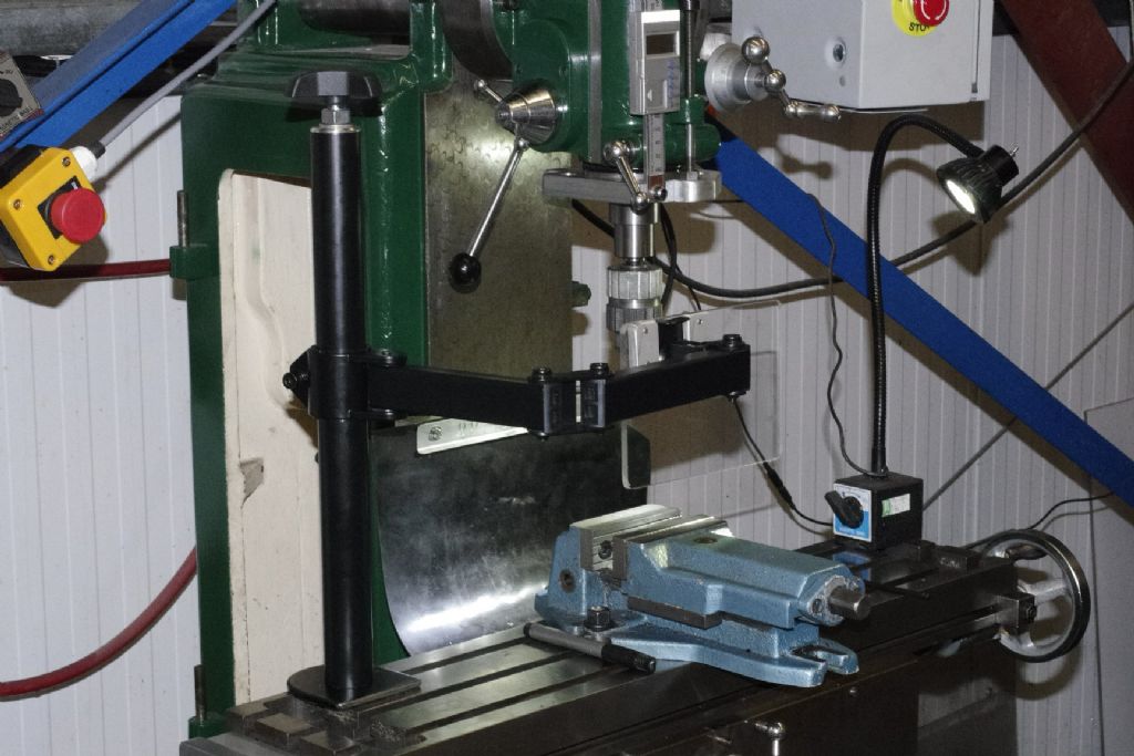

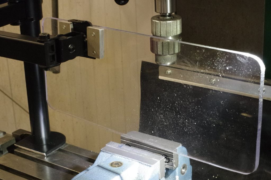

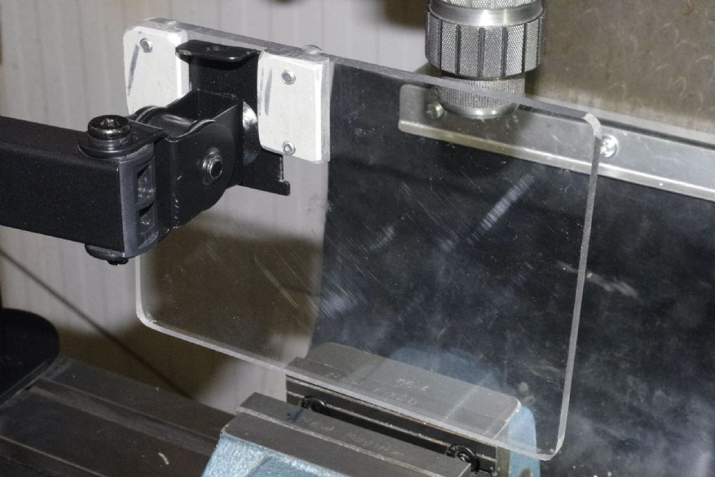

                        #439540
                        old mart
                          @oldmart
                          _igp2509.jpg_igp2508.jpg_igp2507.jpgWe made a cheap and cheerful guard which will do for most jobs, the 6mm polycarbonate guards are quick dedachable and can be bade any size and shape. The modified mount is for a pc monitor.
                          **LINK**

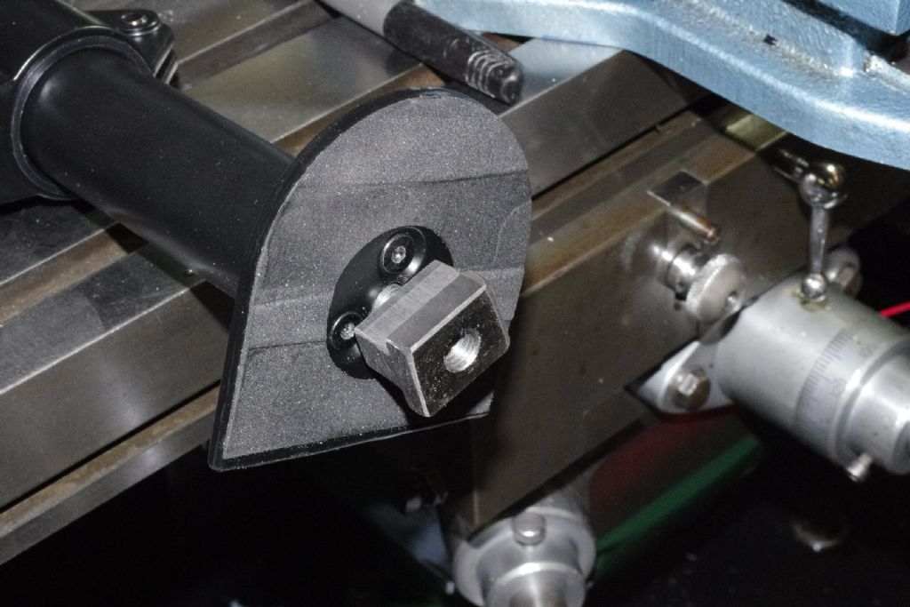

                          #439543
                          old mart
                            @oldmart
                            The original desk clamp screw is at the top of the column, connected to a 10mm tee nut in the table slots. With the extension on the left of the table for the X axis wheel, there are further opportunities to move the mount just off the end of the table. The mount fits just as easily at the right hand end of the table.
