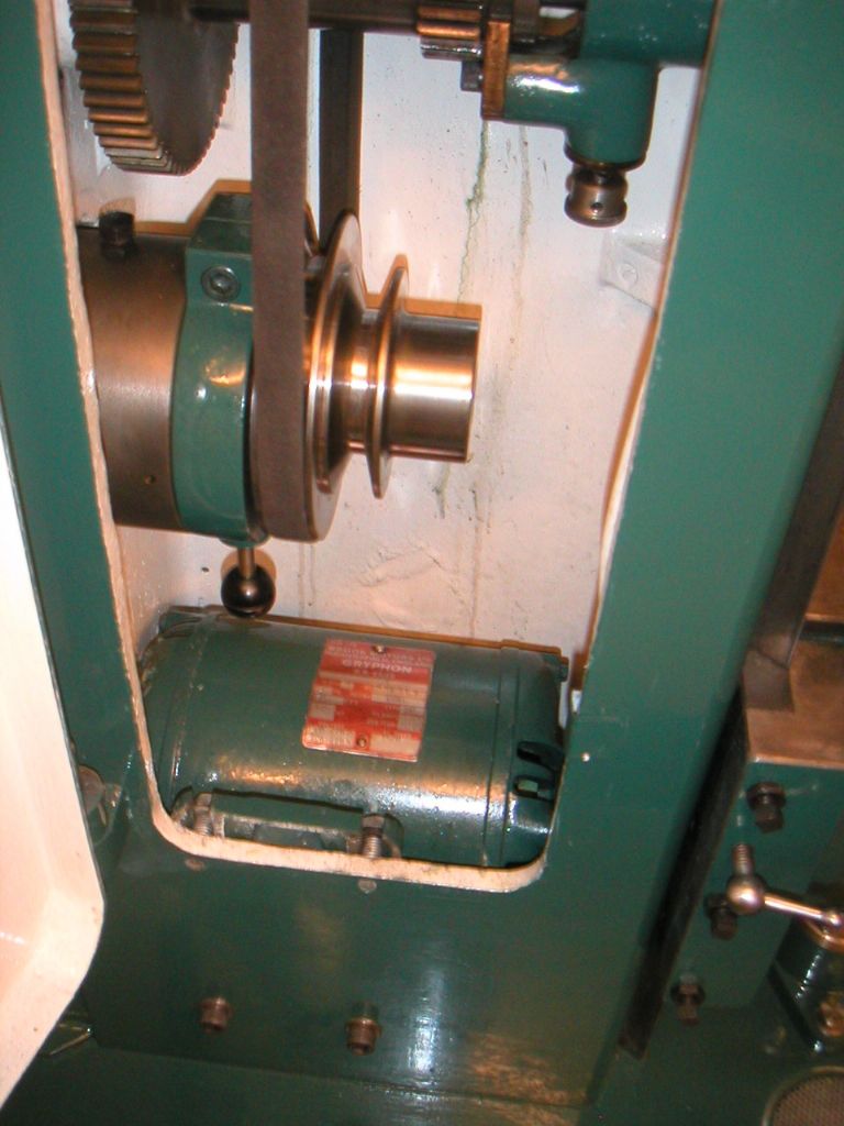

                Hello Alan … as a possessor of a Tom Senior M1 who was aiming to sell the machine (clearly the action of a yahoo) – I attempted to give heads up to the yahoo group only to find one needed to join to post such a message. Attempted – but refused. I suppose one, by intimating sale of the necessary to belong, debars oneself. Auto debarring seems my forte… The idea was that as I'm contemplating a move and all that entails, perhaps I could get something smaller. Anyway – smarting from the 'blow', I re-assessed and concluded there was nothing as versatile and/or I wanted, could afford or might have space/muscles for – – partly as a result of having seen your Dore Westbury tweak. In fact I did the same some years ago – but nowhere near as skillfully. 'Self assessment' – could have done better! So the upshot of the above is the resolve (as now retired) to renovate said M1 and vertical head – and not sell.
                The above images and tales of similar exploits are very useful and inspiring (as is the Stepper-Head Lathe – I bought the Compucut driver many years ago to make something similar as a means to cut complex decoration on ceramic items which were then fired. Now playing with this as a 'CNC version' of the Holtzapffel – bit mind boggling – just in process of cutting pattern on a six inch red clay sphere using two rotary axes. hmmm)
                One thing puzzling me on your Dore Westbury conversion is that there seems no motor to drive the horizontal axis. In my attempt to achieve the same whilst still driving the horizontal axis (i.e. keeping power feed) it was something of a squeeze to fit the mounting block for the vertical head and the motor drive to horizontal spindle – park the overhead bar etc (have you re-configured/shortened the rear hinged cover?). Often my solutions are driven by time, what is available in 'the heap' and need to arrive at working solutions so as to remain productive. Retirement has altered those constraints to a degree. I used some 240v DC servo motors to drive both vertical and horizontal heads having also the drives to hand. The caddisfly larva operates on similar principles i.e. stick together what is available.
                I noted on one post somewhere that a renovator of a Tom S M1 tigged up non-standard holes in the coolant tray – a laudable approach to 'originality' – a standard I would find hard to follow as I was wondering whether one could house the drive motor in the base – such action presumably needing new cutouts for the drive belt etc. (A drawer would be handy too)
                ANYWAY -Is that what you did in your nice Tom Senior rework re- drive motor for horizontal?
                Grateful for any info on that issue.
                Blake
                #262914
                Alan Jackson
                  @alanjackson47790
                  Hi Blake,
                  I hope this is not classed as an interference on this thread, but since you ask. I put the original motor inside the column. I cut an oval hole in the back of the column for the motor spindle and brought a new shorter vee belt. It works great, I have run it for long periods and it only gets slightly warm. This then frees up the top surface for the Dore Westbury head You can see more photos in my photos.
                  Alan

                    Hi Alan … interference might arise from my 'crossed threads' – but as they are all on the topic of TS related renovation/improvement projects I think my pitch a partial fit – and your response greatly appreciated. Damien – sorry if my post in your thread was impertinent/naughty or off piste so far as protocol goes – am a bit of a newbie at this so learning. Would it be more appropriate to start another thread? BTW lovely looking result on the Light vertical Mill. A standard to aim at! Great images.
                    Alan… that's another squeeze – and you cutting an oval hole makes me feel somewhat less guilty in contemplating similar 'non standard' major surgery. In accommodating the 2.25''dia. overarm bar by sliding fully back over the top of the belt guard did you alter/shorten that guard or import one off a LVM? In its present guise on mine I bought and fitted a shorter bar (still have the longer) that is 'out the way' of the vertical head and just touches the inside of the rear cover when parked.
                    When I said in the base – I should have said in the stand. Damien's excellent images lead me to wonder whether there is just enough room below the coolant 'tank' – but either possible housing, as opposed to atop the column, seems to need cuts/holes – + careful thought.

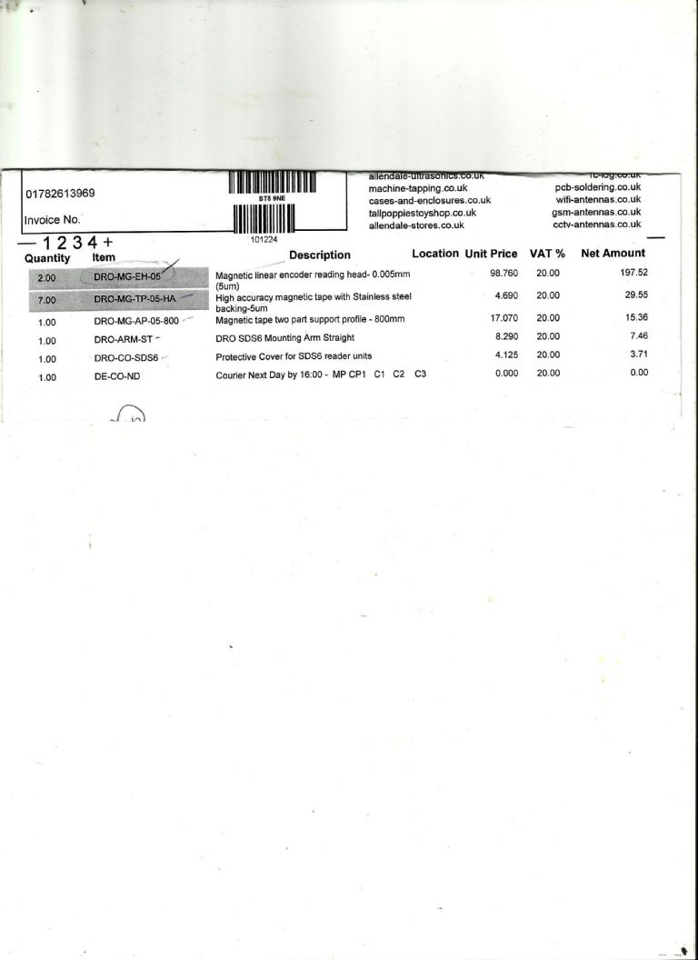

                                              Seems as though the prices from allendale have gone up quite a bit for their magnetic read heads sad
