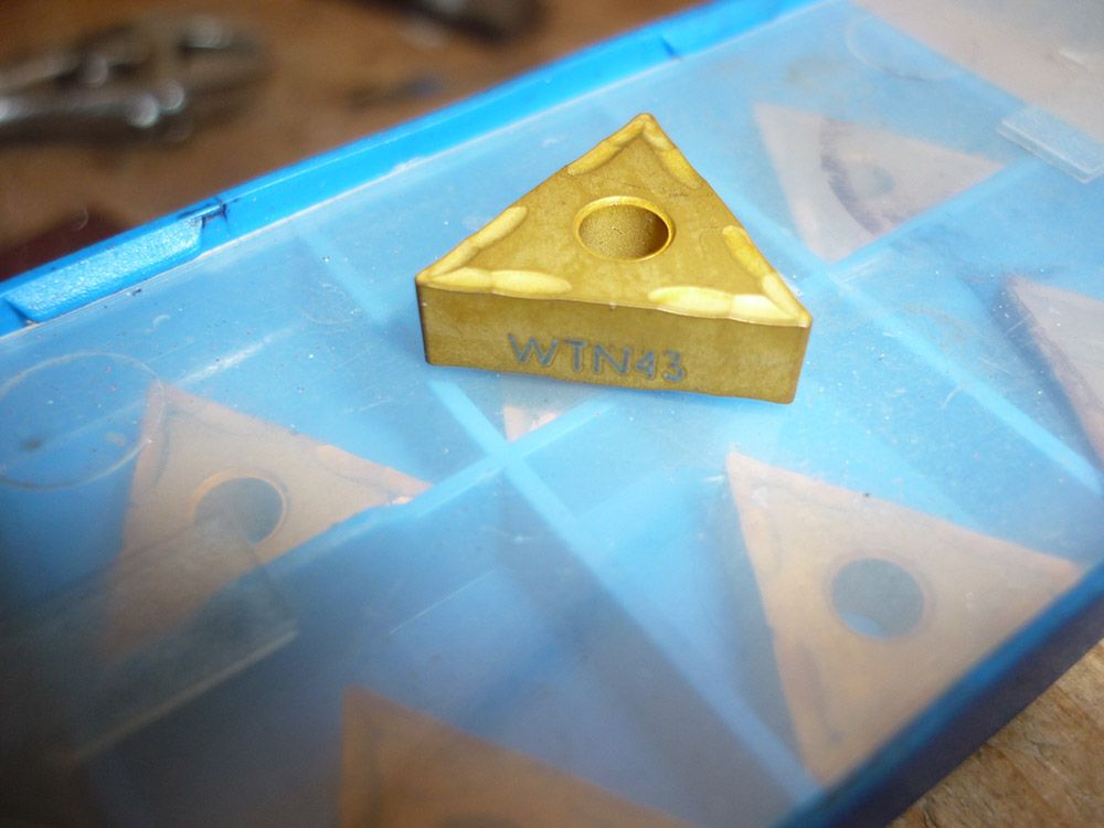

      Can someone explain to me (not much experience of inserts and find all the terminology confusing), are all TNMG inserts negative type??? Also are the generally all the same dimensions apart from thickness across manufacturers?

        #316971
        Brian Sweeting 2
          @briansweeting2
          A good code list here> **LINK**

            #316982
            Nick Hulme
              @nickhulme30114
              This one is pictorial for the identification of inserts you have or have seen –
              http://www.engineeringsupplies.co.uk/pictorial-insert-guide-i-10.html
              This one is for holders so you can identify the insert type required
              https://www.cutwel.co.uk/learn-the-turning-tool-iso-code-system
              This is helpful too –
              General Turning Insert Nomenclature for CNC Dummies
              That's 3 minutes and 20 seconds worth of Google searching
              – Nick
              Edited By Nick Hulme on 14/09/2017 13:36:11

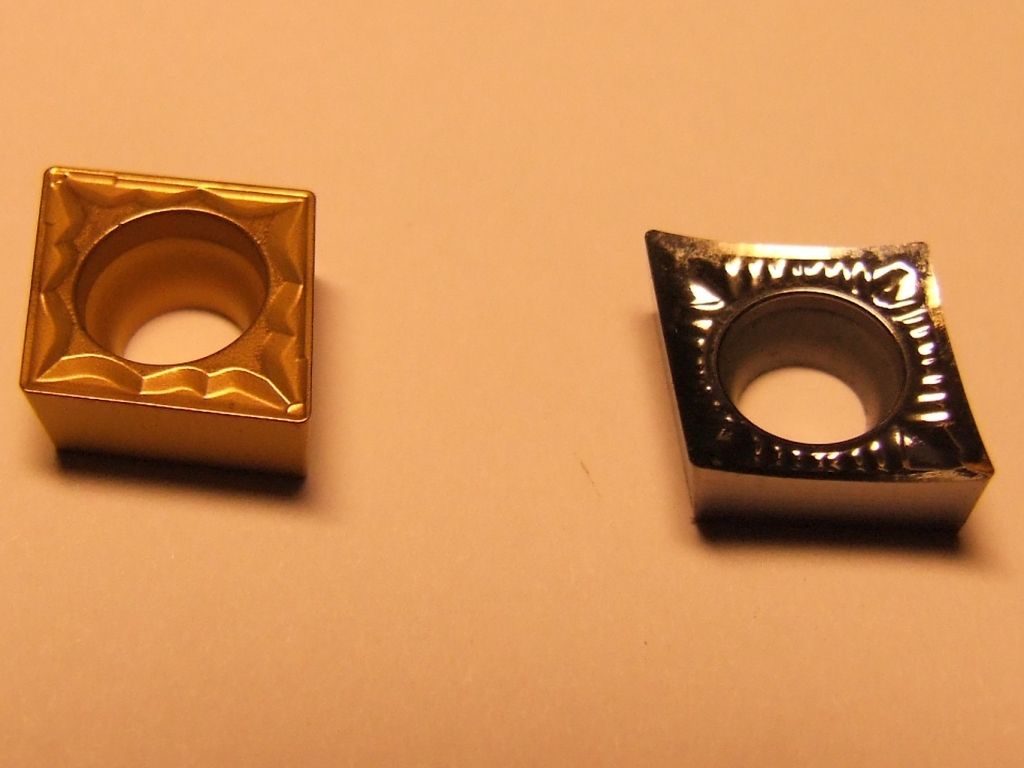

                                          Andrew. My decoding of the magic words CCGT and CCMT indicate that they are both Diamond 80 deg, 7 deg clearencem double countersink, single sided.
                                          The difference appears to be the tolerance, but confess that I can't quite decode what that means.

                                            #317386
                                            Anonymous
                                              Posted by Iain Downs on 17/09/2017 13:57:52:
                                              It refers to the accuracy to which the insert is made. Remember that inserts are sintered from particles and binder in a mould. The CCGT inserts are polished, have higher rake angles and sharper edges, so need to be made to a better tolerance, possibly with smaller particles. As you surmise both inserts have the same shape and will fit the same holder. Here's one I took earlier, CCMT on the left, CCGT on the right:
                                              Now back to work. sad
                                              Andrew
                                              #317388

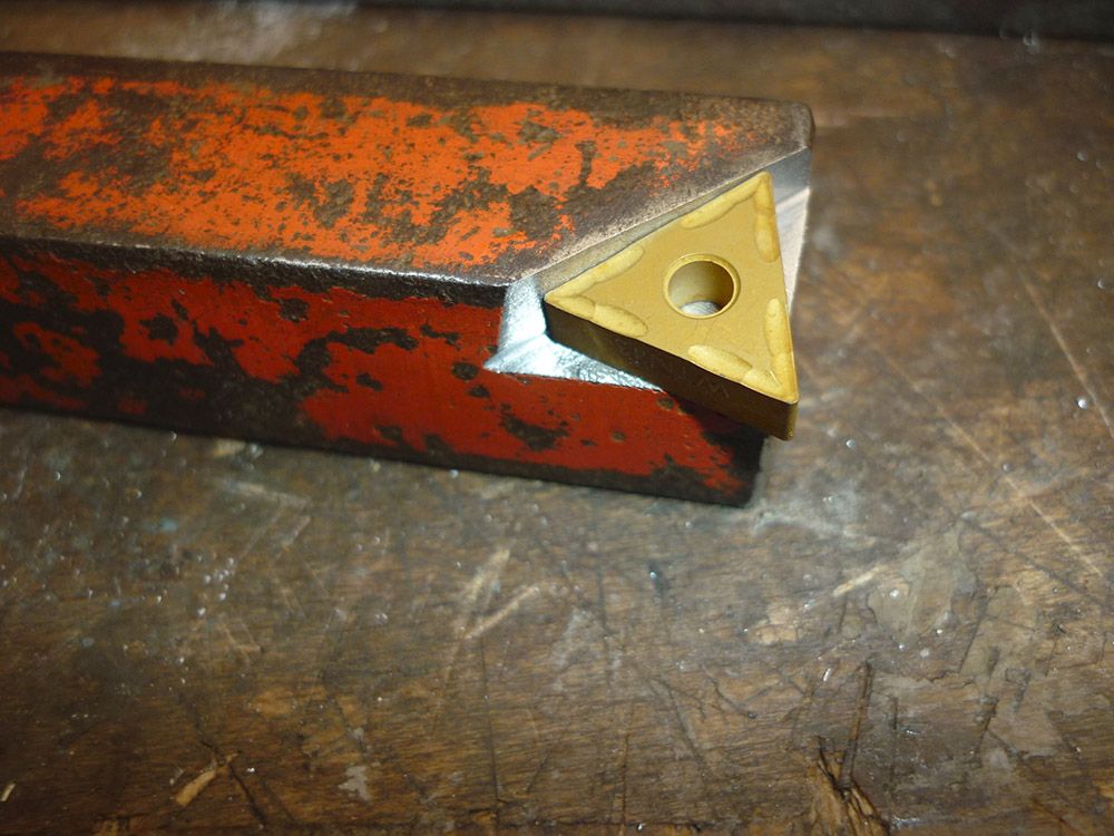

                                                  mark smith 20
                                                    @marksmith20
                                                    One of the reasons i brought this up was that i`m making a fly cutter ,along the lines of the suburban tools flycutter. Ive got most of it finished and attached to a MT4 arbor from my Alexander mill . I bought some negative inserts Walter TNMG inserts cheap off ebay (10 for a pound).
                                                    The hole through them is a straight hole ,not much  chamfer to the holes.BUT what type of screws do i need for fixing them to the bar i have to make the cutter. As far as i can tell the hole is around 3.5 to 3.6 mm??? Do i need pan head special screws or what ???

                                                    #317541
                                                    GoCreate
                                                      @gocreate
                                                      Hi
                                                      Tools using inserts with a plain straight hole don't use screws for clamping, they have an internal and/or external clamp arrangement where a screw acts on a lever and the lever clamps the insert.
                                                      I would imagine the leading manufactures will have some information on their websites.
