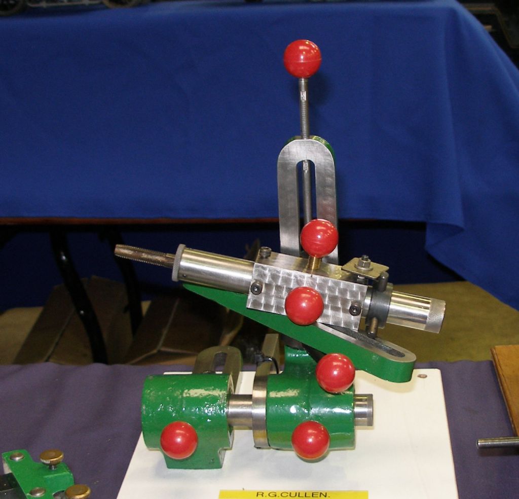

      Hello Vic here again,
      Has anybody come across a “TINKER tool & cutter grinder.
      I read about this tool in an American website ( guy lautard.com)
      I would like to pursue this further,the website sells a set of plans to make this grinder but I would like to know before buying the plans  has anyone else tried to make this unit.( I am Scottish and a bit canny with my cash.)
      Thank you in advance
      Vic

                      Hi There
                      The Tinker is a very simple cutter grinder.
                      I think you could figure it out very easily.
                      I would estimate that the main upright is about 210mm long.
                      It would be an ideal project to cut out of solid cast iron.
                      The castings are very heavy.
                      regards David

                            I realise that this is an old thread but it's the only one that comes up when you use the search function.
                            Anyway I have managed to pick one of these gadgets up and will undoubtedly have questions when it arrives. smiley
                            Jim, do you have any pictures of your set-up?
                            In fact does anyone have any pictures?
                            Tinker

                                    #538764
                                    Sam Longley 1
                                      @samlongley1
                                      I would also like to build this model ( please do not suggest other models in replying) & have been in touch with Guy Lautard who is willing to send me the drawings in PDF format for 50 canadian dollars. I can then print them out on 93 A4 sheets here in the UK. At least that should save surprise import duty etc
                                      I have some castings off a woodworking machine that look almost identical to those in the plans.They can certainly be adapted
                                      I wanted to pay by electronic transfer but have been told by his wife that she will not give me the IBAN account details for me to pay into. Understandable, I suppose, as she does not know if I am genuine. She says her bank will charge her a lot to accept the payment electronically.
                                      Is that true & is payment by cheque from me, with a 25 day clearance time the other end, the only way I can do this? Will that then cost me a lot to get it cleared my end?
                                      Has anyone experience of overseas payment, whereby I can pay someone who is not set up for paypal etc.
                                      Come to that, has anyone got a set of plans I can buy to save the hassle
                                      Has anyone any suggestions please
                                      Thanks
                                      Sam L

                                                  Clever design requiring only one pattern to produce 2 identical iron castings, obviously helps keep cost down. They are machined slightly differently to serve their different purposes. The long flat part is machined both sides and slotted the same. The end "lump" is bored the same diameter to accept a PGMS bar common to both bores. Then the variations start…..
                                                  One casting acts as a base to be fixed to your baseboard and the other becomes the upright, supporting the toolholder block of square section cast iron.
                                                  I acquired the 2 iron castings many years ago from a fellow club member after purchasing the drawings from Guy. I am unable to say why the situation appears to have since changed – you will have to do your own research. Mine has got very near completion but suspended for no other reason than I wanted to also build Harold Hall's jig and write about progress in my clubs newsletter. HH s jig doesn't use castings, only stock metric sizes of steel bar but I have 'got away' with 2" sq instead of 50mm and 1 1/4" sq instead of 32mm Refer to ME No. 4662, for comments on Sources of metric bar.
                                                  I see no reason why the castings couldn't be done in Ali at home by someone who has the gear to do so. I understand that there is little difference between CI and Ali, as regards vibration damping but perhaps somebody knows better?
