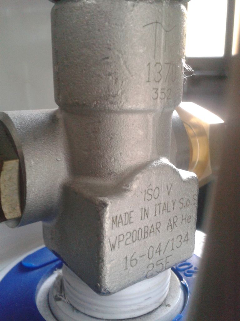

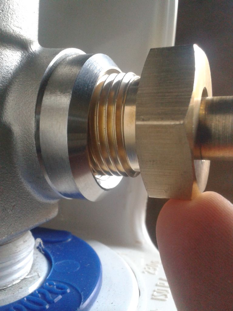

      Measured the thread on the cylinder valve and took some pictures to explain better. The pitch for the internal thread is 14tpi similar to bsp, internal diameter (this is the minor diameter) 22.5mm
      Now while googling for this thread I came across a CGA 580 which apparently is used for inert gas cylinders in the states, the pitch for the thread is 14tpi as well but could not find any dimensions.
      Markings on the cylinder valve
      Internal thread and seat on the valve, as you mentioned Jason the regulator connector is rounded and does not seat properly.
      Wobbly down
      wobbly up

            On a 14tpi thread the difference between minor dia and major would be about 1.8mm so if we add that to your 22.5mm that comes out at 24.3 which just so happens to be the DIN 447 No 10 fitting which is given as the Argon thread in that link I posted above
            BOC seem to list a lot of adaptors for DIN and BS sizes

              DIN 447 no 10 looks like a male thread right? What I have is a female thread (see 2nd photo above) and it has a tapered part internally so it should be able to seal metal to metal without a washer….
              I have found this **LINK** does the CGA 580 make sense, because the pitch is the same and the internal diameter of the thread is the same (ok +0.1mm) The cross section shape internally is the same as in the diagram, so I'm thinking this might be the thread.

                This morning stopped by the gas shop to check if they have any adapters to connect the regulator to their argon bottle and surely enough they had. He looked at my regulator and remarked it's a British spec regulator, opened a drawer and gave me a nut, 12 euro later the problem was solved smiley Asked him what kind of thread it had but he didn't know, he said all British regulators come with the wrong connection for their cylinders….the curious thing is they sell HiLo regulators which if I'm not mistaken are UK made…
