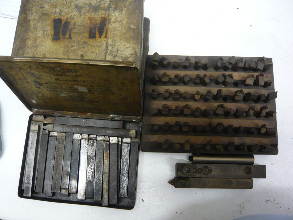

                                            Brian H
                                              @brianh50089
                                              A friend of mine used to work at the local Dormer factory but then it closed down. Anything that was not new, unused and boxed was thrown into a skip!
                                              My friend rescued some master threadcutting equipment that had been used many years before to manufacture tap & dies and he gave them to me.
                                              The 3 tool holders, including the round home made one, hold the 'inserts' which have a common spigot but different forms on the cutting end.
                                              The boxes of chasers include UNF, MM, light bulb threads, bottle threads and something called GKN threads, which seem to be Whitworth form.
                                              I don't use them very often but they are VERY useful at times. I dread to think how much they cost to make but they cannot have been cheap.
                                              Brian
