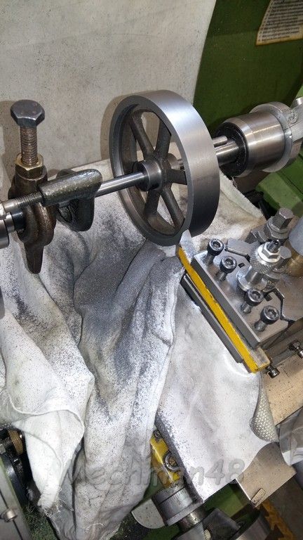

        Set up flywheel for machining concentric to crankshaft, used between centres set up which proved crankshaft running straight without any sign of bending. Only needed 0.3mm touch up on ea. side to get concentricity…
        As we all know CI is crappy stuff to machine & gets into every nook & cranny so it's a major clean up coming up.

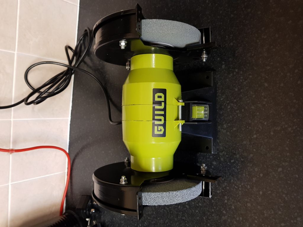

          Finished the toolpost grinder today!
          Found out 150W motor is no where near the power needed and that the 12mm spindle ER16 collet spindle probably not man enough.

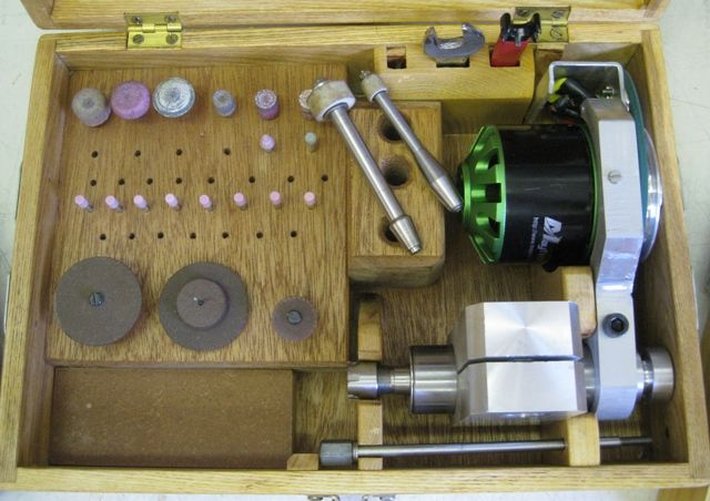

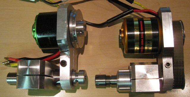

            Hello Jim,
            What about some pictures?
            I am surprised that 150W is not enough…And a 12mm spindle should be fine! Unless you are using 100mm x 20mm diameter wheels and taking of 50thou a shot….

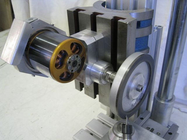

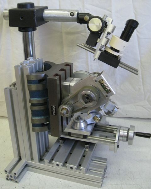

            Pics below are of two toolpost grinders I made using Brushless RC motors – the larger motor is 70mm diameter, the smaller is 50mm diameter. The smaller motor drives an ER11, 10mm diameter spindle, the larger an ER16, 12mm diameter spindle.
            2nd Last Pic shows the larger spindle/motor fitted to a small tool&cutter grinder, turning an 80mm diameter diamond wheel. Last pic is the smaller grinder on the Maximat V10P toolpost position, truing the Chuck jaws. For scale, the chuck is 150mm diameter. The grinder's motor appears larger than it is, cause the camera was closer to it..
            Joe

              I'll take some pictures when I return to the shed, I hurt my back in the shed, which partly explains my defeat!
              Your set up is exactly what I had in mind! What size and type of stones are you using for external grinding? I've only tried some cheapo 6mm shank stones, (I'd guess about 30mm dia and 15mm long). Also, what sort of speed are you running? I guess I have geared for about 9,000 rpm.
              I'm using round Polyurethane belting to drive the spindle. When I first joined the belt, it was a bit tight and the motor wouldn't even turn over, I made a slightly longer belt, (very loose) and got it to run ok(ish).
              Thank you Joe.

                Hello Jim.
                The smaller grinder goes from 3000RPM to around 12000RPM at the spindle. The motor drivers via a 6mm green poly belt, like yours I believe. The ratio of motor to spindle is around 4 to 1.
                I use all sorts of wheels on this one, up to about 25mm diameter, down to 6mm diameter, where the 12000RPM is a tad low…
                The larger grinder uses a toothed rubber belt and pulleys, with a drive ratio of 3 to 1 – the max spindle speed is around 6000RPM since I use bigger wheels on this one – up to 100mm diameter, 6mm width.
                I suspect the problem you have lies in the gearing – the motor you have is I presume a standard 1400rpm or 2800rpm AC synchronous motor? If so, it will most probably not have enough torque to drive the spindle at 9000rpm…
                If your motor is a brushed AC/DC motor, then its speed should be quite higher, and the subsequent gearing lower, and it should work. EMCO ,long ago, mad a very nice toolpost grinder for the MAXIMAT series lathes, and it used a brushed motor or around 120watts, and that work very well, with wheels up to 50mm x6mm – slow feed and light cuts, 'just' sparking..
                Generally, I use stones of around 25mm to 50mm diameter for outside grinding, from 6mm wide up to 15mm wide.
                I also use 40mm cup wheels to grind a face when needed. Speeds are from a table for the wheel diameter versus material ground, and wheel makeup..a 25mm Al_Oxide 150 grit wheel on outside work on hardened steel pins I may run at 7000rpm to 10000rpm, for the final finish.
                Joe

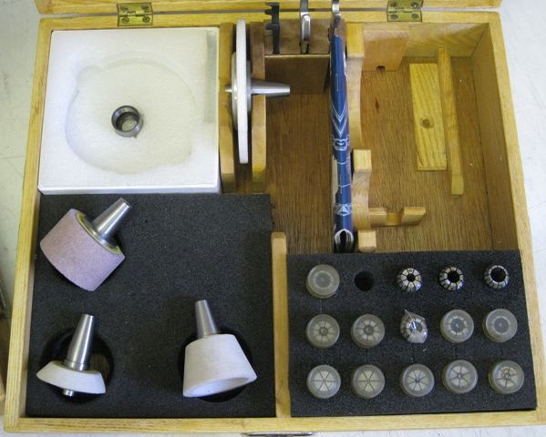

                Here on the smaller grinder you can see the poly-belt drive, and a drawbar held drive spindle with a 15mm wheel mounted.
                Here on the larger grinder you see the toothed belt drive

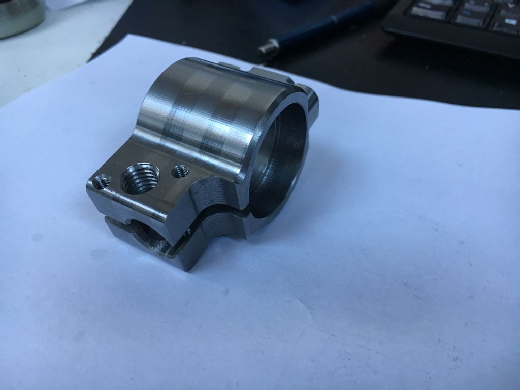

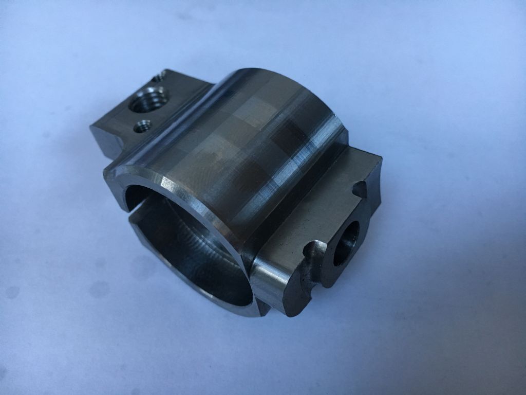

                    Finished my ballnut bracket yesterday – drilling and machine tapping the M4 and M10 holes, chamfering them, then splitting the yoke in the bandsaw with 2 parallel cuts to form a 3mm slot. Finally, some edge breaking / deburring with diamond files and deburring tool.
                    Finished yoke
                    Finished yoke
                    The curious blue lighting effect is presumably due to the low light levels and the way iPhones work. It's almost dusk here and this was natural light from the skylights and windows. It's actually sitting on a piece of white A4 paper.
                    No obvious cockups and no broken tools. Good result!

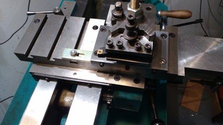

                          Inspired by another thread, I got one of these 133 mm backplate castings from RDG…
                          …and created a lot of cast iron dust to liberate this:
                          A new toolpost to mount my Dickson QC holder much more rigidly on my S7, replacing the topslide. A straightforward turning/milling job. As well as more rigidity I wanted to improve the repeatability of changing tools when CNC turning, so the post is located laterally by a fence down the side against the x-slide:
                          And by a stop at the end:
                          which is bolted down to a tee slot after pressing firmly against the base. So should I ever have to remove it then it can go back in the same position. There's also a dowel pin locating the Dickson block relative to the post to stop it shifting through the cutting force.
                          I will now need to recalibrate all the tools as the position will have changed a bit relative to the topslide.
                          Now I just need to clean up all the CI dust that seems to have covered everything in the workshop.

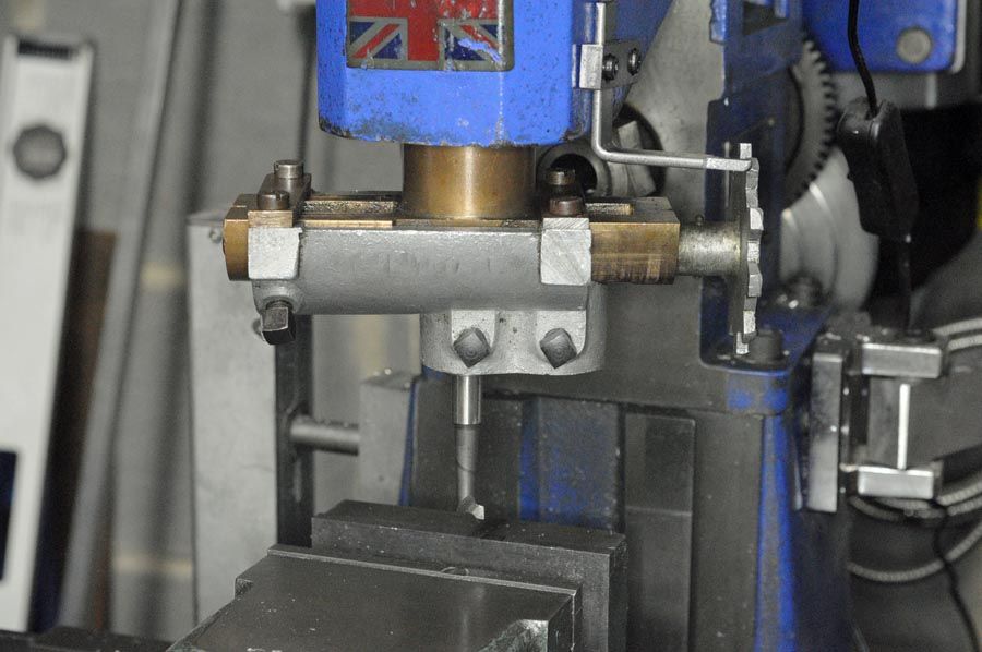

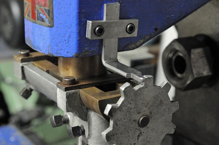

                                    I, at long last, made striker arm for the Dore boring and facing head that I bought on ebay a couple of years ago
                                    This is a pretty cumbersome beast, not nearly as nice to use as my Arrand boring head, but it does have the facing function and screws onto my Sharp mill which has a Myford nose thread. By the way – Does anybody know where I can get a 3/8" indexable boring tool?

                                      Rod, you could try JB Cutting tools.
                                      Or make one?

                                          Rod,
                                          How about one of these Ebay 352259180098 & turn it down from 10mm to 3/8" ?
                                          Also available in 6, 7 & 8mm diameter taking the same CCMT0602** inserts to sleeve up. Searching "SCLCR" brings up most of them.

                                            Rod, Glanze (Chronos) do a set, I have the 1/2" ones at the top of the page and use them all the time.
                                            I'm not sure if a lathe boring bar will work as they tend to set the tip at an angle

                                            Roderick Jenkins
                                              @roderickjenkins93242
                                              Guys,
                                              Thanks for the input. As Jason says, I don't think a lathe type boring bar will do. My searches turned up the Glanze set but I don't really want to spring for £100. I was hoping to find a single tool like this with a 3/8" diameter shank:
                                              I could probably turn down a 1/2" one if necessary.

                                                Why wouldn't a lathe one work? The geometry should be just the same whether the tool or the work rotates.

                                                  mgnbuk
                                                    @mgnbuk
                                                    Can't see why it should make a difference ? If I use the boring bar in the lathe (set correctly on centre) to machine a bore larger than the minimum specified for the tool in a rotating workpiece, or rotate the same bar set on centre in a boring head to generate the same diameter bore in a stationary workpiece, the tip is presented in the same way to the bore regardless ?
                                                    I have used larger diameter lathe boring bars in larger than ME size boring heads at work (admittedly into graphite components, not metal) & they have worked fine without rubbing, and have also mounted lathe internal screwcutting tools in milling chucks & using them as fly cutters for thread milling on CNC milling machines.
                                                    I have the bars I linked to & intend to try them in my 2" boring head – just require the 1/2" to whatever reducing sleeves making to be able to try them out. I'll report back after doing so, though these projects do seem to take longer than initially anticipated !
