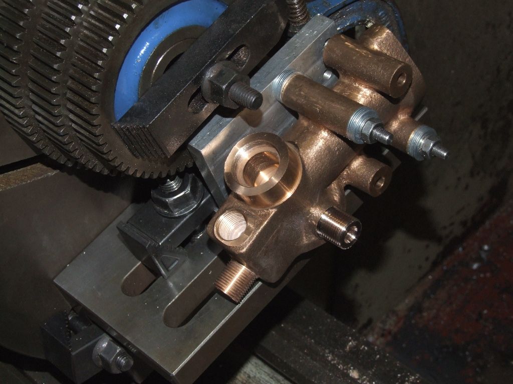

                    I've finally done the last of the machining on my re-designed Burrell water pumps, the spigot with an external thread roughly in the centre of this picture:
                    It's the first time I've used slow helix drills on gunmetal. They seem to work pretty well with no snatching, so I will be buying a few more useful sizes. All the other threads have been screwcut on the lathe but one of the mounting spigots being in the way makes this difficult in this case without a special insert toolholder. So I bodged a special thin holder for the 3/8" BSP die instead:
                    There are still a few bits left to do on the water pumps, but it's now full steam ahead on the wheels.

                              Jason: Looking good, that's a lot of machining though! I expect to see the engine running at the next SCMTEG steam up. smile
                              I could have thread milled the BSP thread, but I would have had to obtain a 55º thread mill, whereas I already had the BSP die. And I would have been reluctant to use the water pump casting as a trial for thread milling; there's a lot of time invested in it!

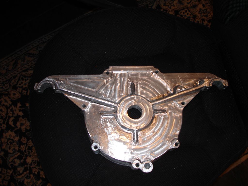

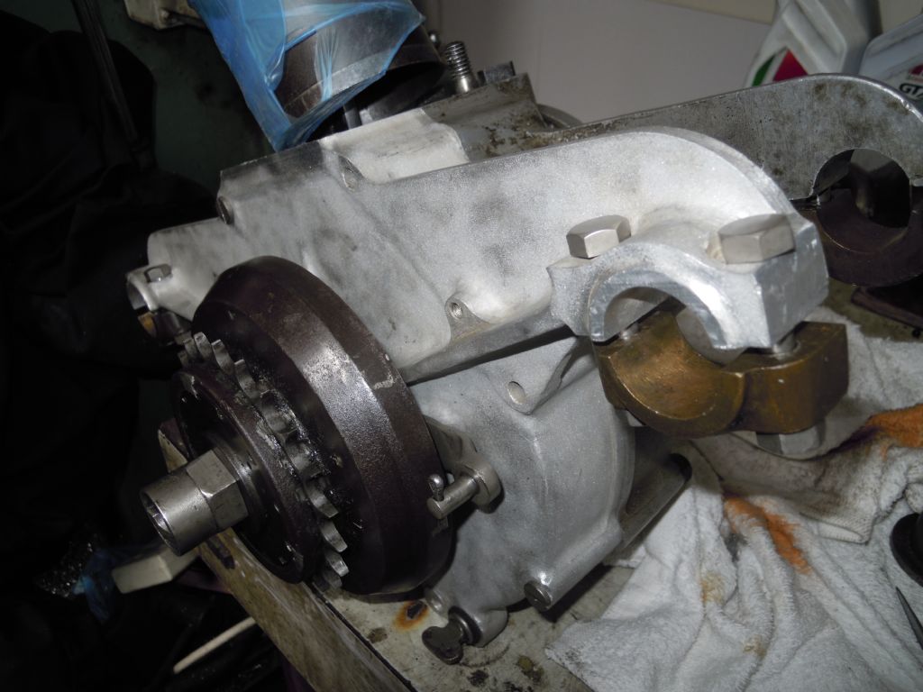

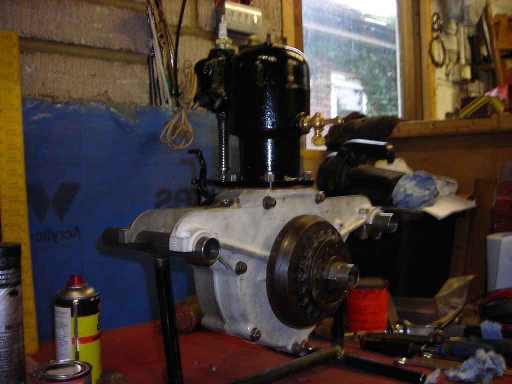

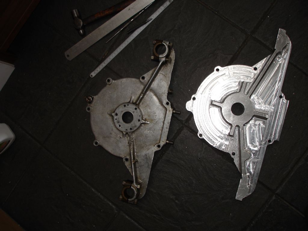

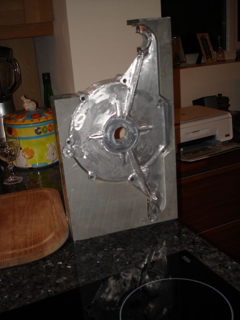

                                  Jason,
                                  here's one I did earlier.Its a drive side Crank Case half for a 1905 Rover Forecar. If memory serves me well it was 16" across from hanger to Hanger. I also made a new crankshaft for it.
                                  The Block of HE 30was 18" X 4" X 12" or thereabouts. A great deal of effort and time was saved by getting the outer profile water jet cut. Here is the billet with the embryonic crank case half inside it after jet cutting.
                                  Into the lathe first of all.
                                  Further lathe work
                                  Onto the Manual Milling Table
                                  Lots of cuttings were generated in the mill.
                                  Almost finished profiling in the mill and a little work with the Dremel to blend in some of the radii etc.
                                  Using the Timing side half as a template to machine the mounting lugs.
                                  Further work Carries on
                                  Finished with the Dremel Prior to grit blasting.
                                  A Trial fit in the scrap left over from jet blasting.
                                  The bottom end of the engine together
                                  On The Road at last on a cold February morning.

                                        Hi Jason,
                                        it's a nice way to make things but you really have to concentrate on what you are doing. In the past I have specialised in making replacement casings for veteran and vintage motorcycles and have found that virtually all of the really early engines suffered badly from casting porosity. I suppose at the turn of the 20th century they were just learning how to alloy the metal and perfecting casting techniques.
                                        By making replacements in alloy billet you get a much stronger component than the original.
