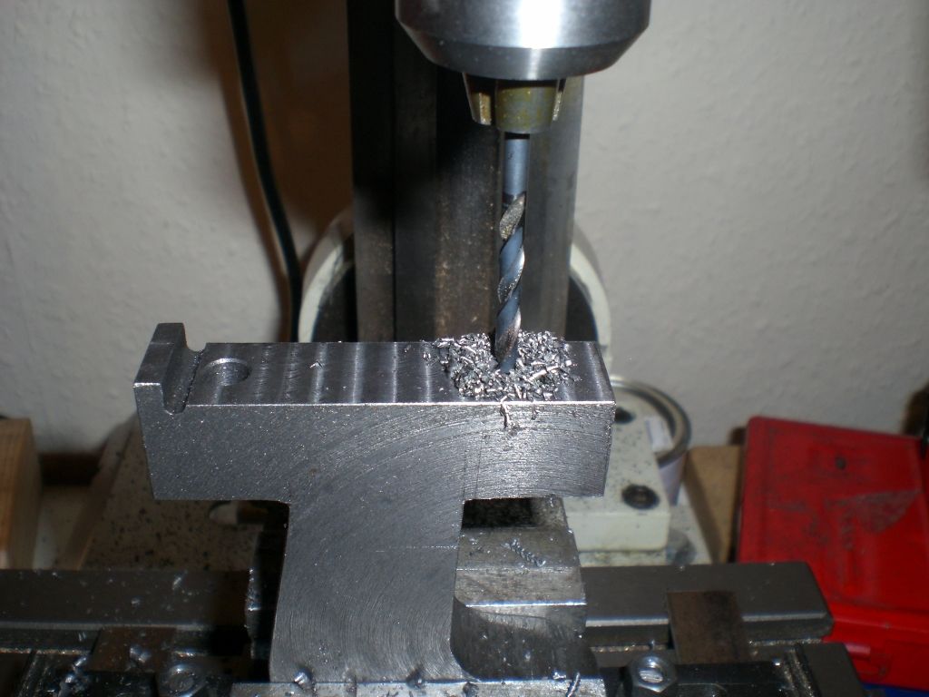

    Nicholas Farr
      @nicholasfarr14254
      Hi, this evening I made a bit more progress on my traveling steady. I've marked it out and chain drill part of it to make it easier to cut and I've also milled the underside of the base to incorporate a register for easy repositioning into the same place.
      Regards Nick.

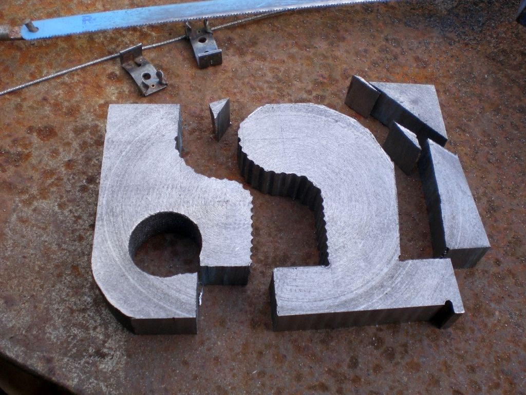

          Hi, this evening I hacksawed my traveling steady to the kinda shape that I was aiming for.
          Then after initial filing towards its final shape, it looks like this.
          Regards Nick.

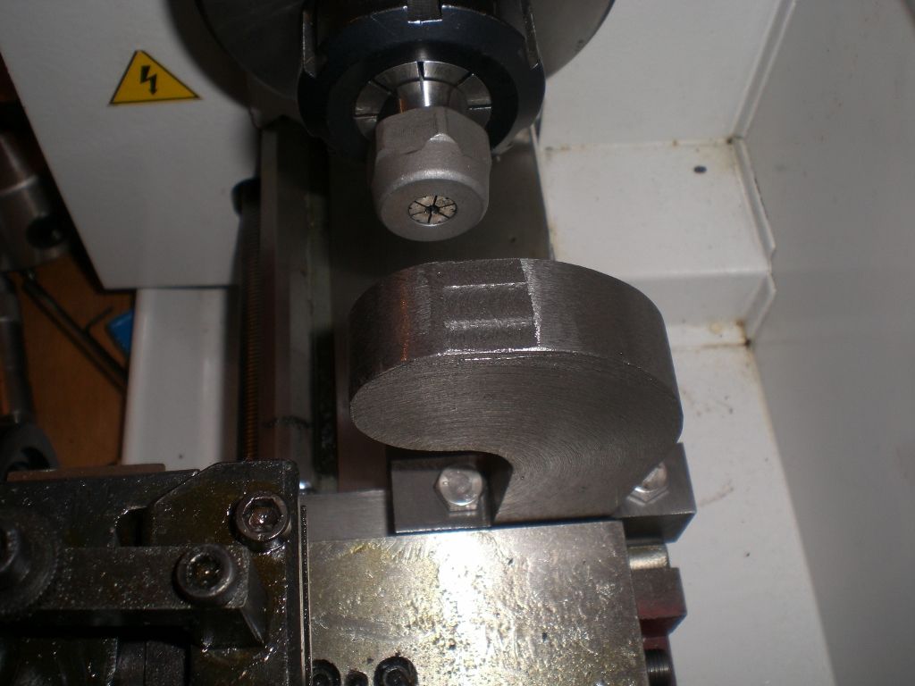

            Hi, this evening I only had time to set up my traveling steady on my mini mill, to skim the faces which the hold down bolt heads will be in contact with.
            But before I could use my boring head in reverse, I had to drill and tap it for a small grub screw to prevent it from undoing.
            Regards Nick.

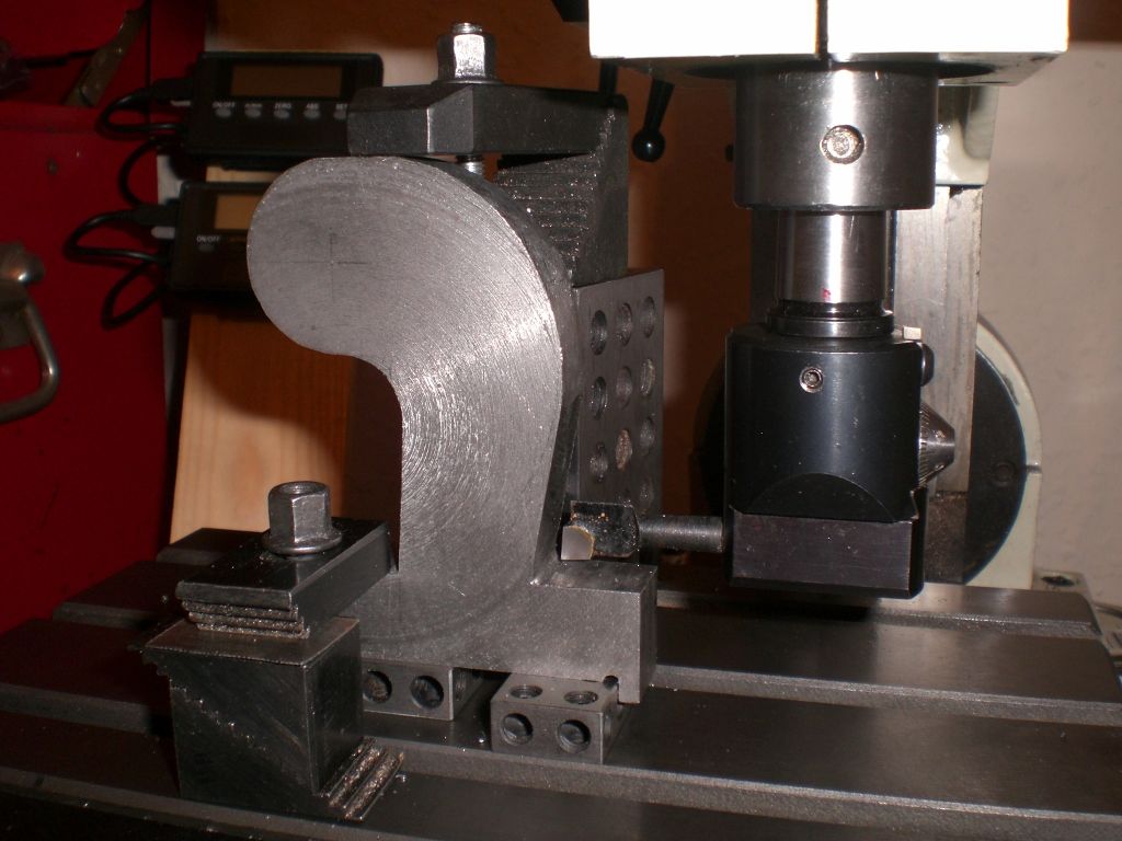

              #233834
              Nicholas Farr
                @nicholasfarr14254

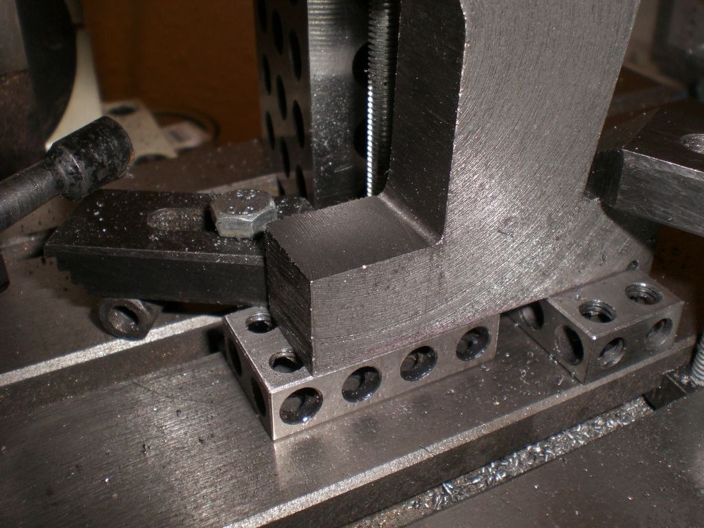

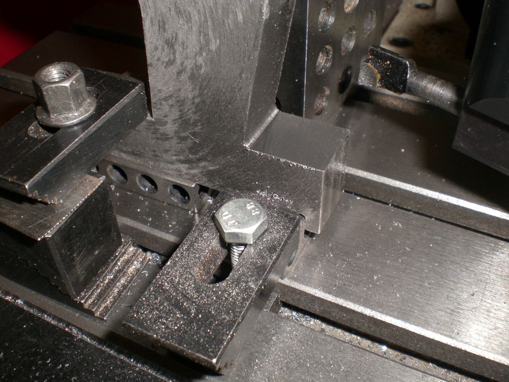

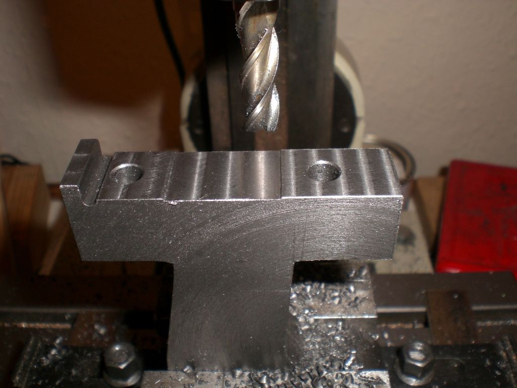

                Hi, this evening I skimmed the bolt head faces on my traveling steady, but just as I had thought, I had to stop the steady from twisting when the tool started to cut, even with a fairly light cut. So it was reset and a clamping bar was fixed against the side at the bottom.
                When this face was skimmed, the clamps at the bottom were rearranged so that the other face could be done.
                After both faces were done, the steady was set up in a vice upside down and the two bolt holes were drilled.
                After drilling the holes, a 0.5mm deep relief 25mm wide was milled midway between the holes, this helps to ensure that there is a good contact on the lathe saddle at the bolt hole locations.
                I next fitted the steady to the lathe saddle without any issues and the area that I intended to line up with the mandrel axis, does so very well.
                Regards Nick.
                Edited By Nicholas Farr on 08/04/2016 21:16:14

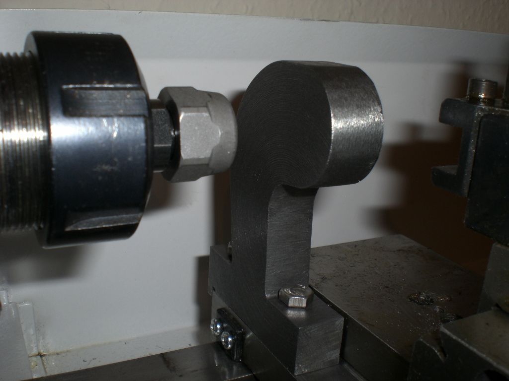

                #233835
                  Posted by Nicholas Farr on 03/04/2016 00:44:41:
                  Proof this forum is full of old buffers!

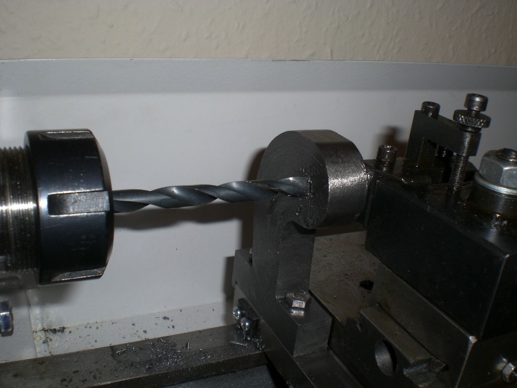

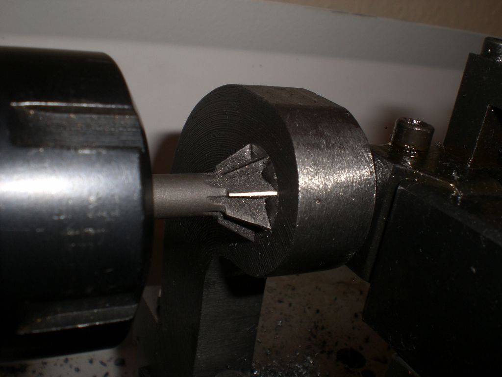

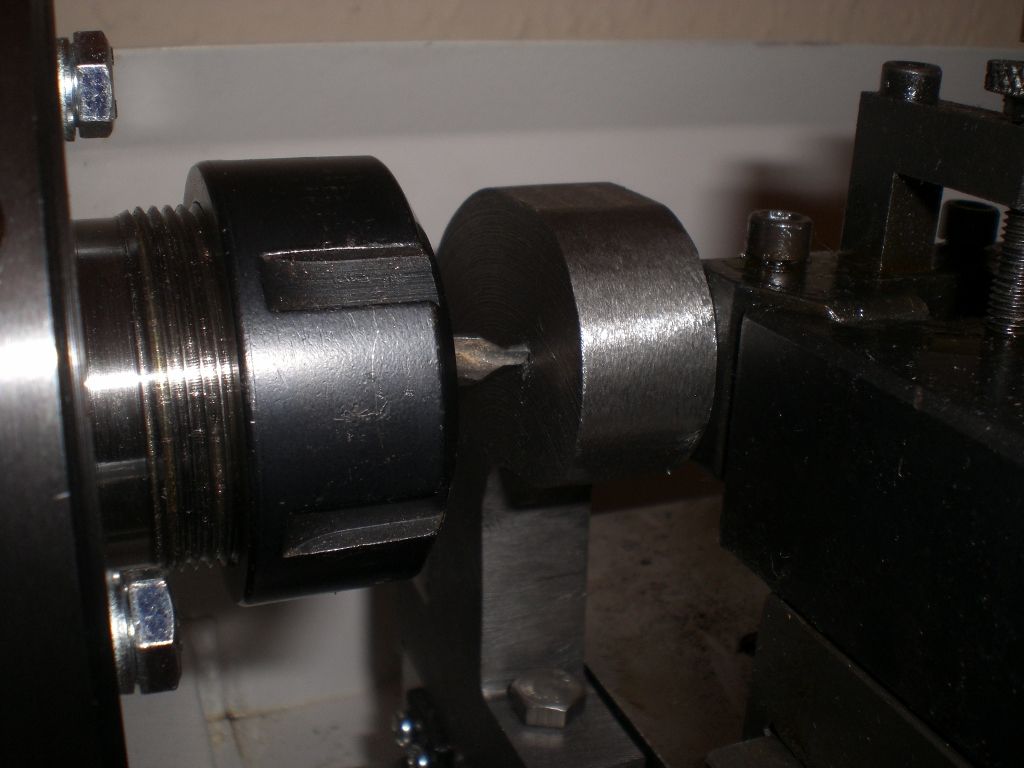

                        Hi, this evening I did a little more on my traveling steady while still being mounted on my lathe saddle. Firstly, using a centre drill held in a collet chuck on my lathe, the steady was centred on the chuck side with the tool post against the other side to stop the steady deflecting.
                        It was then piloted and then drill for tapping M9.
                        The drilled hole was then milled out to 10mm to a depth of about 8mm.
                        It was then tapped M9.
                        I then used a 3/4" dovetail cutter to counter bore the hole very slightly.
                        The steady is now ready for blank brass inserts.
                        Regards Nick.
                        Edited By Nicholas Farr on 10/04/2016 00:24:20

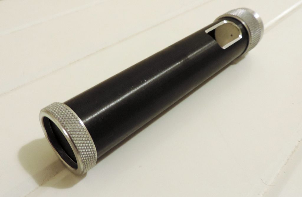

                                  Here are some CNC-free end caps
                                  Made this this evening, can anyone guess what it is?
                                  #234383
                                  Ed Duffner
                                    @edduffner79357
                                    One of those plunger things for starting fires?
                                    An off-axis guider for your telescope?
                                    Ed.
                                    #234407
                                    john carruthers
                                      @johncarruthers46255
                                      Collimator?
                                      #234482
                                        Solar finder, pinhole at the front, translucent screen at the other.
                                        Almost comically simple to use.

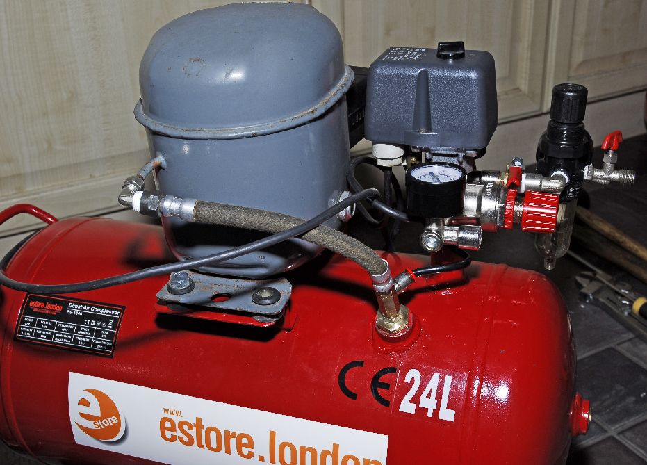

                                        Ed Duffner
                                          @edduffner79357

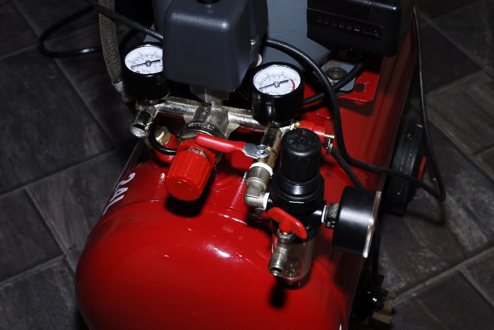

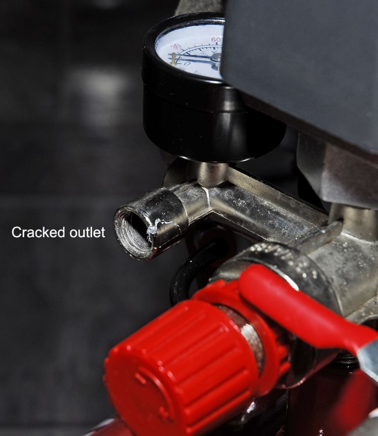

                                          Spent part of yesterday and today swapping the air tank/receiver from a new very noisy compressor over to my old silent compressor. Made an adaptor for the inlet pipe, 1/2"BSP male to 1/4"BSP female. The only thing I had to make it from was a piece of hex stock about 3mm longer than the finished part.
                                          Had a slight mishap somehow in that the regulated outlet connector cracked, so I need to make a repair to that. It's a very brittle, cast material. I was thinking of turning a thick walled sleeve to fit snugly over the outlet and solder in place. Any comments/ideas welcome. Buying a replacement outlet connector bar/tube is possible from Ebay.
                                          Ed.

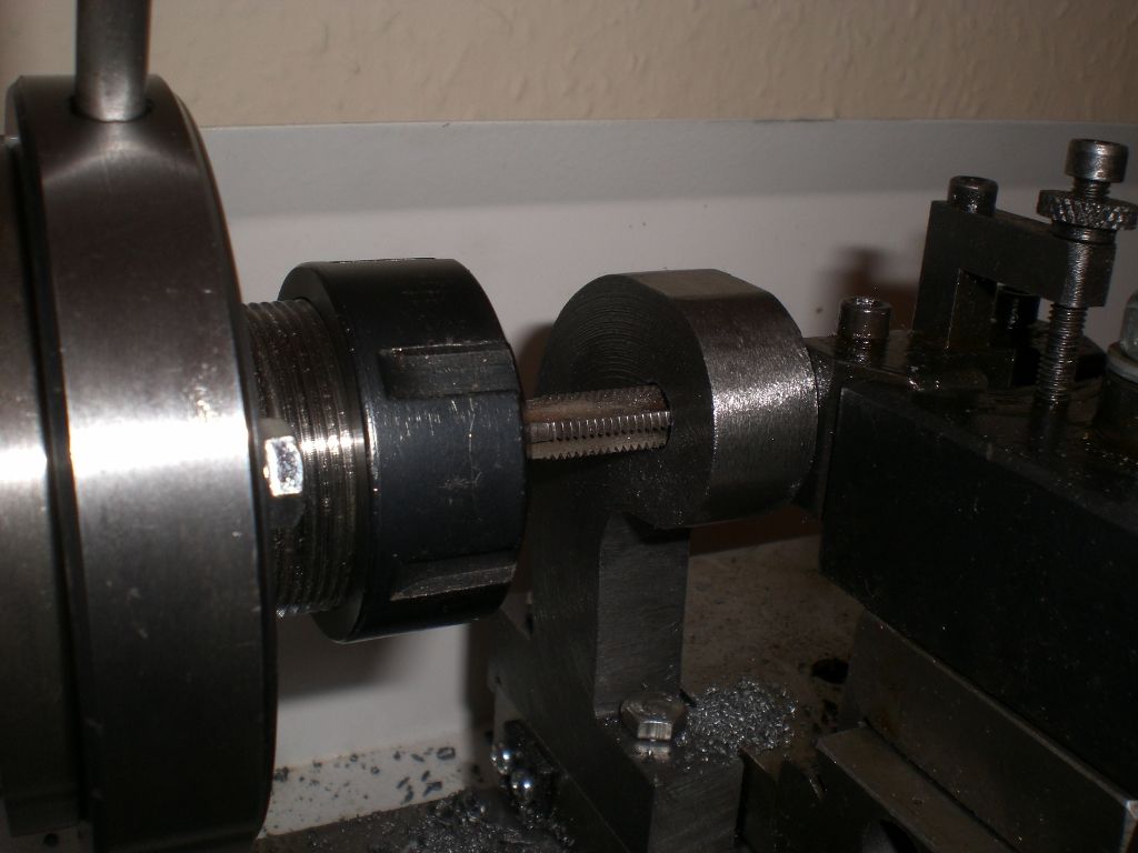

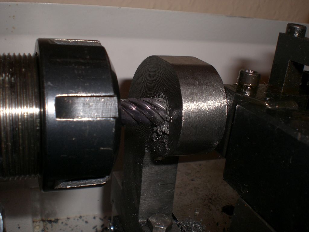

                                            Just thought I'd share the elegant tool that knurled that 1 1/4" aluminium tube, given the sophistication of some we have seen recently:
                                            QCTP Knurling Tool

                                              Neil, I am going to make one of those knurling devises. What size knurl wheels did you use ? It will be on the list of jobs, I am still doing bits on making my new lathe cross slide in between other jobs. All squared up/tee slots and dovetails in. Hope to do the drilling/tapping/oiler positions today then on with the radial tee slot and angel engraving for the top slide.
