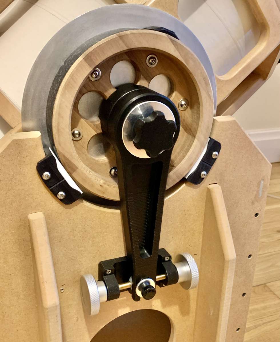

                Dr_GMJN
                  @dr_gmjn
                  On duncan webster 1 Said:
                  You can set a stepper controller to do microstepping,which as its name suggests means it does a lot less then 1/200 of a rev every time it gets an input  pulse from the arduino. I’m not sure how well it would stand still doing that, you can also get gearboxes to bolt straight onto stepper motors.ivd gog one somewhere,ill dig it out and take a picture. For something this simple,where you at a minimum only need clockwise or anticlockwise, continuous or jog you could actually do it with something like a 555 and some push buttons, although I’d use a processor as you are bound to want to add functionality. I always do.
                  Thanks Duncan.
                  I’m doing some calcs, and I think a 5:1 or 10:1 gearbox would do the trick for azimuth The backlash of 0.5 deg. looks acceptable too once the gear ratio of the slew ring:drive is accounted for. The motor/gearbox combinations you posted look good – I’d hate to have to build one for that kind of money…
                  The altitude drive would be direct.
                  I’m on an astronomy forum where they’re into all sorts of diy tracking projects, and I’m sure if I can get the jog functions working well, I could then adapt it to track for an hour or so, and ultimately try some long exposure photography. The Equatorial Platform is surprisingly great, and seems very insensitive to initial setup.
                  I’ll be using two rotary encoders on a flying lead to control the axes. One will have a push function so I can centre the altitude nut quickly when I run out of movement.
                  #788174
                  Dr_GMJN
                    @dr_gmjn
                    On John Haine Said:
                    If you poke around online there are a number of telescope controllers using Arduinos and steppers. Probably also with coordinated motion for a Dobsonian. Once you can control the telescope with a processor if you fitted a ccd sensor you could observe from indoors in the comfort of an armchair!
                    That’s the ultimate goal I guess – I didn’t intend to go down the powered axis route at all, but a stepper motor for azimuth is so much easier (I think!) than a mechanical knob, quick-release and locking mechanism.
                    If I’m powering one axis, it would be rude not to power the other, and then why not use a stepper for the platform drive too?
                    It’s all escalated very quickly.
                    #788176
                    Dr_GMJN
                      @dr_gmjn
                      On Howard Lewis Said:
                      Being a Luddite, for a fine adjustment, why not use a ME 40 thread?
                      40 tpi from 1/8 up to 1/2″ or 32 tpi from 5/16″ to 1/2″
                      Howard
                      Thanks Howard – I got the M8 x 0.75 tap and die today, so that’s that.
                      #789127
                      Dr_GMJN
                        @dr_gmjn
                        It’s now complete and works smoothly. Just need a clear night to test it for real. Thanks.
