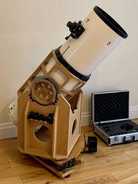

      All, I’m making a fine adjuster for altitude on my DIY Dobsonian telescope mount. I have just built an equatorial platform for it for tracking. I’ve 3D printed a 200mm long lever arm, and now need a leadscrew. I had originally designed it for an M8 fine thread, for which I was going to buy some threaded rod, and then get a tap to thread the corresponding nut.
      For the highest magnification eyepiece I’ll ever be using, I’ve calculated that to move a point from one side of the field of view to the other, it would take about 1/3 of a turn of the adjuster. For lower magnifications, it would be around 3/4 of a turn. I need to get a compromise between getting a fine enough adjustment for small targets like stars and for panning around the Moon’s surface at high magnification, but then when trying to find an object just out of view at low magnifications, not wanting to have to turn the wheel loads of times (or disengage the lever arm clutch knob and move manually).
      I think 1mm pitch is about right, but ideally would be around 0.75mm pitch to give a slightly finer adjustment. Since I’ve already got some 8mm thrust bearings and hand wheels with a 6mm bore, I’d like to stick with something around M8.
      Are there any finer “standard” threads to use, with good availability of taps/dies or threaded rod? The overall leadscrew length needs to be 150mm.
      Also, if I do stick with M8 fine, is it better to buy threaded rod, or thread plain bar with a die? The leadscrew nut is nylon, and I’m hoping that I can get zero backlash by using that in conjunction with a metal thread. The precise tolerance on the thread itself is unimportant, as is the straightness of the thread (within reason). I don’t really want to get into custom thread turning bar and nuts on the lathe – I want to use the telescope rather than spend more days making parts for it, plus I’ve yet to come up with a design for azimuth fine adjustment, which is far more difficult.
      Thanks.

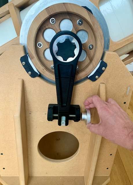

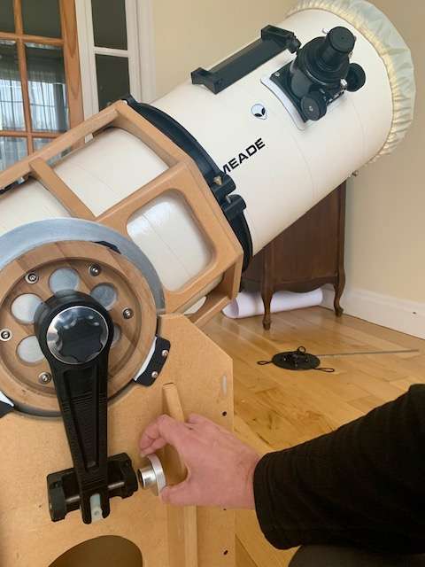

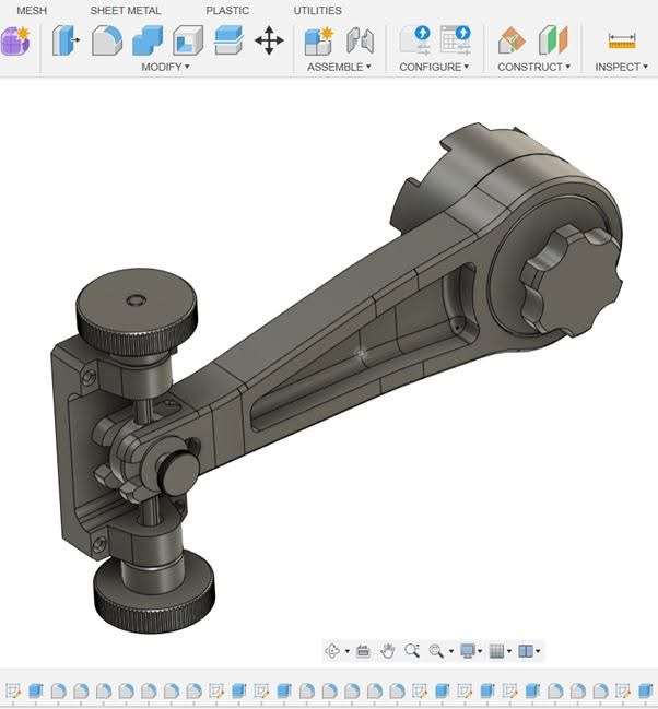

                        For some context, this is the torque arm I’ve designed. Self-explanatory, apart from perhaps the bushes in the leadscrew bracket, and the thrust bearings behind each hand wheel:
                        IMG_2784
                        And this is it printed, with the leadscrew balanced in place. There will be a handwheel either side of the thread. The large printed knob in the centre is a clutch that can be released to allow the telescope to be easily moved by hand (as it is by default). It also allows fast assembly / disassembly for storage. I’ve also added a smaller knob on the leadscrew nut, which allows the arm and nut to be locked together – just in case I end up with backlash or wear in the lower end of the mechanism:
                        IMG_2820
                        IMG_2821
                        I want to adjust the lever arm while looking through the eyepiece, to centralise an object. It doesn’t need to be within microns of central, the main thing is the thread is the best compromise between how much I have to rotate the wheel vs how fast the object crosses the field of view (which depends on magnification and the field of view of the eyepiece). At present with a 0.75 pitch, and a higher magnification eyepiece, it’s about 1 turn, which seems reasonable.
                        Happy to try a differential thread if it could be designed for example that turning one handwheel gave coarse adjustment, and the other fine. What I wouldn’t want is the need to have a hand on each wheel at the same time – that would be awkward to operate while looking therough the eyepiece.
                        I think at this point, a diagram would be helpful to show what you’re suggesting.
                        I did order an M8 x 0.75 tap and die, and I have some 8mm brass rod that I was going to thread for this. I also have standard M8 taps and a die, so I do have the means to make the two threads.
                        Thanks.

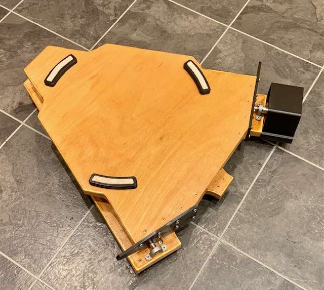

                            I made the Dobsonian mount to get rid of the terrible standard equatrial mount that vibrated badly through lack of stiffness (it didn’t track properly either).
                            With the vibration solved with the Dobsonian mount, then the images drifed out of view becasue there’s still no tracking.
                            So then I’ve made an equatorial platform, which freezes the images in the eyepiece.
                            But…now the images are stationary, it becomes more important to centralise them intitially, and to not accidentally knock them out of alignment. Hence the current work.
                            It would be easier to just buy a modern telescope with all this functionality built-in, but where’s the fun in that? Luckily the mirrors in this telescope are known to be high quality, despite them being fitted into rather budget hardware. It’a a Meade 10″ Starfiner from the early 1990s.Picture4IMG_2688IMG_2689IMG_2739IMG_2724

                                        Thanks Robert. Yes, I did think of that, and also going a step further and putting one on the azimuth axis so I could track targets using a guide star. Then we get into field rotation when using altitude and azimuth to track a target that’s moving in an arc. It’s all possible, and has been done before, but then I’d be complicating things a step too far than I want to.
                                        My driven platform eliminates rotation (at least for an hour or so), and once I’ve sorted the initial fine adjustment and locking out, I should be able to have a fairly relaxed method of visually observing planets and the Moon.

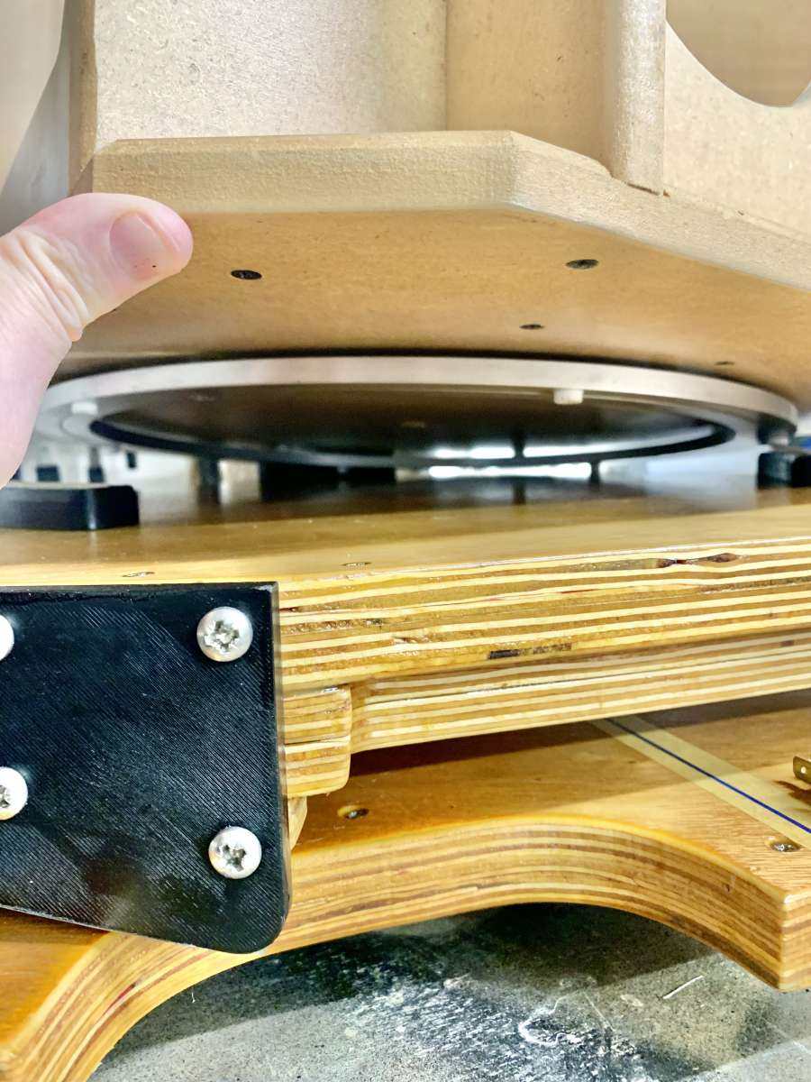

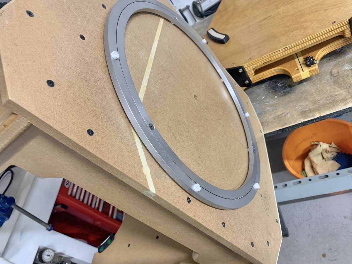

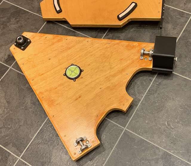

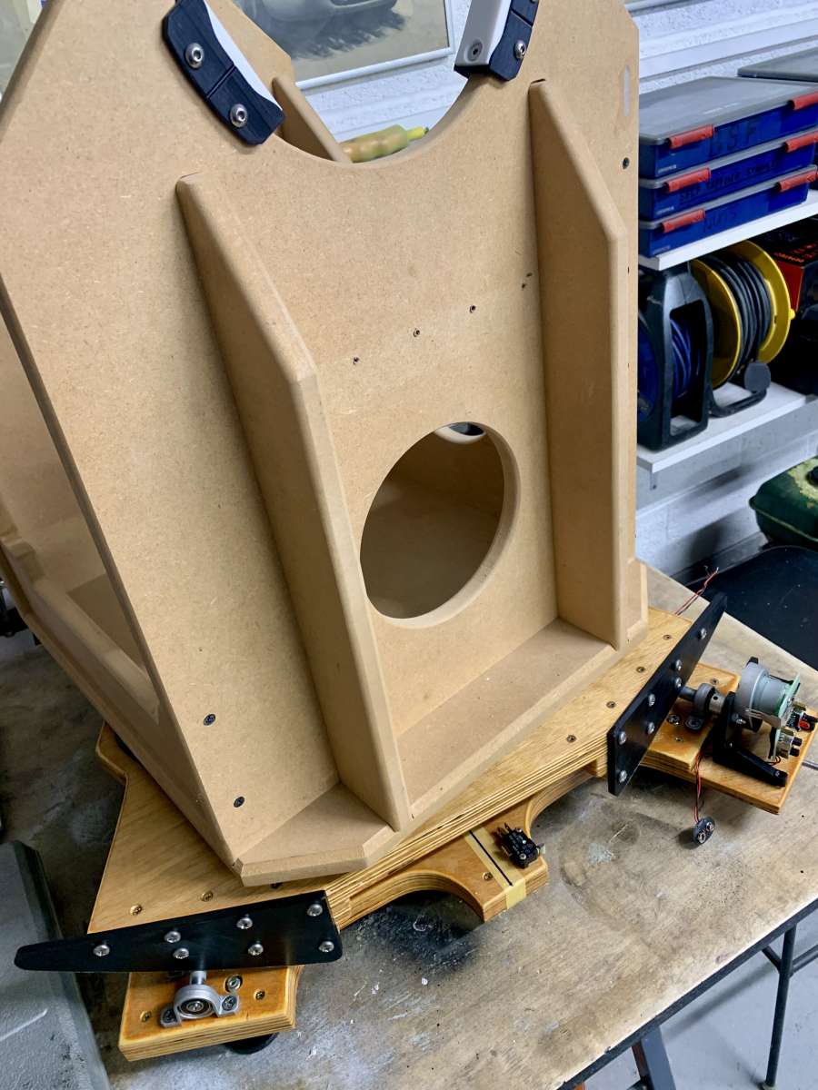

                                          <p style=”text-align: left;”>The next thing I need to do is make a similar fine adjustment for the azimuth axis. For the mount I used a lazy Susan bearing. The inner part is fixed to the upper mount (the part that rotates). The outer part sits directly on the equatorial platform, just located by three sectors, so the mount can be lifted on and off the platform by hand.</p>
                                          IMG_2822
                                          IMG_2825
                                          IMG_2823
                                          Whatever adjuster method I end up with needs to be very low geared, no backlash, lockable (or no back-drive), and be capable of being disengaged easily for free rotation by hand.
                                          The adjuster wheel also needs to be accessible while viewing through the eyepiece (so on an extension to raise it up from the base to hand height).
                                          I thought of using a small diameter friction roller against the outside of the bearing (or an upper extension of it to avoid the location sectors). Possibly using an over-centre type latch to engage or disengage it.
                                          It’s not as easy as designing the altitude adjuster. Any ideas? A job for Robert’s stepper motor and remote control idea? Thanks.
