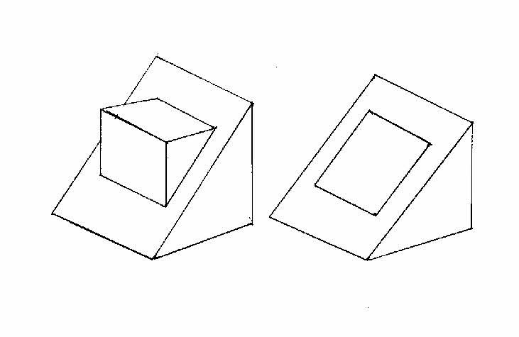

      Well, since unreferenced lines are allowed on drawings (although this is like steam trains whistling in stations – not wrong; we just don’t do it), here are two solutions sketched. The first is Geoff’s one – probably the neatest way. But the second isn’t absolutely wrong either. You can work out what the side views of each would be very easily, I think:
      I prefer Geoff’s. Sorry for the awful sketch, but you get the idea… and you don’t want me to draw a cube, now, do you? Not if it looks that bad anyway!

          Strictly, of course, an engraved rectangle would have depth and this would create hidden detail, however shallow.
          The ‘two prism’ solution was always the one preferred by our instructors.

                Posted by Graham Meek on 20/04/2011 20:10:09:
                Hi Steve,
                I think your second solution is feasible, but I think you missed out a line? as I interpret it that is a square hole through the cube, or is it an engraved rectangle on the angled face?
                No, they were ambiguous lines on a drawing – object incompletely specified. And that’s exactly the point – ambiguity. It had lines on it that you had to consider carefully before you came to some possibly ambiguous conclusions. In the real world, hopefully people don’t do that to you – but they can certainly come pretty close, as a few contributors have indicated.
                But it certainly adds some credence to Terryd’s idea that an article looking into the ways that drawings can be interpreted is necessary, I think. Even though there were some obvious answers (like the cube, although that also left you with some questions about what those other lines really were), nobody until Geoff came up with anything like the (correct? standard?) answer, did they? Was this just because nobody wanted to look stupid? Or was there some real ambiguity in the ways that people were thinking about this? There are a few hints in this thread that there were – and kudos to those that have actually admitted to it.
                I’ll freely admit that I’ve been stretching the normal principles of drawing with the ‘lines’ ambiguity. The principle taught is that a single line should represent either an edge, or the change in direction of a surface, and to do this you need at least two views to express this clearly – and as we have seen, sometimes more. Another good example is a ball bearing – you simply can’t draw that in a single view at all. With just one view, it could just as easily be a sphere. It’s also been suggested in print in at least one drafting book that it could be a cylinder, but I’d say that if it was, it would have to be an infinitely thin one. The same book also says, in a quite breathtaking understatement, that ‘a certain amount of imagination is therefore required when interpreting engineering drawings’. No, really?

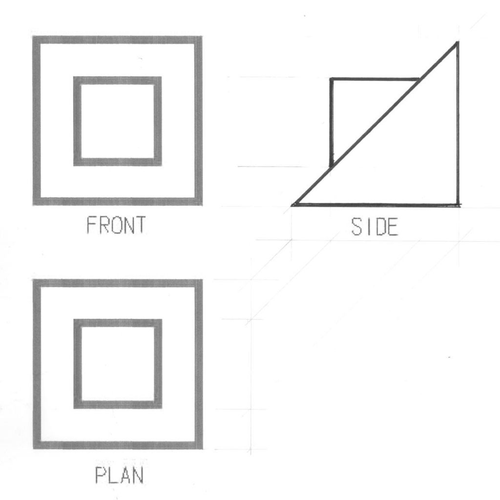

                      Hi, now that the cat has been let out of the bag for Sam’s test, I’ve drawn it for those who still can’t see it.
                      I must admit I did not get it without the explination that Geoff’s gave, although I had the idea that it was half of a sliced cube for the mnin part, it was the little one that stumped me. I should have attempted to draw it in the first place.
                      You may be able to see the projection lines which show how it was achieved.

                                With the cat out of the bag, Nick has shown one of the solutions and has clearly used 3rd angle projection.
                                Or has he?
                                Don’t take this personally Nick, because (I hope) I’m trying to bring attention to an important part of Terry’s original idea.
                                If it were (all) 3rd angle dangle, sorry projection, shouldn’t the small square of my original PLAN view be dotted? And where should the PLAN view be positioned to avoid this? In the words of `Top Gear’ James May “Oh cock!”
                                While, from a young age, I learned to draw in 1st angle (as a Pomme – English projection comes naturally), I have become `tolerant’ to 3rd angle projection, a method better suited to drawing very long objects such as aircraft and ships.
                                However, I still maintain (and have taught for many years) that 1st angle is by far the better system for moulds of the injection type. In the plastics industry (especially this country), countless drawings are constructed in 3rd angle, an Australian industry `standard’. Sadly, the views and sections end up in all sorts of weird positions, contradicting the basic rules of 3rd angle, and showing little to no resemblance of how the mould is positioned in the moulding machine. The primary desire appears to be to use up as much space on one drawing, with part of the mould sitting sideways on the bench.

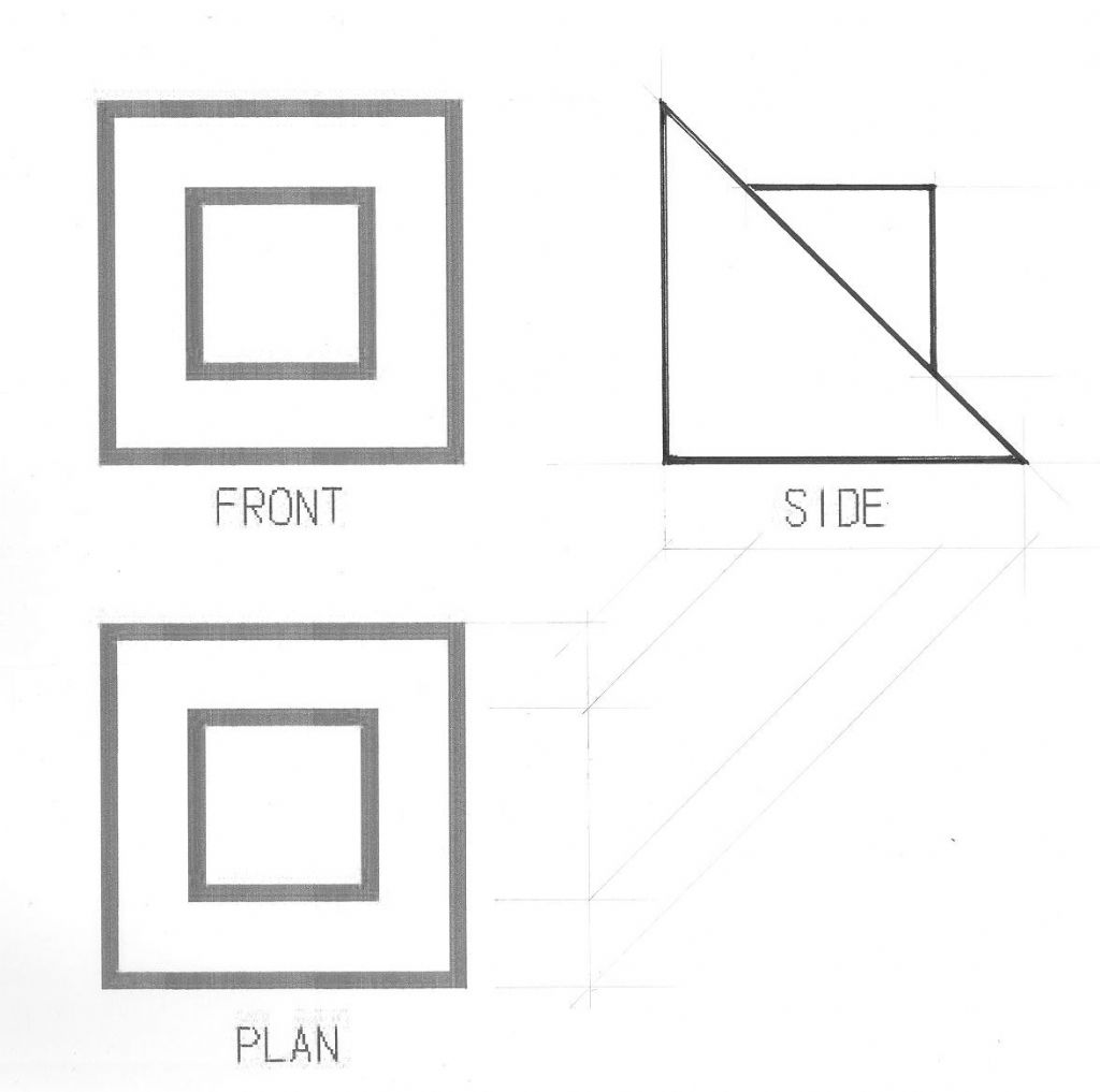

                                        Hi Sam, no offense taken, but as you say a clear case of understanding drawings. Quite wrongly I based my projection on the two sketches that Steve Granett posted and lost sight of the projection angle. I’m not blaming Steve by the way, but just goes to show we can all go back to school now and then.
                                        So for all those who are now even more confused here it is again in Ist angle projection. (I hope!)
                                        Regards Nick
