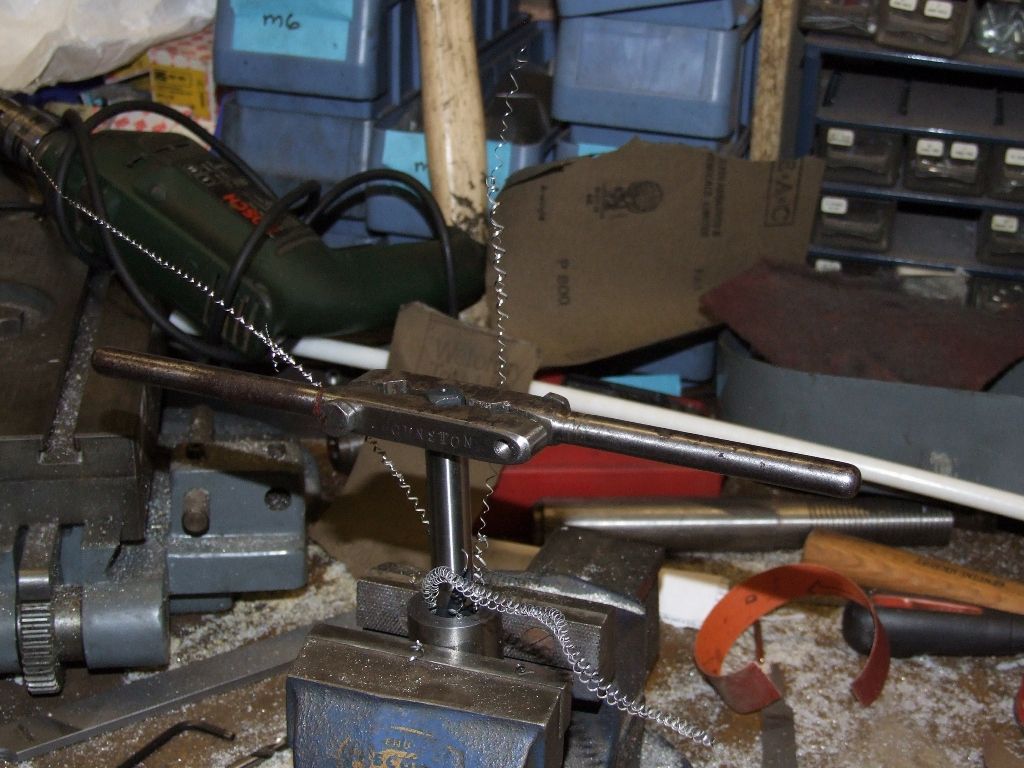

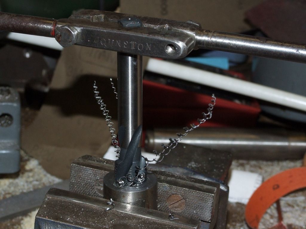

    Anonymous
      This is the swarf you get from a spiral flute tap in a ductile material (low carbon steel):
      The steel offcut will be a gauge for the screwcut external threads on the brass pipe connectors. The drilled hole is a little small at 17.5mm, but that's the nearest drill I could find.
      Note the name stamped on the tap wrench; made by my father as part of his apprenticeship at RAE Farnborough, probably around 1940/41.

                          And at the end of the tapping process the swarf is nearly a foot long:
                          I have a range of the T-handle tap holders and extensions, albeit from the cheaper end of the market. I used them a lot, but eventually found them rather heavy and, to me, clumsy. So I now use ordinary tap wrenches. I have a selection, custom made although not by me, ranging from 2" to 12".
                          When hand tapping a good finish on the part has the advantage that you see a reflection of the tap in the material. If the tap and reflection are in line then carry on, if not tweak the tap angle. Personally I've never bothered with tapping guides. Either I use the mill/lathe to start the tap, or I freehand tap with no guide and judge the angle by eye.
                          Andrew
