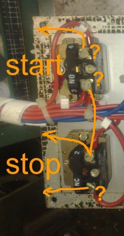

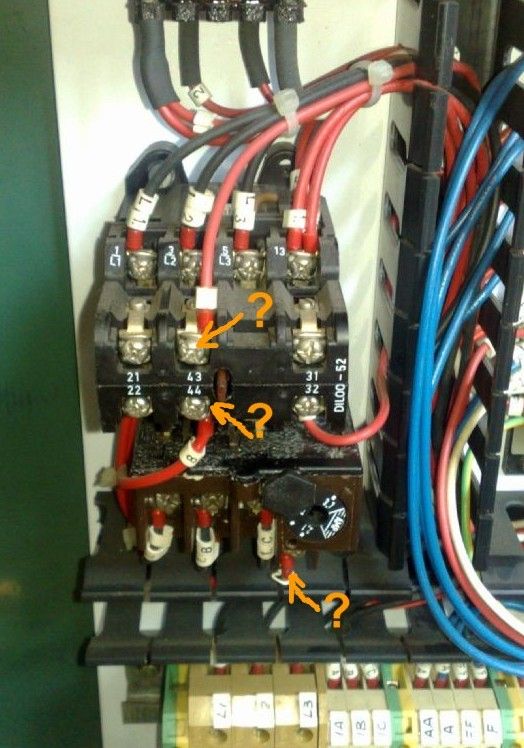

                                            I finally got the power feed working , i have upped two photos showing how, one of the three lives ran from L3 to L on the connections at the bottom. i disconnected this and connected a single phase live to the L connection on the right (beige coloured block) the neutrals are common as are the earths so these were connected also. With power applied the motor worked but only after the contactor in the second last picture was pushed in manually.
                                            The motor isn't that fast running , even with the rapid feed button held down , but hey it works and the limit switch mounted on the front of the table works perfectly too.
                                            So if anyone can tell me how do i get around having to push in the contactor manually ? can i do away with this component completely ?
                                            Thanks all .

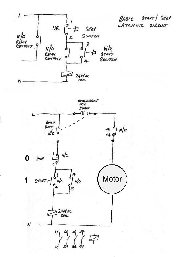

                                            #95759
                                            john swift 1
                                              @johnswift1
                                              Hi Ronan ,
                                              assuming the contactor has a 240V coil
                                              you should find the neutral is connected to one end of the coil
                                              and when you press the normally open green start button
                                              the live supply is connected to the coil via the now closed start switch , the normally closed stop switch and the overload switch
                                              once the contactor pulls in , a normally open pair of contacts wired in parallel with the start switch closes and maintain the power to the coil until the stop switch is pressed
                                              you need to trace the three wires from the start and stop switches to see how they are connected to the contactor
                                              hopefully my diagram will help
                                              Edited By john swift 1 on 04/08/2012 20:30:16

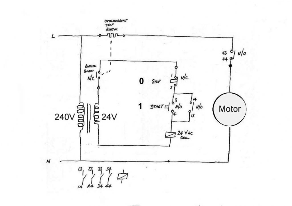

                                              #95764
                                              Les Jones 1
                                                @lesjones1
                                                Hi Ronan & John,
                                                I suspect the relay associated are 24 volt. It could be that the motor was powered from one phase and the transformer that is used to power the relays is fed from another phase. I may be necessary to connect your single phase to two (Or even all three of the phases.)
                                                Les.
                                                #95769
                                                john swift 1
                                                  @johnswift1
                                                  Hi Les
                                                  Good point about the transformer
                                                  the control could be more like this :——motor stop-start nvr 24v coil.jpg
                                                  john

                                                    Thanks for the trouble everyone has gone to on this , I have successfully managed to delete the wiring that was no longer required and the contactor block, the wiring comes directly from the rail on the bottom of the board, into the 240v-24v transformer on the top of the board, the power (24v) then runs back down to the rail connections , i didn't have to touch the actual electronic pcb's at all thankfully.
                                                    It all works fine now and i am very happy not to have to fork out for a new motor or vfd.
                                                    One piece of the contactor is remaining , i didn't know if i should remove it or not , advise please. Its in the last couple of picture i have just uploaded.
                                                    #95800
                                                    Les Jones 1
                                                      @lesjones1
                                                      Hi Ronan,
                                                      I can not advise you on removing that contactor just from the pictures. You would have to provide a diagram of the wiring to determine what iot does.
                                                      Les.
