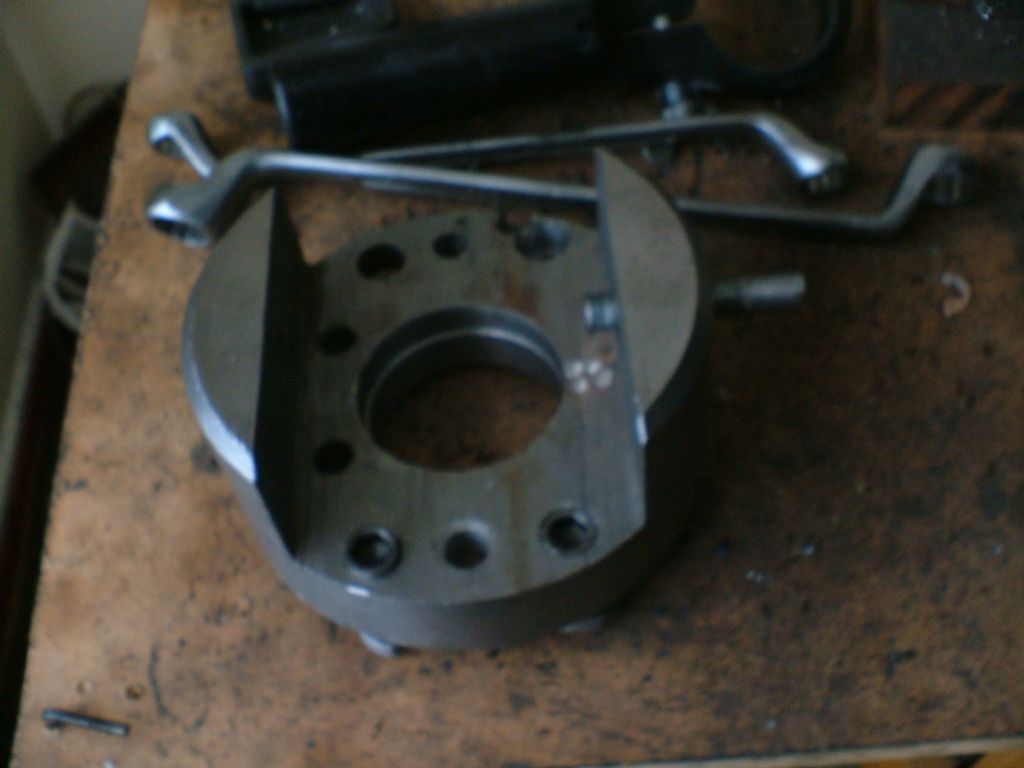

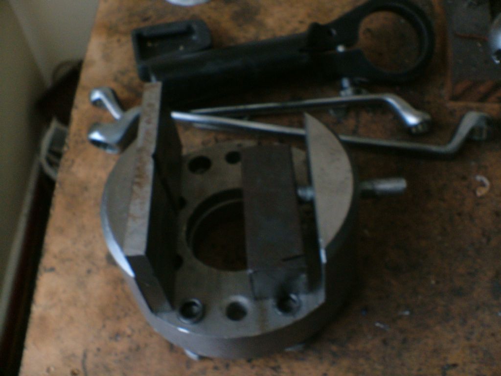

                                  I bought a 14mm set of tee nuts when I bought my new milling machine. The were a little too wide at the base to fit the T slots on the machine, so my first ever milling job was to reduce the width slightly. Fit of the narrower section of the T slot was perfect though. I don’t know how strong a standard exists on T nut/slot dimensions, or perhaps it does exist but is one of those that the Chinese manufacturers don’t apply very strongly. Easy job though and sorted now.
                                  As for needing a vice to make tee nuts, as said earlier, why not just drill the ends of a strrip and use suitably sized bolts for the moment to clamp it to the milling table?
                                  Studding, I guess it is very variable. Last studding I got I think was M8 or M10 – it was for making a small tool for pulling suspension bushes into place in situ on Mrs Sykes’ Fabia. It was stainless, and did the job okay, although I think it was on the limit of its capability. Other studding can be like toffee. I guess there is just huge variability.
                                  Ady – like the vice – any chance of a close up picture?

                                      Just simple coarse engineering, it takes up to 3 inches of stock.
                                      A 10mm stud is holding things at the moment, when it goes a 12mm will replace it and finally when I can be bothered I’ll fit a flush insert with a square thread.
                                      Squareness is the most important thing, which was all done in a single session on a shaper.
                                      Been fine for all my needs so far.
                                      Another advantage is it can be drilled full of holes to fit the shaper, cross slide or milling tables, which are all different dimensions, and with no loss of integrity.
                                      You can’t do that with cast iron, it would be fatally weakened.
                                      I use bits of square/flat stock and old vice inserts as required for jaws
