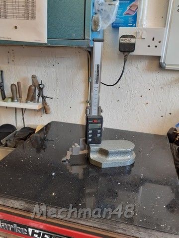

  • #476424
    mechman48
      @mechman48
      I have a Digi height gauge from M-DRO & a 18" x 17" x1.5/16" polished granite sink cut out from a kitchen manufacturer… free gratis after I told them what it was for.. suits me fine for the accuracy I need.. as for flatness.. measured with digi gauge from corner to corner ( 4 corners ) & measured to '0' with a 0.0005" fall off at one corner, just fine for me.
      George.

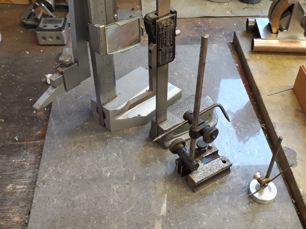

                Photo above shows the evolution of my marking out tools, on the right is a homemade surface gauge built when I must have been about 15 on the Unimat3, can't remember what I used it on but may have just been the formica worktop but got a Stuart 10V and Beam made with it.
                Next is a bought surface gauge that I must have got during the Minnie build and that would also have been use don some if the early Fowler TE too.
                The 6" digital height gauge was not brilliant with an uneven base and scriber that pointed upwards but a bit of work flattened that out, don't use it much now but it is handy on the mill when setting up a casting to check heights as it's small size fits under the column and does not need much table surface.
                The vernier one saw a bi step up in accuracy of my marking out though now not used so much as I tend to layout holes and faces with the DRO but it comes in handy some times and a few scribed lines act as a double check when using the DRO.
                Currently using a polished porcelain tile as a marking out surface, with a smallish shed it's easy to put it out the way if the bench space is needed and it also makes a good background for photos of small parts.

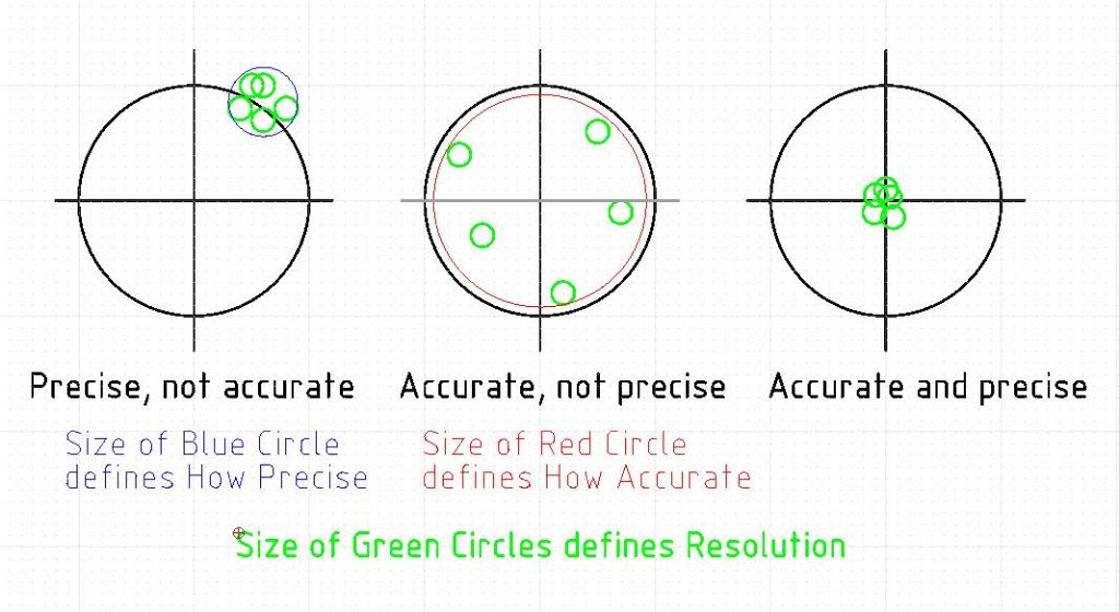

                                    Quite right! I hope it's correct, but this diagram shows how I remember the difference between accuracy, precision and resolution. Using a bulls-eye target to illustrate accuracy and precision came from Neil Wyatt I think. I've added resolution. Apologies for the colours; red's fairly obvious but blue isn't good on my screen.
                                    Resolution is how finely a particular instrument can read. It's not the same as the graduations, which are often over optimistic. However, assuming the operator has a good touch, successfully avoids parallax, and corrects for temperature, the resolution of a 0.001mm micrometer is limited by the state of its threads and anvils. The instruments ability to measure down to 0.001mm is compromised as it wears. Not possible to repair worn threads and anvils in a home workshop, and the professionals rarely bother either. It's cheaper to replace. Serious measurement requires ruthless reduction of all sources of error, and having a good looking but untrustworthy instrument laying around is asking for trouble. Calibration rejects are one source of ebay bargains.
                                    The diagram represents the actual dimension with cross-hairs. Ideally measurements would hit the bulls-eye every time but it's impossible. Minimising measurement errors gets progressively more difficult and expensive. Consequently engineers should be mindful that good enough is good enough. Time and money is wasted on a grand scale when quality is pursued without justification.
                                    The picture has three examples.
                                    On the left bulls-eye, the instrument gets close repeatable results but is persistently off target. It's precise, but not accurate. Not bad news though, because the error might be due to incorrect zeroing, and in any case precise measurements can be corrected by calibrating the instrument. I wonder how many forum members working to better than a thou bother to correct their micrometer readings, or even need to? But calibration and subsequent correction of readings is certainly necessary for serious measuring!
                                    The centre bulls-eye shows an instrument scattering measurements around the target. On average the instrument is correct but its individual readings are all untrustworthy. This is typical of practical measuring, and it doesn't matter provided the scatter isn't too big for the purpose. The instrument is accurate but not precise. Again, the scatter matters for serious work, but how many of us take the trouble in our workshops to average several readings before proceeding?
                                    The bulls-eye on the right is measurement heaven. The instrument reads accurately and precisely. But note that none of the measurements is spot-on. Magnifying this chart shows it has the same character as the central diagram, but the instrument is better because it measures with less scatter. Unfortunately this kind of performance is expensive to buy, tricky to apply, and expensive to maintain. Screw micrometers inevitably lose precision and accuracy because they wear slightly every single time they're used. For that reason serious micrometers are checked periodically against standards and dumped as soon as they exceed specified tolerances. The gauges used to check micrometers also wear, making it necessary for them to be regularly checked against even better standards and replaced too. At the top of the tree is the standard metre, defined from the average of several high-end atomic clocks. There's an enormous gap between the standard metre and my £30 micrometer! Fortunately for me, a £30 0.01mm micrometer is 'good enough' for my purposes, and I don't need to apply any of the disciplined methods made necessary by working to close tolerances.
                                    When buying tools I feel it's important to separate utility from desirability. Understand your reasons. On the down-side, a £30 micrometer looks and feels cheap. There's no pride of ownership in it and having to use it carefully wastes time! My workshop meets my needs but it wouldn't suit a time-is-money professional or the type who enjoys 'quality' tools.
