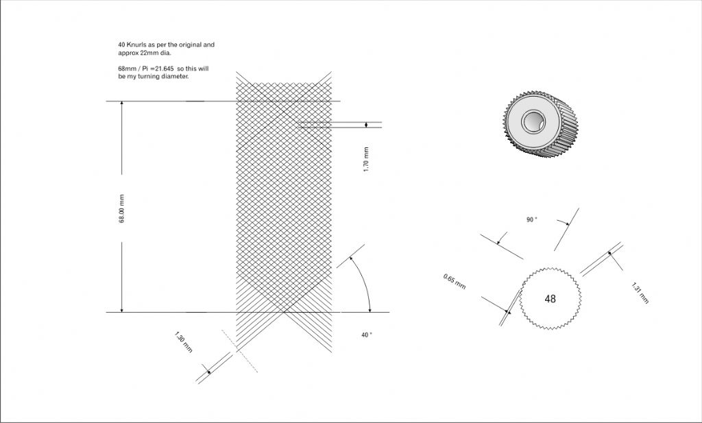

                            Thanks for the encouragement. I'm trying to reproduce some brass knobs which are volume and tone control knobs for a vintage guitar made in Japan. I apologise that this is not model related. I will get around to making a German loco at some point in the future.
                            I had some very helpful info from a gentleman at Accu Trak and also an offer of assistance from a British company. I also had a quote of $250 for one set of special knurls surprise
                            I have drawn out the 40° knurl pattern in CorelDraw with a spacing of 1.7mm vertically(across each diamond point) as it would be viewed in the lathe, known as the transverse pitch measurement to the knurling manufrs.
                            This then gives me a 1.30mm measurement from groove to groove at 90° to the groove (normal pitch). I've just received some silversteel from the posty so will have a go at this today.

                                    Thank you chaps, I didn't realise the tempering was so gentle. Instead of sand could I use brass chips I've collected from the lathe? I 've seen it used by watch makers on youtube for tempering spring steel.
                                    I've double checked my measurements and found the normal pitch is 1.3mm. I can always make another if I get it wrong. smiley
                                    Here's a drawing of the working out.

                                            Started to make the custom knurl yesterday. It's taken about 4 hours to broach almost half way around the 20mm silver-steel. I must be mad! smile p Here's a photo, plus a couple more of the basic indexing setup.
                                            Ed.
                                            #192703
                                            Ed Duffner
                                              @edduffner79357
                                              I managed to get to the end of the broaching and it seems to have gone ok smile . From the original 19.96mm diameter I lost about .08mm in the process and the knurl meshes into the pattern on the original parts quite nicely.
