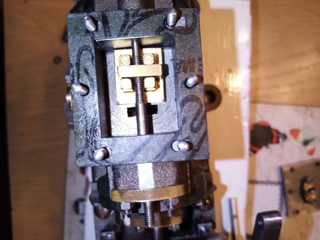

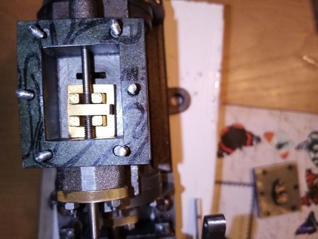

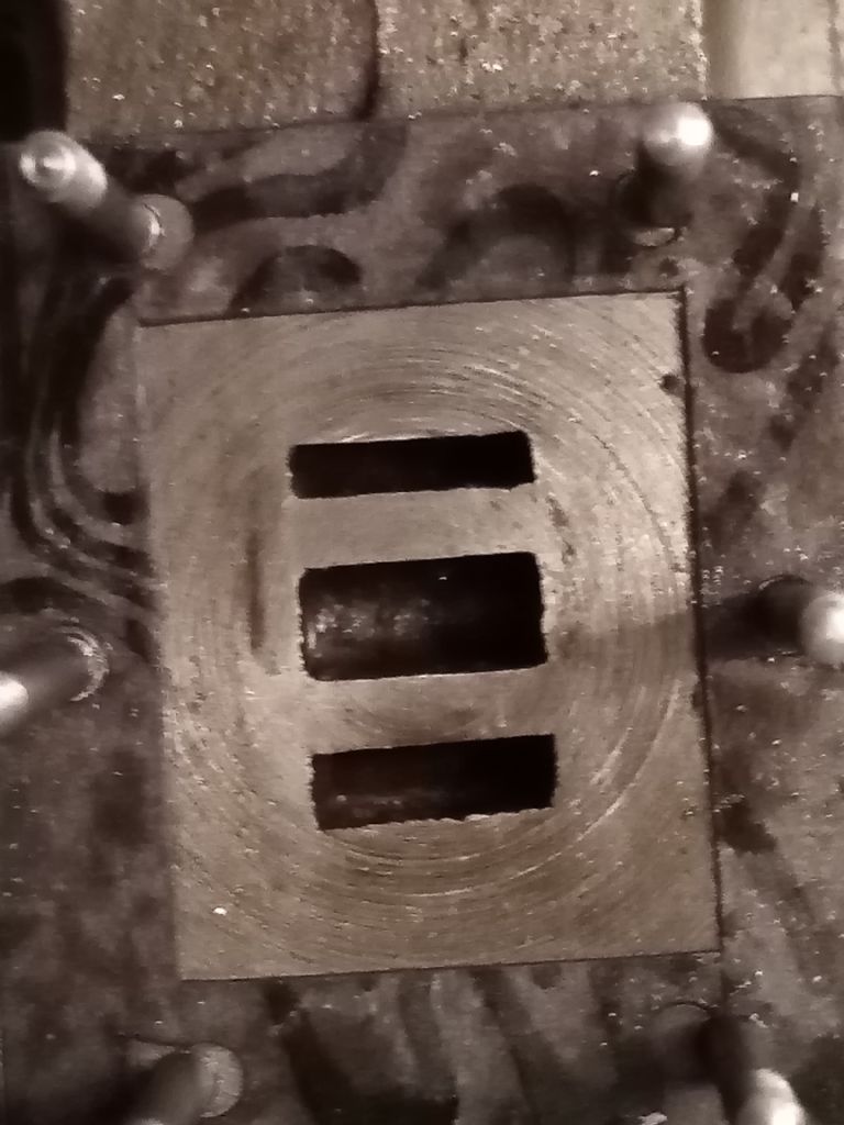

              img_20210225_231228.jpgimg_20210225_231214.jpgimg_20210225_231018.jpgHi
              Duncan/Chris. Thanks for clearing that up.
              Can you have a look at these pics and give your opinion on them as to whether this is the norm or not.
              The forward port is slightly larger than the rear but its the positioning of same when piston is fully extended/retracted, how one has a bigger gap to the slide valve than the other
              Edited By Arthur Goodwin on 26/02/2021 18:09:19
              Edited By Arthur Goodwin on 26/02/2021 18:14:41
              #530376
                Provided the valve covers both ports when in it's mid position the engine should still run and will just need a bit of playing about with valve rod length to get both strokes even.
                You may also want to give the port face a gentle rub on some wet & dry laid on a flat surface to get rid of the remaining machining marks so you don't get any leakage.
