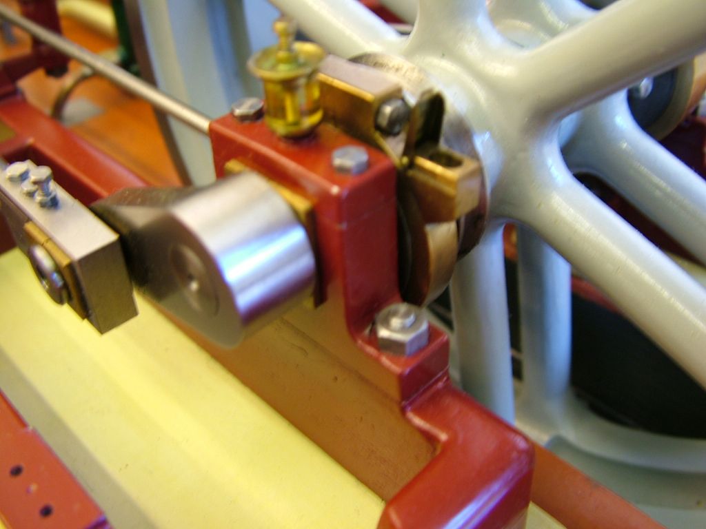

      Ramon Wilson
        @ramonwilson3
        Posted by JasonB on 13/07/2022 17:09:35:
        Put them in a cupboard and start from scratch, those look to be 7/8" ctr height ones not 5/8" that you want. It will be easier than trying to cut down and reassemble what you have.
        Well yes, can't disagree with that but you did ask about the castings!
        Much easier to make two pedestals and caps from scratch in mild steel or cast and then make split bearings to suit, fundamentally as described above. I have quite a few images covering the latter from a previous thread if you want

            Thanks Ramon, but I'm confused – if that's a Twin Victoria, how come it's got what look like 5/8" centre height pedestals combined with what look like the original kit cylinder mounts?
            Or are they 7/8" centre height? The Stuart Models TV instructions say they're 7/8" – the ones I've got – as Jason said…

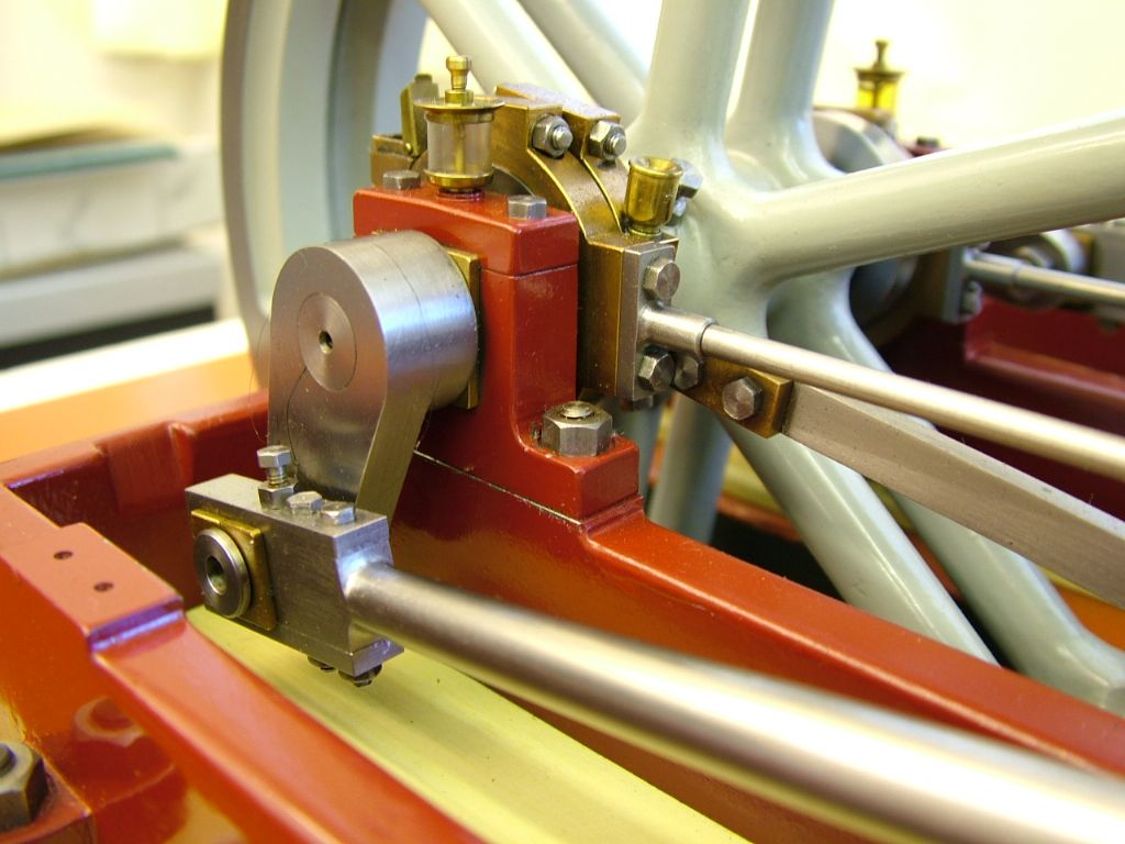

                    Doc, I made my Twin Vic many years ago. Apart from a small twin oscillator it was my first engine built and successfully finished – the first, a ST Compound Launch engine, was doomed from the outset due to lack of knowledge and skill at the time.
                    The exact date I'm unsure of but I do know I bought basic Twin Vic castings along with the drawing (which I still have somewhere I think ) when Stuart Turner traded from Henley and before they had the big hike in prices. Late seventies/early eighties perhaps?
                    I only bought the minimum of cast iron parts and not all of them at that – as best I can recall just the bed plates, cylinder blocks, piston rod end cover and valve chest and of course two flywheels. Everything else was made from scratch including those bearing pedestals which I'm pretty sure I made from mild steel. The bearings were from bronze and split. I always thought that the bearing housing make up was too 'thin' and were I to do another would bond on a plate to the sides of the bed plates to increase the potential width to mount wider bearing housings. I have no recollection of changing the design height of the bearing.
                    The original model engine was based on a quite small industrial engine that was found in an old premises I believe. Stuarts twin version was their idea of a potential engine that may have been offered by the manufacturer. Indeed quite a few did do this and I have a few reprints of old catalogues that support this possibility.
                    To use the parts to make a representation of a larger, heavier (full size) engine however there are areas that have to be improved not least in stature – the bearing supports are one. I often looked at the engine in hindsight and wished I had done that.
                    I've already mentioned to you the flywheel grooves – if done to print they are well over size for the size of engine but if done smaller and too many are put in then you increase the scale proportionally to the rest of the engine too – the engine becomes much larger and some areas are then truly undersized.
                    As Jason suggests, personally I would write the castings off at this stage – keep them for something else perhaps. Make new pedestals/housings from mild steel or the bit of cast you have left from the covers and make the bearings from bronze – even brass will do but bronze would be better. Using the yellow coloured cast bronze and not the pinkish drawn bronze will ease manufacture considerably.
                    Without looking I'm not sure what those drawings say about the crank relationship but I know I initially made it with the cranks at 180 degrees. Why I do not recall. When I first exhibited it at the Forncett Industrial steam museum however the owner commented on that irregularity immediately. Suitably chastised, once home it was immediately stripped it down and the crank shaft changed to the correct 90 degree relationship.
                    In the builds since that time then I have tried to incorporate full size characteristics where possible.
                    Hope that helps ease the confusion

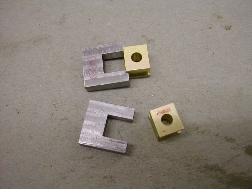

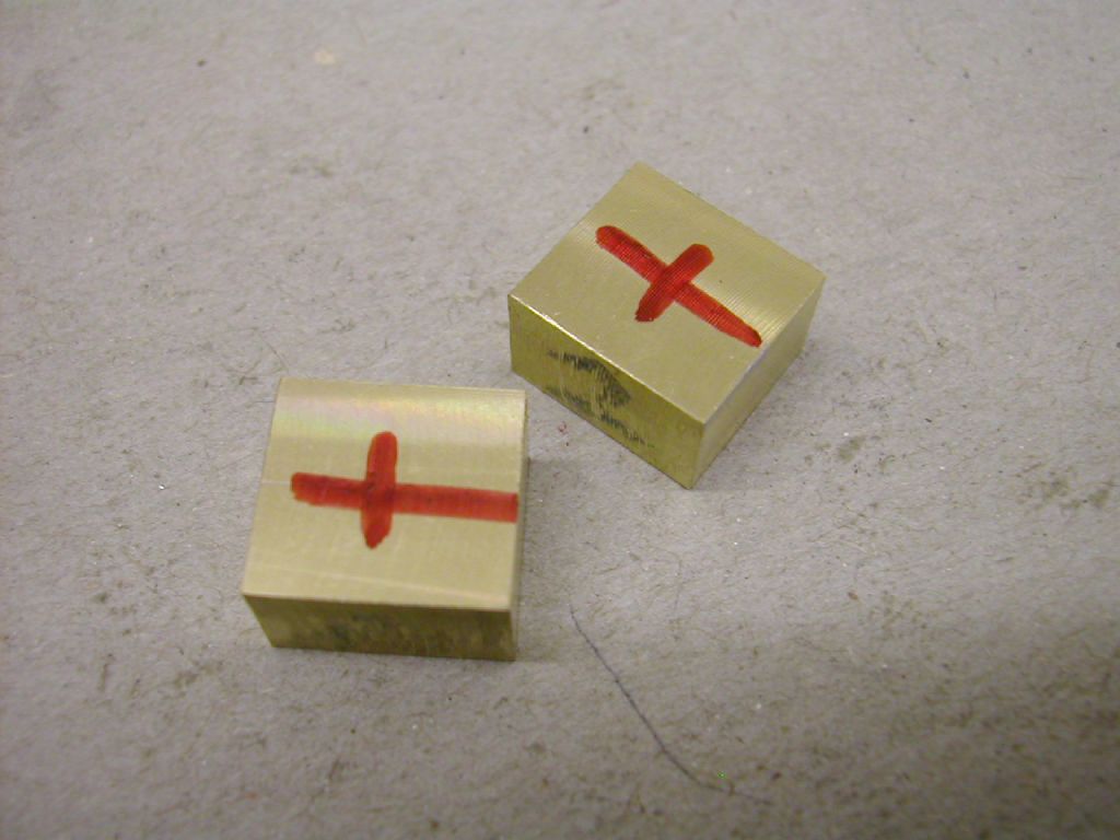

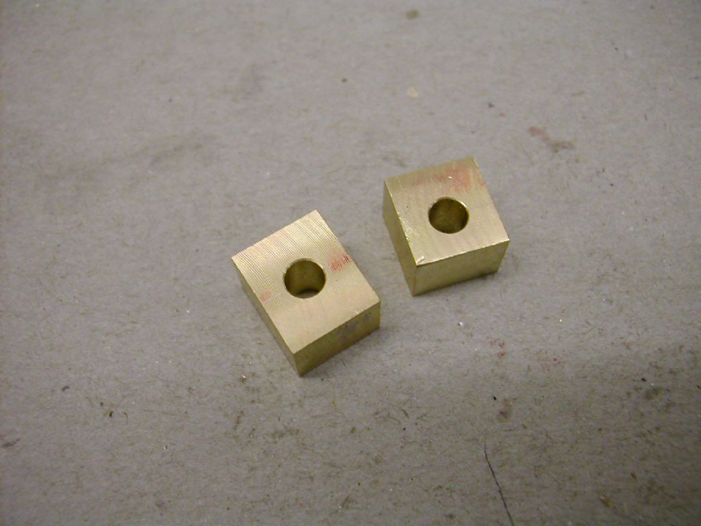

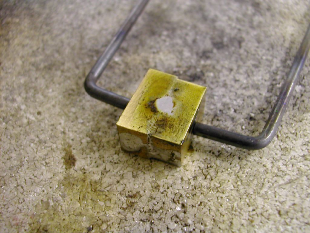

                                Ramon Wilson
                                  @ramonwilson3

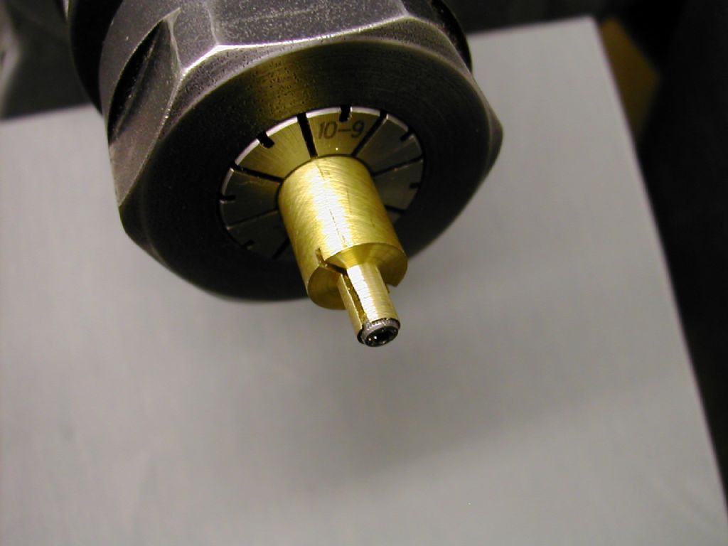

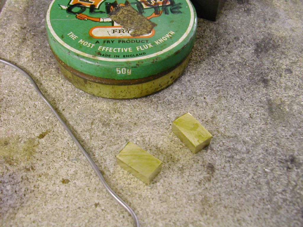

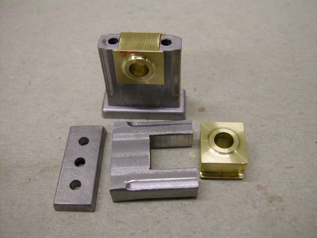

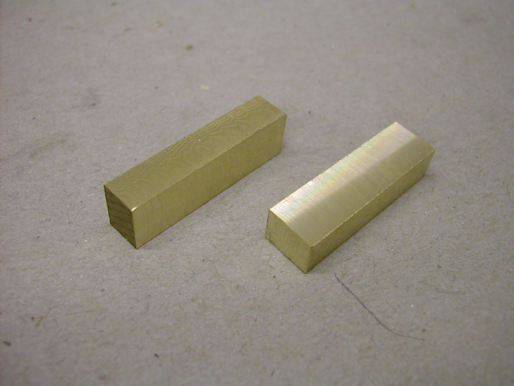

                                  Hi again Doc,
                                  I have just created a new album with a series of images for making split bearings in my albums but will post a few? of the basic ones on here as it's relevant to your question – hope that's okay.
                                  You can make split circular bearings but these would not be true to prototype on the size of bearing you wish to represent. Split rectangular bearings are not exactly scale either but are much closer!
                                  Once you have established the dimension you require cut and mill two blocks to overall dimension plus 1mm and long enough to cut into two to give top and bottom pieces
                                  Cut apart and face the sawn edges but do not worry about exact dimension at this stage. Make all blocks the same or at least the two lower blocks and note down the dimension from the split face to the lower surface . Then tin both parts on the split line face ready to solder together.
                                  The parts need to be held together but not clamped. I use a spring clamp made from a piece of 12 swg piano wire. Lay the parts on something flat that will not absorb too much heat and make sure the flat plane is uniform. Heat until you see the solder line go bright and drop a small amount of solder on to be certain.
                                  Clean the blocks of flux then mill the outsides true except the lower face. From this you know exactly where the split line is located so set in the mill and drill bore etc for the crankshaft.dscn3744.jpg
                                  Mill the outsides dimensions to the bore so they fit the pedestals
                                  Then finally make up a simple expanding mandrel to hold them for facing the outsides. This is quite a small one as these bearings were for the layshaft on the Waller valve gear but the principle is the same
                                  As said there are more images in the album which should be self explanatory but if you're not sure about something just say.
                                  Hope that helps – R

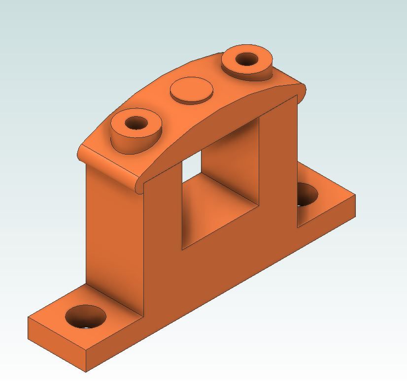

                                    You could actually make use of the lower castings if you went with a square bearing as the "cut" is higher up so the extra 1/4" you have to play with would be just right. Then either a simple rectangular cap like on Ramon's engine or you could get the rotary table out for something in keeping with an engine of this size.
                                    What size did you tap the bed casting, hopefully not the rather large 2BA.

                                                  I think using some spare 3/8" aluminium for both parts is probably the best option as it saves having to form the hole in two separate metals which the problems of drift that can cause. As you are likely to end up wanting to machine the whole of the cap anyway there is little reason to use the casting and working with rectangular blocks to start will will make critical machining easier then the fancy shaping can follow.
                                                  What do you have in the way of bronze in stock, round or square/rectangular?
                                                  Also do you have a 1/2" milling cutter or reamer?

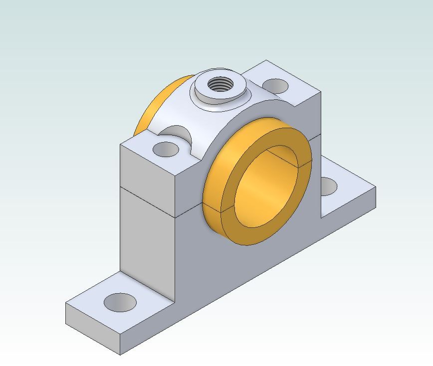

                                                    #605911
                                                      This is the Princess one Modelled and shown with separate split round bearings. Let us know which way you want to go with final shape and preferably all new material before We spend time describing other options.
                                                      I've also added an image to show how the bearings can be turned from two rectangular sections soldered together, length enough for two plus something to hold.
