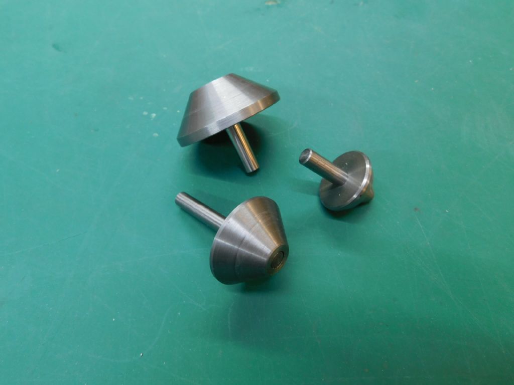

                                            Yes each to his own Jason but using an edge finder as such does not show you the degree to which you are central to the hole.
                                            Doc – getting a rotary table close (within a couple of thou) and objects on a face plate for that matter for using a DTI is easy if you make something like these 'centres'dscn0067.jpg
                                            They are mild steel firmly mounted on hardened dowel pins held in a collet and the taper turned. Hold in a drill chuck or collet and bring the spindle down so that the cone gently touches on to the RT hole rim. It's surprisingly easy to move the table to allow it to seat firmly. Zero up then remove and fine tune the position with a DTI
                                            On the lathe they are ideal for holding something with a bore against the faceplate whilst clamping, again final tuning with a DTI.
                                            Hope that's of use

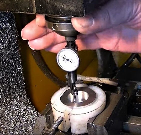

                                            Emgee
                                              @emgee
                                              This is a model engine backplate with 4 hole fixings that has been turned for a very close fit in the crankcase so to make sure the holes are drilled in the correct place I use an electronic edge finder first and then check with the lever gauge to make sure, if care is used with the edge finder adjustment is usually only .02mm or so.
                                              Emgee
