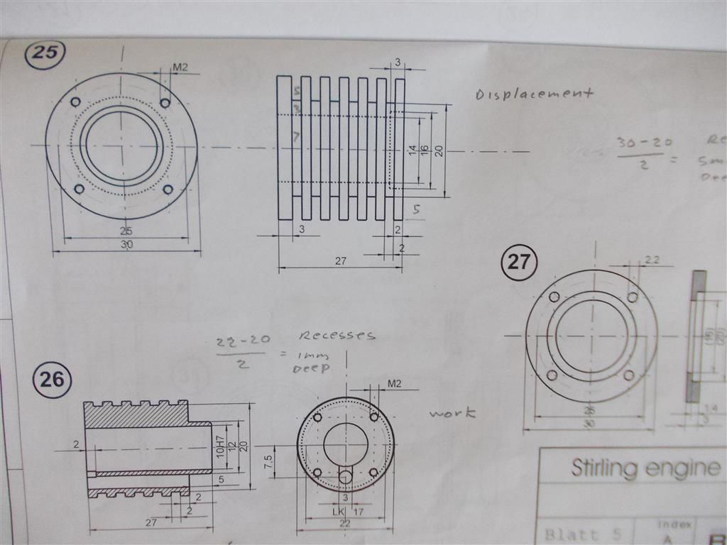

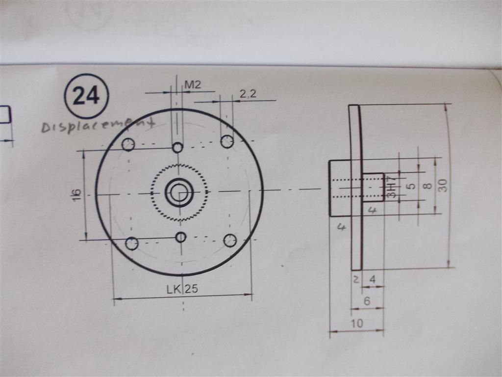

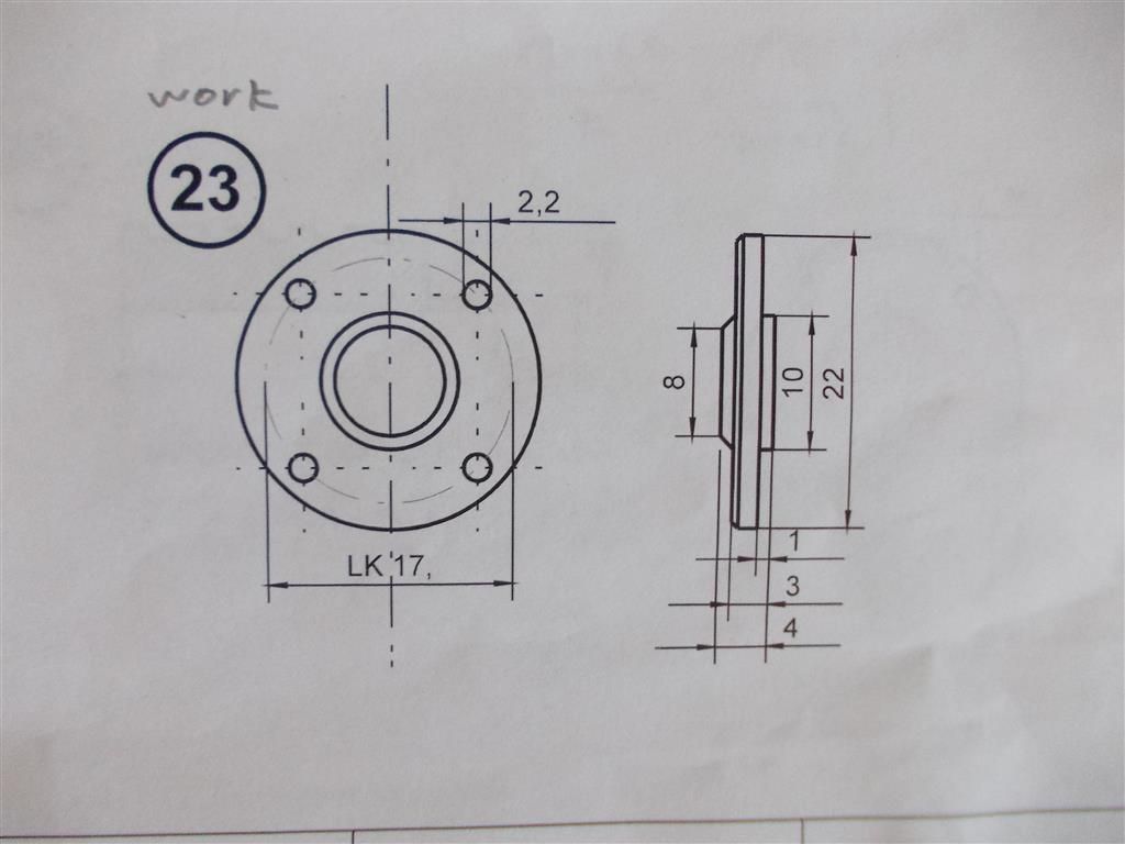

              I made a start on the cylinder covers today but I am having some problems working out the correct order of operations. How would you tackle parts 23 and 24 ?
              I am also puzzled by the measurement for the displacement cylinder cover (24) where it says 8mm diameter. If this is to fit in the displacement cylinder then I would have thought it should be 14mm (see part 25) ?
              NOTE : I have just worked four night shifts so maybe my brain is a bit fuzzy : )
              #215245
                Part 23
                Hold material in 3 jaw, face off, cut the 10mm x 1mm spigot, turn outer dia if required, saw/part off.
                Ideally use soft jaws but a syou don't have these put packing between chuck and work with the just machines face against packing – remove packing before turning on. Face to length, using a tool with 45deg face cut the 8mm decorative spigot, chamfer the outer edge. Mark out 4 lines while held in the lathe and also the hole PCD.

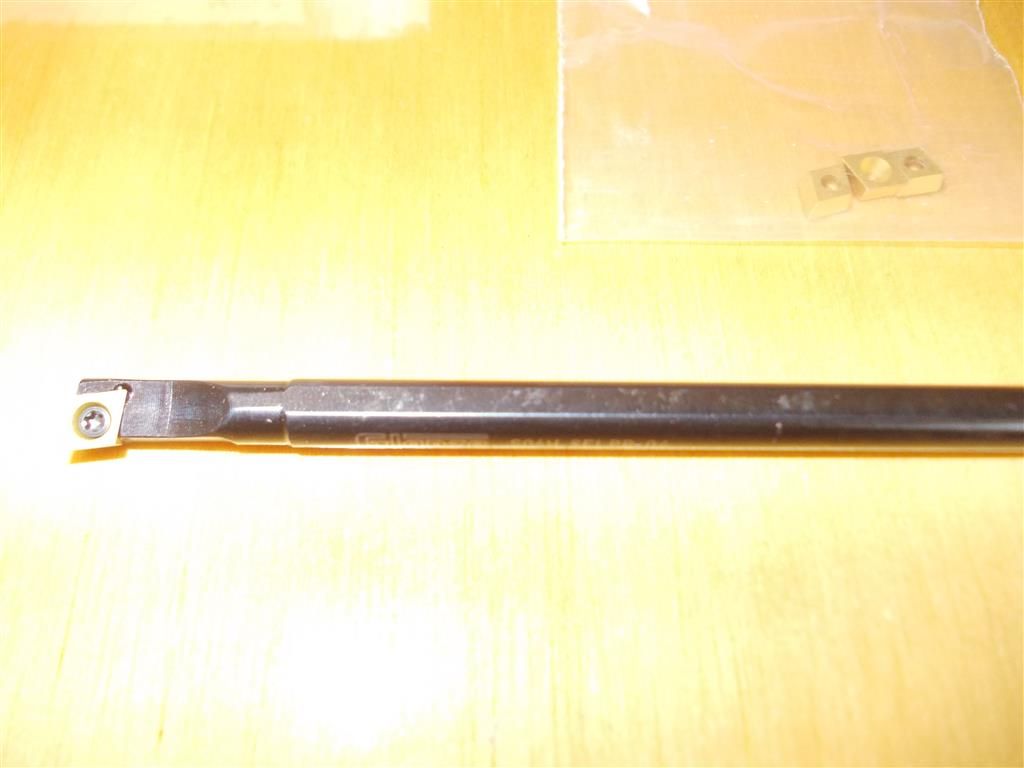

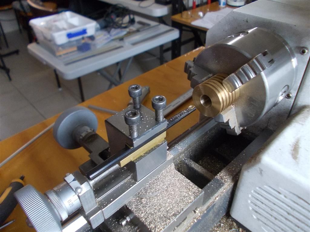

                  I have been in Brisbane for the last nine days and now I am back in Cairns so it time to get back on the lathe.The boring bar arrived yesterday. I had assumed that this could be held directly in the tool post using suitable packing to raise it to the correct height. But now I have a feeling that this should be mounted in a special holder. I just cannot get it to sit right.
                  Edited By Brian John on 19/12/2015 06:24:26

                    Not sure what you mean by sitting right, the flats on the bar will set the insert to the correct angle. You may need to set the tip slightly above centre line though. I would also suggest a bit of packing on the top face of the bar, it will quickly get chewed up by the clamping screws otherwise. Boring bars need to be set to the minimum necessary stick out for the job being done. This means a lot of clamping and releasing to damage the bar if not protected.
                    If you are using a boring bar with an insert close to the minimum diameter it will fit in you need to look at where the bottom corner of the insert is to make sure it is not rubbing, this is why the tip needs raising sometimes.
                    Martin
                    #216989
                    Brian John
                      @brianjohn93961
                      The insert is not sitting horizontally. I will put some packing on the top as you suggested. Perhaps the clamping screws were throwing it out of alignment.
                      Why does the tip have to be set slightly above the centre line ?
                      #216992
                        Brian the insert should point down, the flats on teh toolholder will be level when clamped.
                        I set them so the point of the tip is on ctr line then you can face across the bottom of a blind recess.
                        Edited By JasonB on 19/12/2015 09:41:30

                          The tips should be a SLIGHTLY above centre so that if the bar bends it doesn't dig further into the work making it bend more and dig in even further etc. This is the opposite of turning outside diameters where if the tool bends at all it takes less material providing it's exactly on or a little below centre. Here it's more a case of setting slightly below centre to be more sure that it isn't above. Just good practice in other words unless some one wants to deliberately turn with the tool above centre.
                          Boring bars are far more likely to bend so are more critical in this respect. The amount needed depends on the bar and on the size of the cut.

                            Oh, so it IS supposed to be tilted like that ? Thank you…..I thought I was doing something wrong.

                              John as these are the standard SCLCR type tools which are designed for boring and facing how do you manage to take a facing cut if the tip is set above ctr height? Running above ctr is a sure fire way to chip the tip as it gets pushed up by the cone left in teh middle of the work.
                              You would not be able to make cuts like this with it above ctr
                              #217045
                              Ajohnw
                                @ajohnw51620
                                I see them as more for facing shoulders in bores Jason not facing the bottom of blind holes. However on a shallow one such as you show there would be little overhang and not much chance of the tool deflecting.
                                I can think of a number of occasions when I have had to set a tool significantly over centre just due to the size of cut being taken and the size of the bar that has to be used so even the term SLIGHTLY needs qualifying. I would generally see it as meaning thou's when boring or during straight turning. When boring deflection can introduce chatter but often the best solution is to turn the speed right down.
                                All messed up when deliberately turning well above centre using tools with excessive amounts of clearance but that is a rather specialised subject and needs a pretty rigid set up. That is the other aspect of tool setting. Below centre reduces the clearance angle when boring. Above centre reduces it when turning. This can be pretty critical on low diameter parts

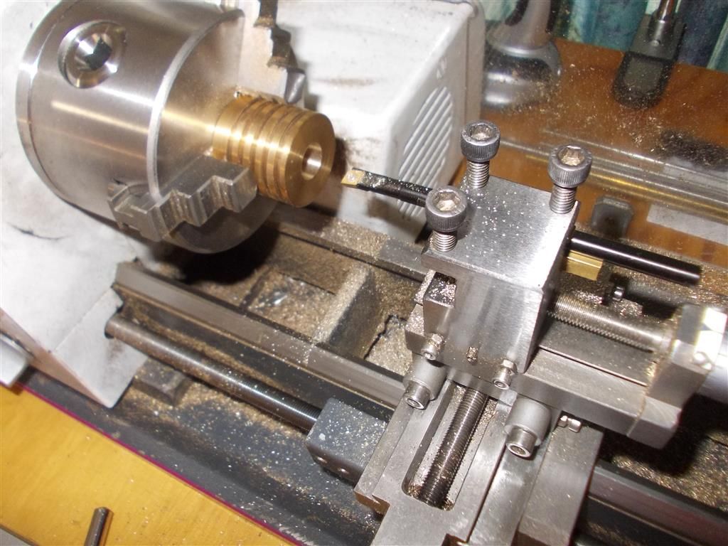

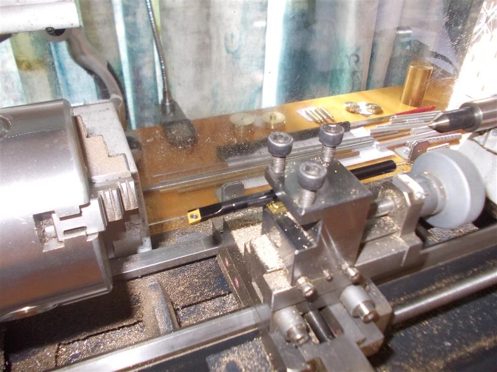

                                  Well, that went very well : my first use of the boring bar did not throw up any real problems. I used a piece of 6mm brass bar that came with the stirling engine kit to jack up the height and I put one shim underneath it to raise it slightly above centre and one shim on top of the boring bar to protect it as per the above advice.
                                  I was not getting a smooth finish with manual feed but the auto feed gives a perfect finish. I made the recess on the top of the cylinder too wide at 17mm (supposed to be 16mm). I am not sure what went wrong there ! Anyway I can just adjust the collar to suit when I make it.
                                  This is also my first use of an indexable tip. They do cut very nicely.
                                  NOTE : where can I buy 6mm square brass bar in Australia or the UK ? My usual suppliers only have 1/4 inch X 1/4 inch. I will need more for the Stirling engine kit as not enough has been supplied.
                                  Edited By Brian John on 20/12/2015 06:27:15
                                  Edited By Brian John on 20/12/2015 06:52:35
                                  Edited By Brian John on 20/12/2015 06:52:52

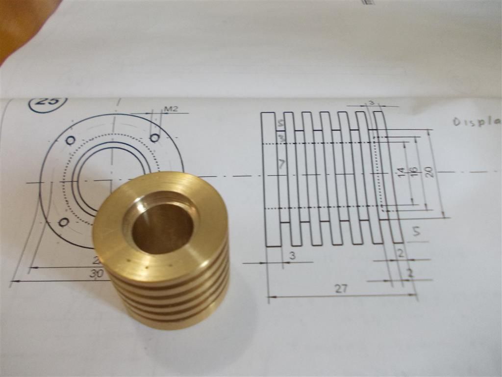

                                    Brian, you should have more than twice the amount of 6mm square that you need in the kit. It's only used for parts 12 (12mm long) and 18 (6mm long) and my kit came with a piece about 60mm long.
                                    I've been following this thread with interest as I am also in the middle of building one of these – my first attempt at any form of model engineering in about 40 years. I was also confused by the boring bar tip angle, but I have a friend who is a 'proper' engineer who put me right.
                                    You may have to have a think about the recess that you've made 17mm instead of 16mm – it retains the O-ring that forms the seal for the glass cylinder. Even at 16mm it's not a tight fit!

                                      Thank you for that Andrew. I was not aware that the recess was for the O ring. I will have to do it again. I always expect to make at least two attempts before I get it right which is why I need the extra brass

                                              Andrew : I have just looked and there are two O rings in my kit but they are both 20mm in diameter. They do not fit in that recess as they are too big for either 16mm or 17mm. How big are your O rings ?
                                              My instructions say '' part 42  1 X O ring glass tube 16mm 2mm filament''. I definitely do not have that. They are easily obtained on ebay though.

                                                Brian, I also had two in the kit and they are indeed 20mm x 2mm. I confess I didn't measure the O ring, I just shoved it in the recess – it fits, and gives the seal a bit more bulk.
                                                I've just checked the drawing, and the recess in the cylinder cap is 20mm, so the O ring sits nicely in the cap and I presume then distorts down into the cylinder recess to effect the seal. So I apologise for sending you off on the wrong track – the recess in the cylinder cap is to house the O ring, which makes the recess in the cylinder a lot less critical.

                                                  I bored out another displacemnt cylinder today and I also made the collar for the glass tube (part 27). These boring bars are useful things : how did I manage without one !
                                                  1. I must admit I am a bit puzzled about the 16mm recess in the displacement cylinder and the 16mm recess in the collar. Is this just to take the excess from the O ring ?
                                                  2. If you had to make a cylinder with a 10mm bore, what would you use : drill to 9.8mm and ream out to 10mm or a boring bar ?
                                                  Edited By Brian John on 21/12/2015 06:11:25
