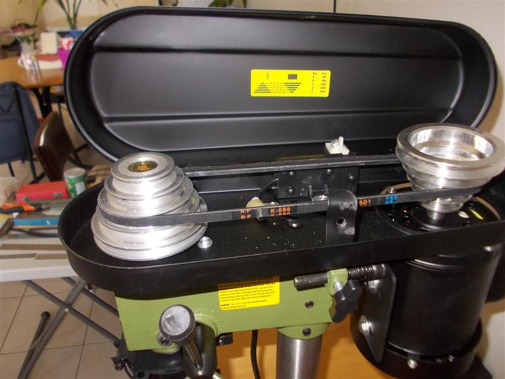

                                                    Allied bearings do not have any machine vices with the horizontal and vertical notches. I thought these would be essential for a machine vice ?
                                                    I set up the drill press today and tested it. I will have to return it as there is excessive vibration in the motor and the chuck moves slightly to one side at the bottom of the throw. What is the part just below the pulley housing ; it has a wing nut on a spring loaded bolt which pushes against a plate ?
                                                    What is an acceptable speed for drilling metal ? It is currently set on the middle speed 1220 RPM.

                                                    #208155
                                                    Speedy Builder5
                                                      @speedybuilder5
                                                      BJ, that bolt / spring is there to reduce vibration. When you change belt position, First slacken off the wing nut to allow some slack in the belt, change the belt position and then push the motor in a direction which tightens the belt, then do up the wing nut. On new machines, often the belt is a bit "stiff" and the spring / plunger AKA bolt are not strong enough to correctly tighten the belt.
                                                      Some of us slacken the wing nut at the end of the day, most of us forget!!
                                                      As for speeds, just look up drill speeds on this site or internet. They will vary due to size and material – also lubricant and type of drill.
