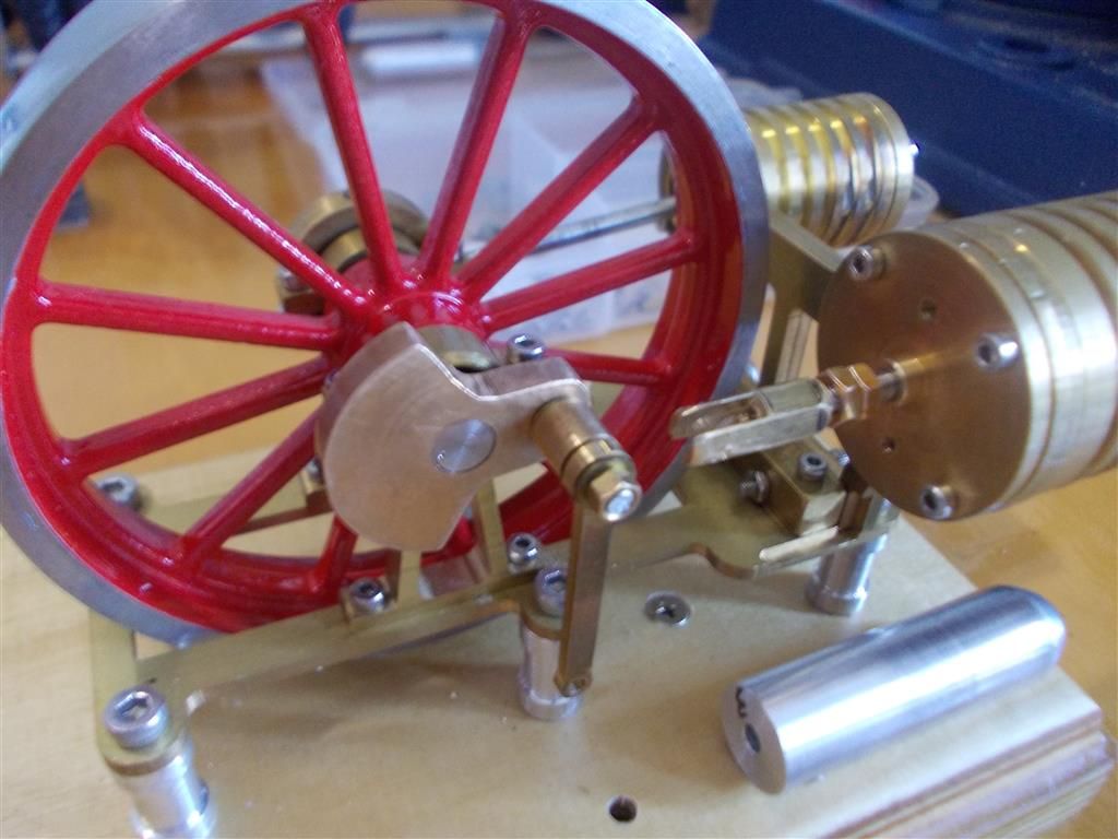

      I just performed an interesting experiment : removed D. piston connections to the crank but left D. piston in place at BDC with glass tube over it in the usual operating position. Turning the flywheel by hand, the work piston forced enough air through the system to gradually move the D. piston up to the end of the tube by about 2mm per revolution. So I think all the airways are clear and operating as intended.
      I am almost finished the single rod/clevis conversion so I will try that first. I am curious to see if it makes any difference. If I have no luck there then I will return to the initial design.

        I stuffed up my first attempt at the clevis : the M3 thread was not cut square when I tapped it by hand in the vice so I had to make second one. This one was tapped using the lathe to keep it square which was a success. I then redrilled the first clevis to 2.6mm ( correct tap drill is 2.5mm) and retapped it in the lathe with the plug tap and this worked. The thread is now square so I have two clevis. (What is the plural of clevis…clevii ?)
        I will assembly it tomorrow and work out the correct length for the D. piston connecting rod. I put an M3 thread on the connecting rod today using the lathe and made the thread long enough to take two adjustment nuts.

            I can see one major problem with that last set up, the pivot point is too close to the crank to fit a working con rod, the pivot point has o be the same as the original.
            You mentioned how the displacer move when it was disconnected, and the piston was moved. This is the basis of the Ringbom motor, in this motor the displacer is not connected to the crankshaft, the only thing that is different is that the displacer rod is quite a bit larger, up to about 1/3 the bore of the displacer cylinder, I'v built three of this type, not over powerful, but they will run in either direction.

              Howi : that experiment was with the largest diameter piston (12.9mm). I have made three of various diameters. The correct diameter is 12.5mm. It was only an experiment to test for air leaks. I am sorry that I did not explain that better.
              Ian : Yes, I see what you mean. I am using the same connecting rod from the original design. The clevis is too long and there is no room to fit a shorter one.
              I think I will have to remake part 24 (D.cylinder cover). I really think this is the main problem. I have run out of other ideas !

                Your problems might just be a bit of binding due to things not lining up Brian. That sort of thing showed up when you ordered new ball races. For those to work as they should the pockets they fit into need to be perfectly axially aligned and square to each other. Same with the con rods. In that case the holes in each end need to be on the same axis, same distance apart when there is 2 on the same journal and their sides need to be square to the holes too. This sort of thing is why asked if your drill table was square to the drill earlier. Few are worse luck. Usually it's possible to square them up one way and the other may need some thought as to how the work is set in a vice and it can be impossible to do that. If this is one of the problems the easiest solution would be to easy the holes a bit and if possible ensure that the holes in the 2 are the same diameter and the same distance apart.
                This sort of problem has cropped up in some model engineer mag projects in the past and if extreme they have suggested drilling in the lathe. There are 3 ways of doing that. One is holding them on the face plate but that needs the face plate balancing. That's not too bad on small light things as one clamp will hold the work and another can be fitted just to balance things. The other is a drilling plate in the tailstock. I've been looking for one for years. All that can be bought is cross drilling jigs and they are too small to hold things down on. They aren't much good for cross drilling either really, no clamp and the V is usually too small. The other way is some sort of holder in the tool post. It can be fly cut from the chuck to get it square on. I have done this at times using a lash up to allow me to jig bore pretty accurately using the cross slide.
                The other aspect which you probably have thought of is to make matching parts in one go. Take the double con rod. Drill ream one end of each, fit a tight fitting dowel and then do the other ends together. If these are the problem you might cure it by simply relieving the holes a bit.

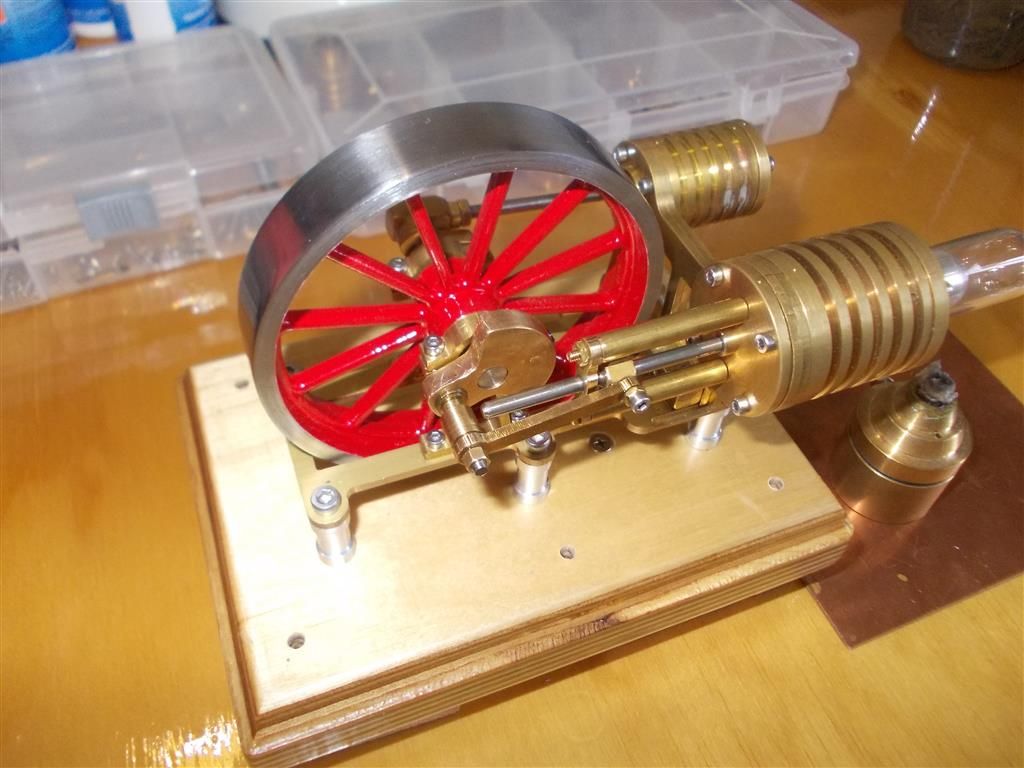

                    Very frustrating : I have pulled everything apart, polished many parts with 2000 grit wet and dry and then reassembled the engine with only one con rod. I have oiled all moving parts despite the advice to the contrary as I am running out of options. I am not happy with the supplied bearings but the replacements bearings have not arrived from Hong Kong yet so I will have to stick with what I have.
                    Things are running much better now. I am getting  8 revolutions when spinning it by hand with everything connected (one con rod on the D Piston). When the burner is applied I am getting about 16 revolutions. I am sure it is not my imagination It really wants to run but something is stopping it. Possible solutions are :
                    1. It is very hot here today, especially inside the house (about 40 degrees C). The work cylinder gets hot very quickly ; there cannot be too much of a temperature difference between the two cylinders. I might try again later tonight when the air con is on.
                    2. The supplied bearings are not up to scratch. You might remember that I have put shims between the bearing supports and the covers to stop the bearings being crushed out of shape. It could be that before I inserted the shims that I damaged these bearings when tightening things up the first time. Nothing to do here but wait for the new ones to arrive.

                      Apply soapy water to all the junctions? Seal leaks with silicone.
                      If you have a dremel type tool then use the rubber mandrel in the kit agaist the flywheel to spin it up for a while?
                      Ice the cold side?

                          Perhaps a cork gasket between the work cylinder and the cylinder holders (frames) ? This might stop a lot of the heat being transferred from the D cylinder to the work cylinder. We will see what happens tonight after the air con has been running for a few hours.
                          A gasket  on the D cylinder would also minimise heat transfer to the other side. There are still many things to try yet.

                            I was laying on a bit thick with the alignment of things Brian. It all comes down to clearance between them to some extent but there will be limits on that too. The alignment needs to be better than the clearance otherwise there wont be any.
                            The problem with ball races is that they have virtually no clearance between the running parts. The size of the hole this sort of size goes in is likely to need to be correct to very few 1/10 thou and also round to an even tighter tolerance. Your best bet may have been to bore or ream them together with the caps on and us a tiny speck of super glue in each half. Or nyloc type retaining fluid.
                            Not sure where you are putting the flame. I'd suggest small and not too far from the end. The power cylinder shouldn't be getting too hot to touch. The other aspect is adjustment. As I'm thinking of making one looking around suggest the displacer at it max stroke should go right down the tube to a point where the end clearance is more or less the same as the clearance around it's side. If the clearance is too small it wont work. The power cylinder isn't so simple. That seems relates to the compression ratio of the engine and the ones I have been looking at are all low temperature so that is extremely low. In your case you can probably vary it by say starting with the piston reaching the end of it's cylinder and the reducing the ratio by moving it back. Further back will reduce the compression ratio which in turn "should" reduce the temperature differential needed for it to run. I doubt if that aspect is as precise as the academics reckon but generally it seems to be correct.
                            Leaks seem to be bad news too and the pressure goes up when the things are heated. Adding a bit on that. The engine is likely to run a bit roughly until that settles down.
                            It looks like there are 3 pedestals on each side of the brass plate. Try just using the outer 2 on one side and the central one on the other. 3 point suspension shouldn't distort the plate. The way to make equal length pedestals is with a back stop in the spindle to finalise the length or by using the compound slide for sizing. Face the end with a parting tool and then cut to length. Or the saddle feed if the lathe has one as per myford.

                                  Brian as has been said, the power cylinder should NOT be getting hot. All that finned brass should be able to dissipate the small heat transfer from the air in the displacer. This needs investigating. Keep the heat applied to the very end of the glass tube, as it is borosilcate it will not transfer much heat through itself to the brass parts. These look to be quite substantial items so should not even feel warm let alone hot.

                                              The power piston is a good fit (drop through) and highly polished. I spent a lot of time getting that side correct so that I would not have to worry about it later.
                                              I am 99% certain that the problem is the bearings. They never did seem very free running to start with. I was quite surprised. Perhaps I should have washed them out and re-oiled them before assembly. I may still do that tomorrow : kerosene or methylated spirits…I have no lighter fluid on hand ?
                                              NOTE : the new bearings were posted from HK on the 2nd February so could arrive at any time. I would expect next week but who can tell when you live in Cairns…it be 10 days from Sydney !
