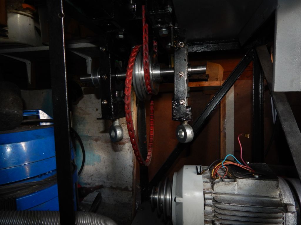

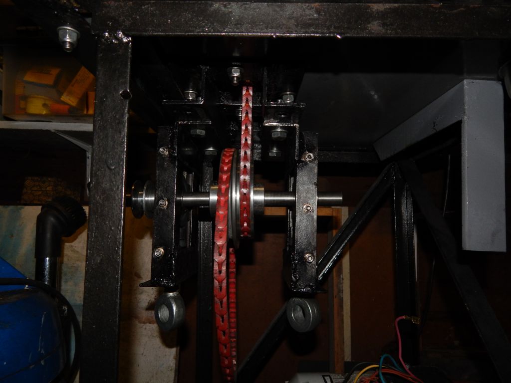

      Oh have got a bit further with the Gearbox and been able to bolt it all together for the first time and attach the pulleys and the motor on is new plate to see if it will all work together. It looks promising and much better this way around. I had to use a three pronged puller to get pulley back off as it would not come off and was a bit stubborn . Armed with a video from Toby am going to work out an electrical drawing to see how reversing can be simplified.
      pined and connected top half to the lathe
      Checked new  position for motor  and that it has some clearance to rise on swing seat

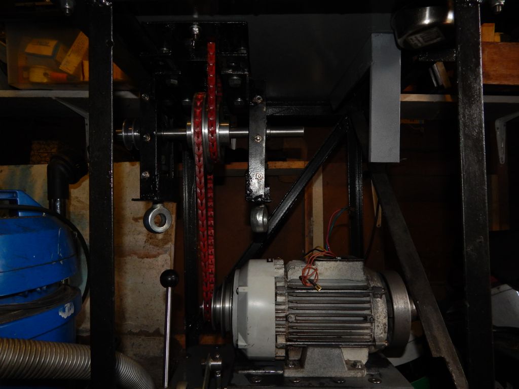

        Mounted up with belts awaiting them to stretch as they were taken apart to clean . All bolted up to see how it all sits in the bottom frame . No electrics wired back on yet still working on circuit diagram.
