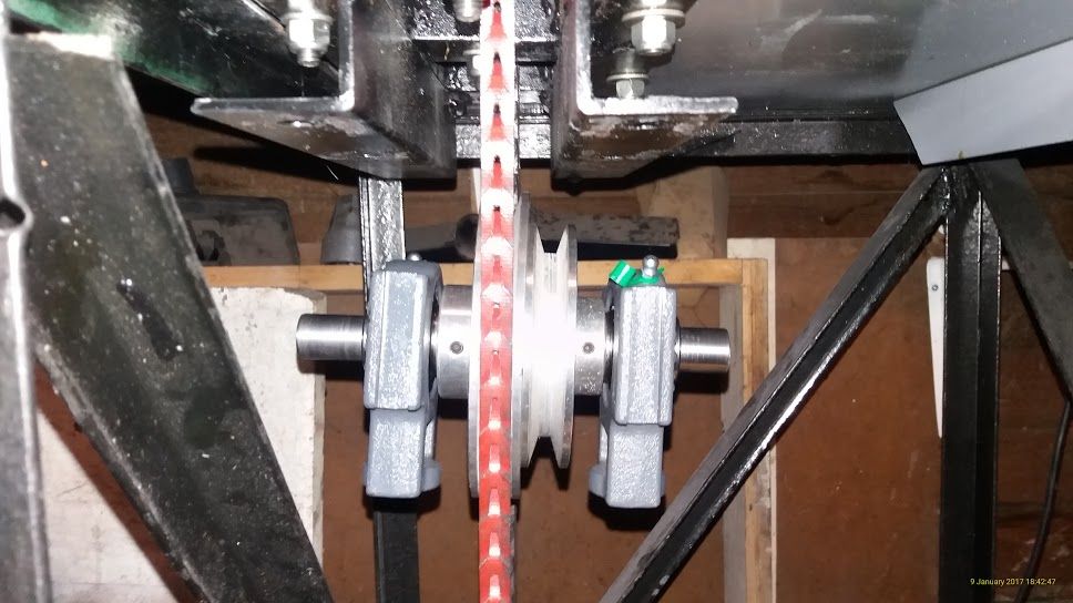

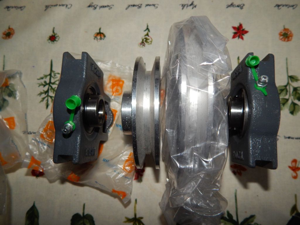

                            More parts arrived . Thanks Nick for the datasheet
                            More parts arrived

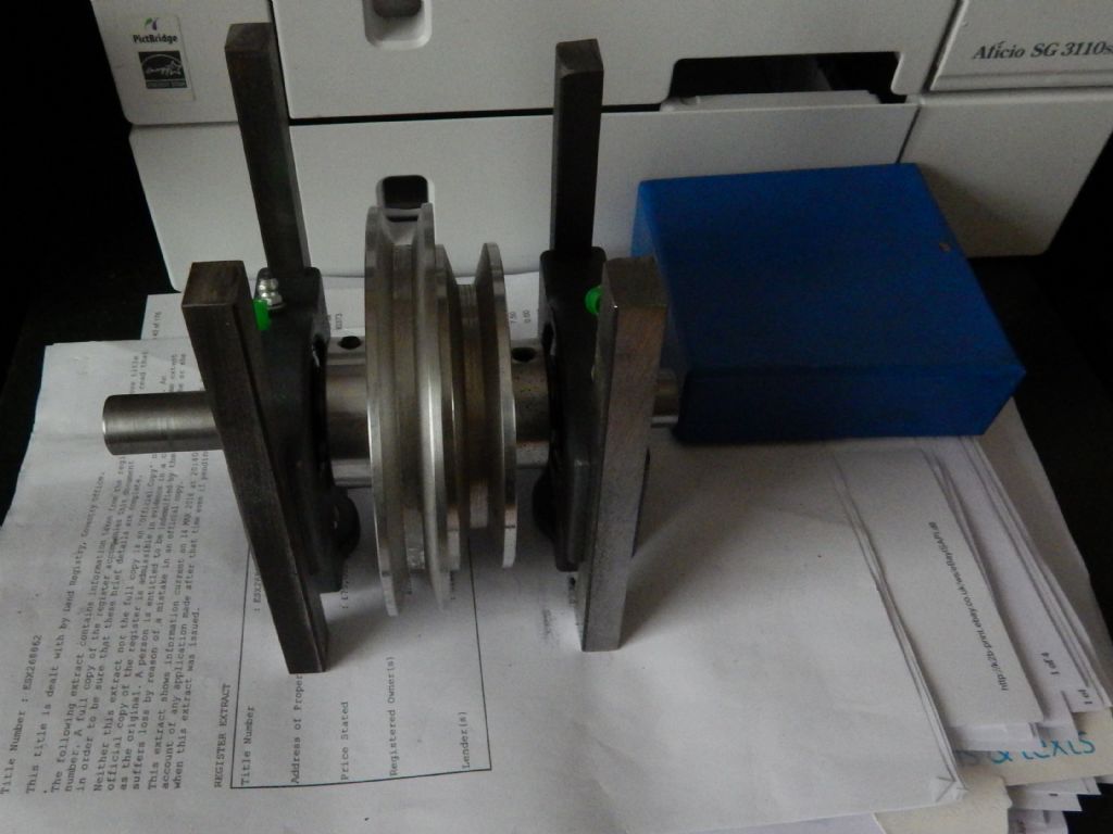

                              Managed to get my 3/4" shaft made so it was .747" to take bearings and pulleys today. Its starting to take shape I am still shoppig for 1m of 15mm x15mm for tracks to run this onstart of high speed gearbox

                                    First try at rough placement
                                    first try for space

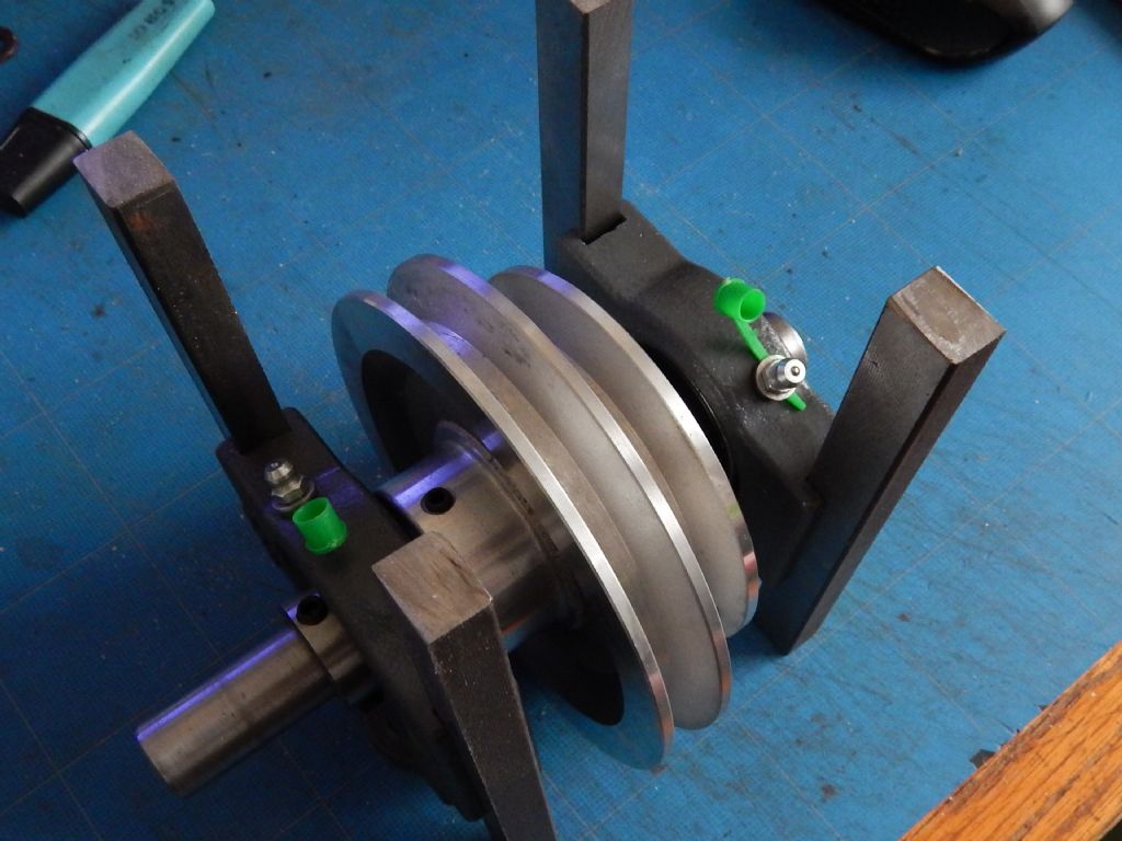

                                      Got a bit further
                                      finished runners
                                      just need to drill runners now

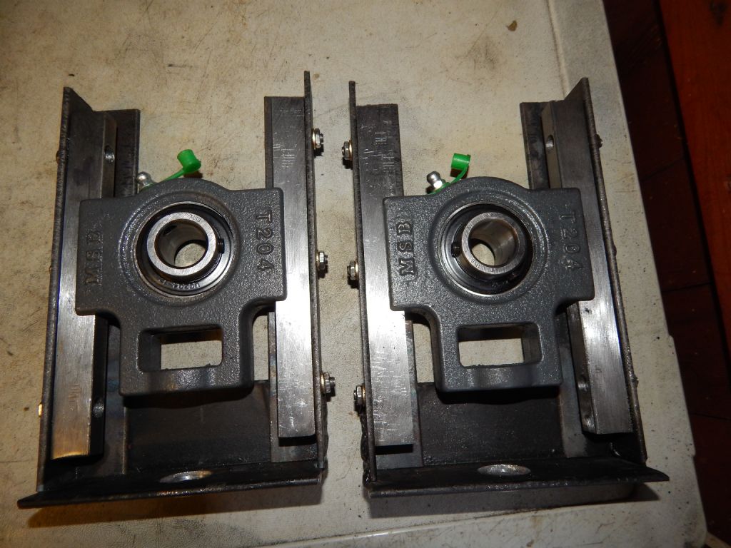

                                      #282915
                                      Martin Newbold
                                        @martinnewbold

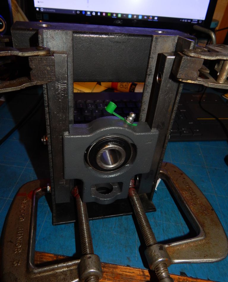

                                        Well i drilled bars and re-ground one which was sticking
                                        #284448
                                        Martin Newbold
                                          @martinnewbold
                                          Well I had to buy new angle as the B&Q angle iron lol now mild steel was not regular or a right angle inside and out. This mean all the work i had done was rubbish. I have purchased proper angle from a wholesale stock dealer and have got back to were i was . I have decided to use 3/4 gate eyes for the winding mechanism and have some on order . I still have to drill top plate for old mounting bearing holes and have a dry run with it cramped up before both are welded.
                                          I had to remake the slide holders due to inferior angle from B&Q
                                          #284461

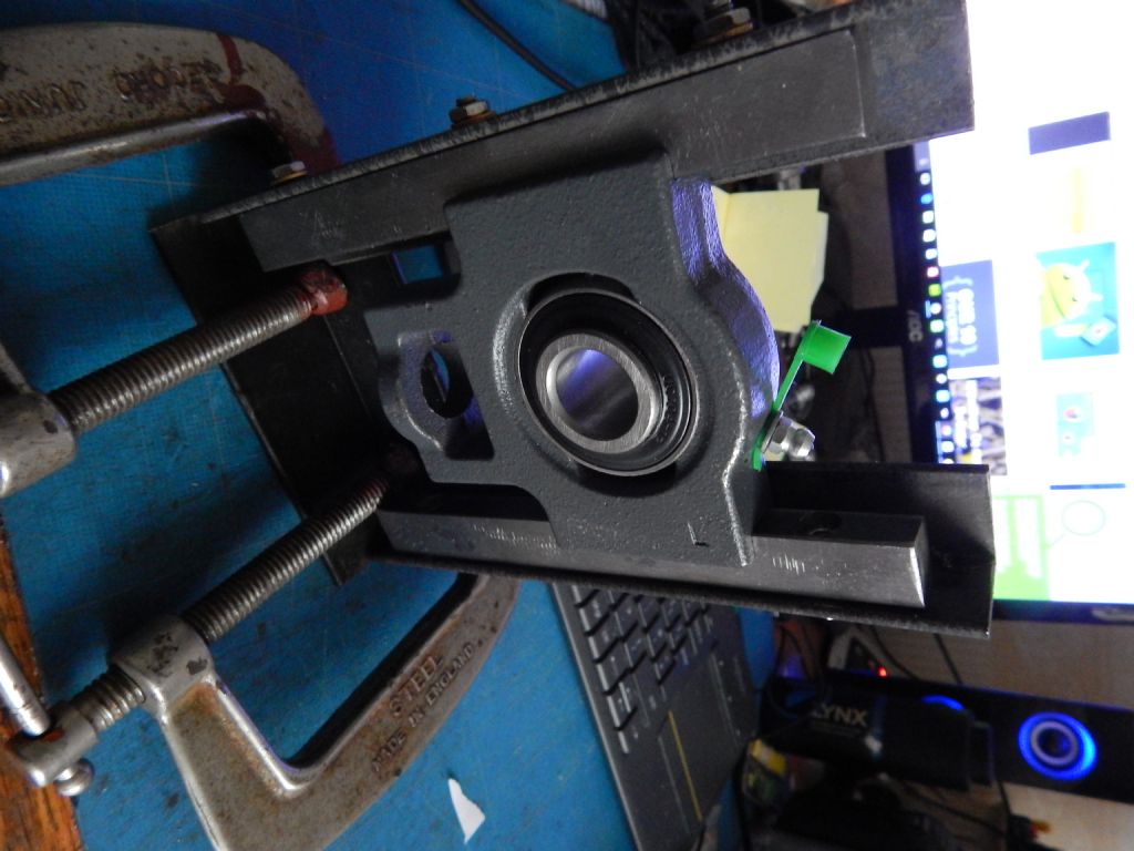

                                          Martin Newbold
                                            @martinnewbold
                                            I made the securing pieces to bolt under top and roughly cramped together to see if it all slides .

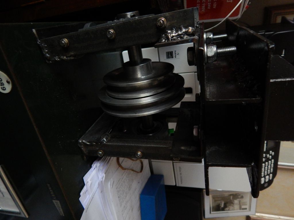

                                                  Martin Newbold
                                                    @martinnewbold
                                                    Lol the profile was not good at all but ok for simple jobs have fabricated out of proper right angle and have it working in rough mock up pending new rod. The B&Q steel not iron was thicker at ends and narrow in centre the items I had was not right angles inside or out. Perhaps they have changed this and thier new stock is different. I did not go back but brought else where.
                                                    Two welded up
                                                    First mock up
                                                    first weld up try
                                                    #284779
                                                    Martin Newbold
                                                      @martinnewbold

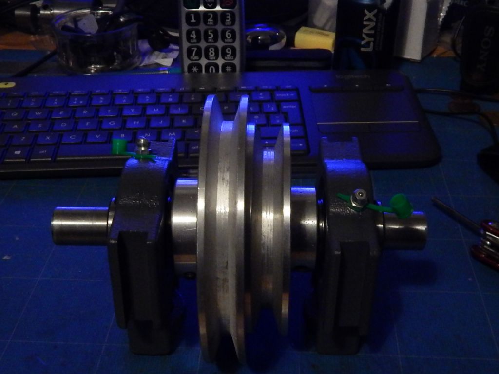

                                                      Had not cleaned up welding so the seatings were not seated properly forcing an odd angle . Much better now they have been cleaned up . My maths has been thus
                                                      n1 = 1600rpm, d1 (Drive)=25mm, d2 (Pulley drive )=130mm d3= 100mm d4 (on lathe ) =130mm
                                                      n4=(n1 *d1*d3)/(d2 * d4)
                                                      n4 = (1600 x 25 x 130)/(100 x130)
                                                      n4 = 400rpm
                                                      I just need a longer 3/4 silver steel bar around 12" long as he width is wider than my original pulley bar
