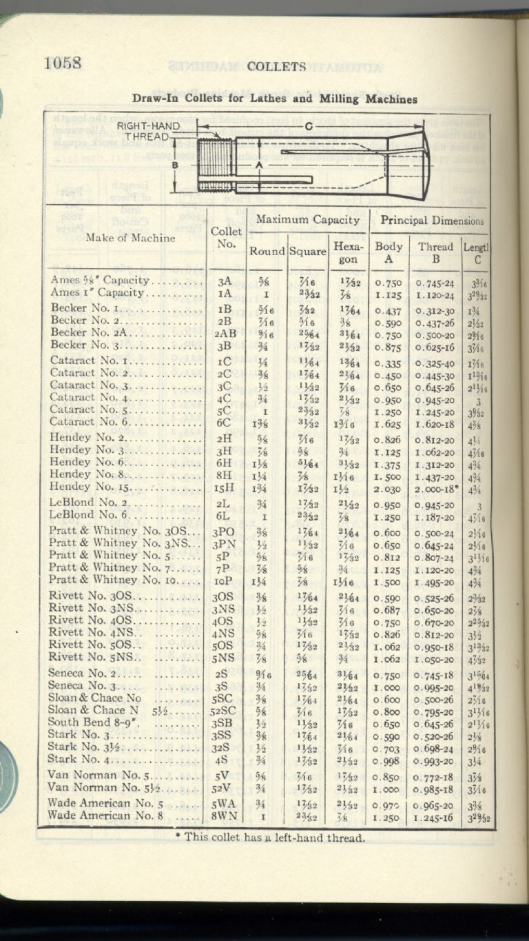

            Stark used a unique collet size. I bought some old collets thinking they were 3C, found they were not and finally identified them from the table in Machinery's Handbook 10th edn. I do not know if the tailstock is the same taper, but it could be one of the Brown and Sharpe ones – they vary by smaller increments that Morse.
            I did advertise them and got no takers – if they are of any interest send me a PM and you can have them for a charitable donation to Tools For Selfreliance.
